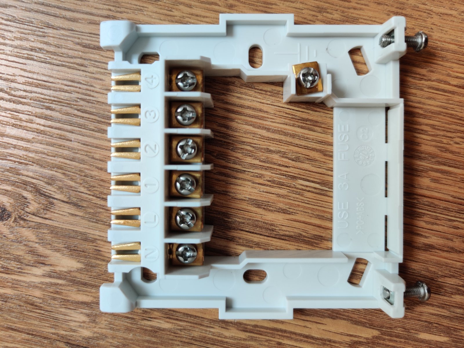

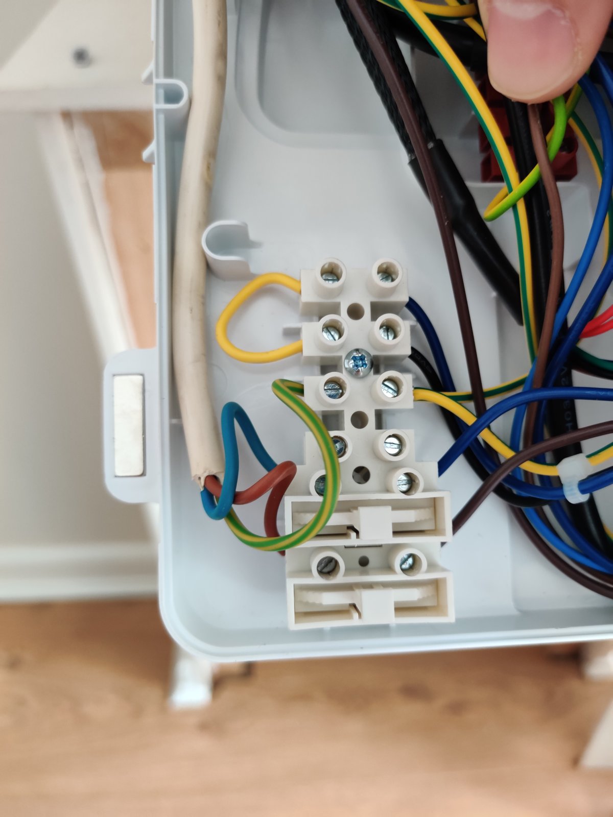

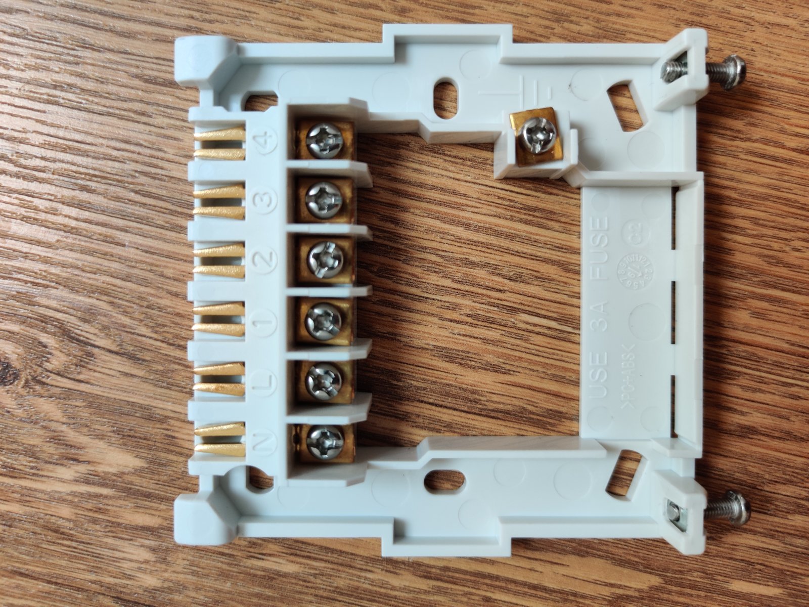

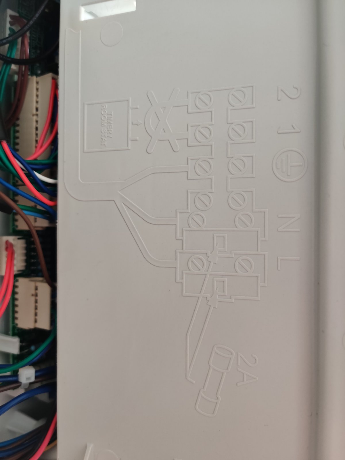

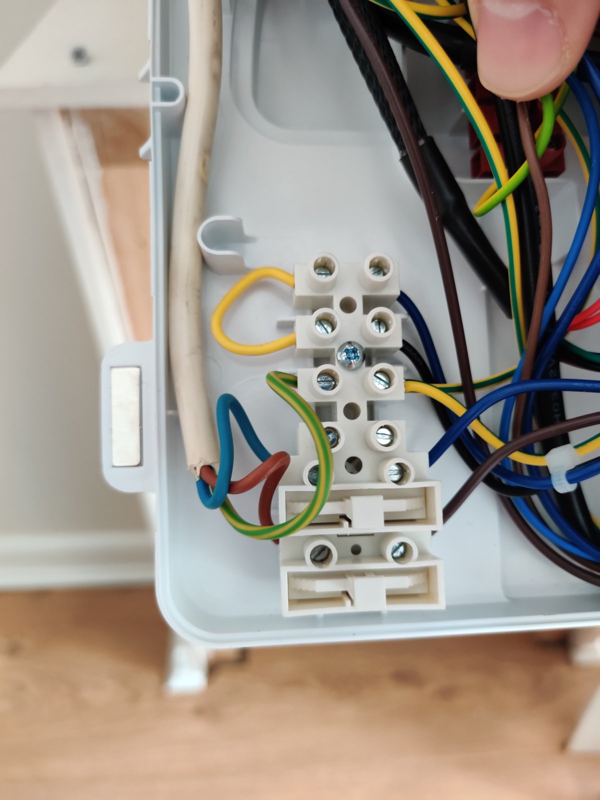

Complete novice..
Looking to wire up my hive receiver to my baxi 825 combi. School boy error in not paying someone to wire it up. With times like they are I'm not going to get anyone soon.
Any help would be greatly appreciated. Thanks.

Use single channel version of Hive.
Remove yellow link and connect the vacant terminals to Hive terminals (1) and (3)
Connect Hive (N) and (L) to the boiler N & L terminals
If you have had to open up a roomsealed compartment (sorry I can't remember if you do with your model or not) to access the boiler wiring terminals, that should have only been done by an RGI (Gas Safe) who can make the necessary safety checks to ensure it is properly sealed up again afterwards. I suspect not but can't say for certain from memory.
