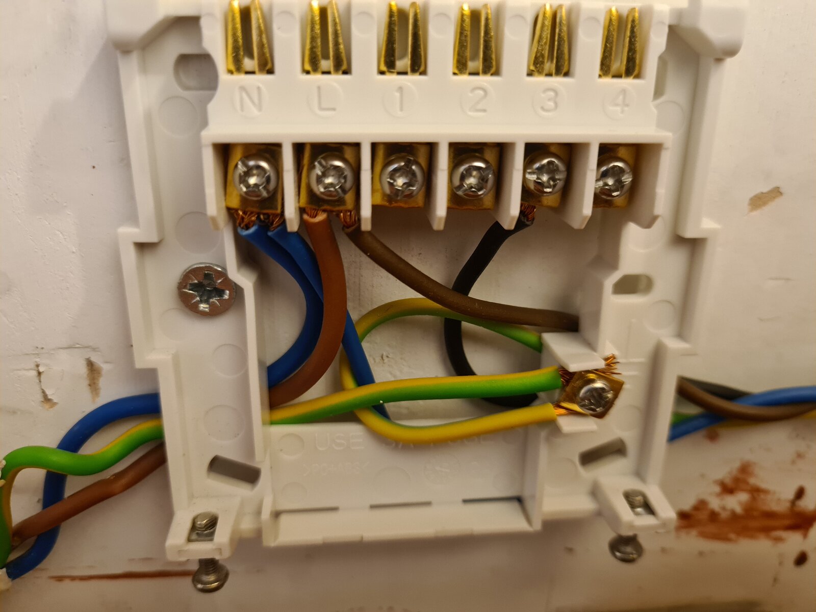

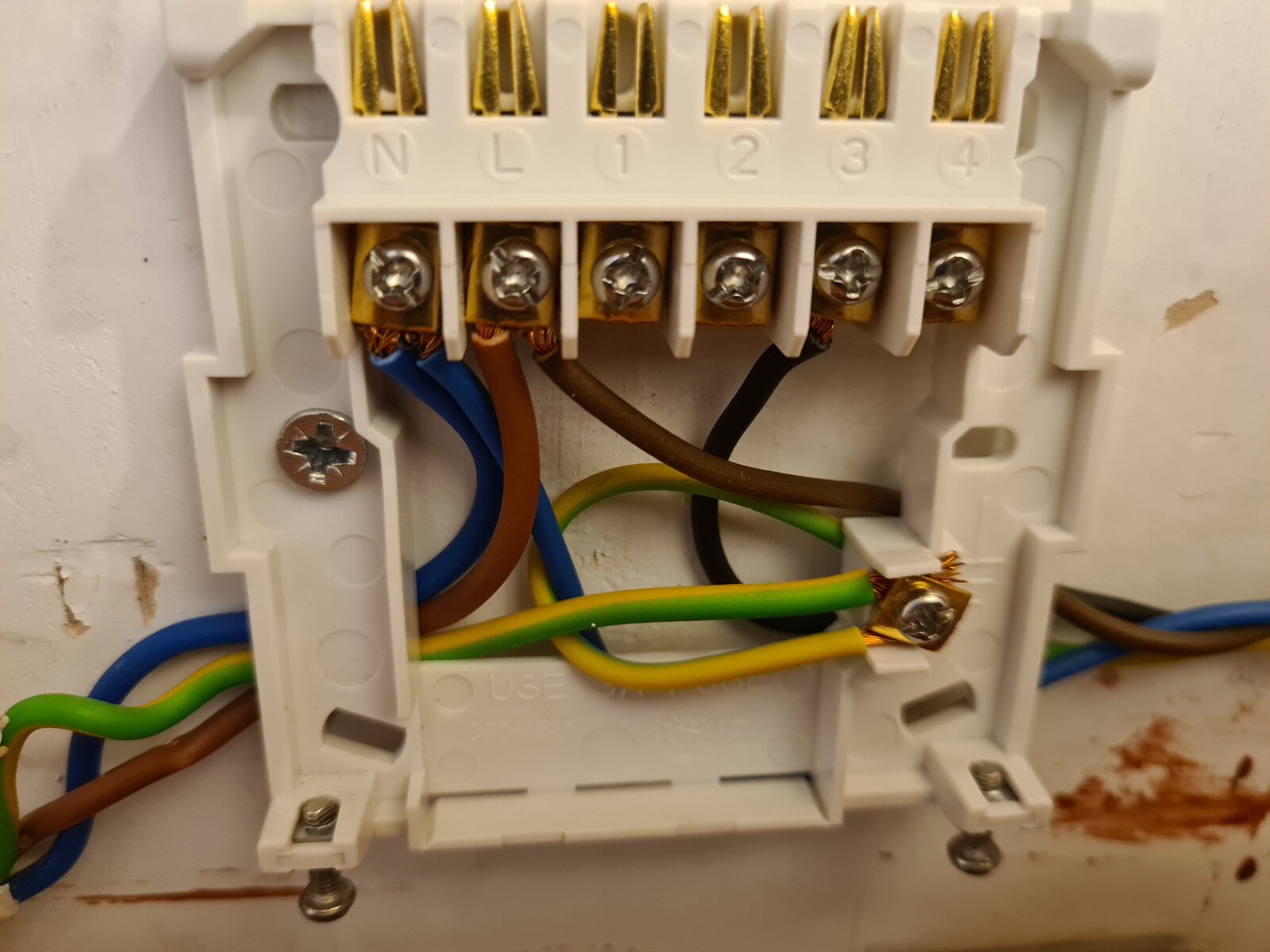

Hi CBW,
Thank you very much for your reply. I wired black wire to no 3 on hive, but still central heating not comes on. Any ideas? I attached you a picture below.
Many thanks.
Yes, because you have no wire in the Com (number 1) which I said was one of 2 of the black wires.
I have only one black wire tho? At the moment hot water working fine it's just the central heating. Sorry to be a pain.

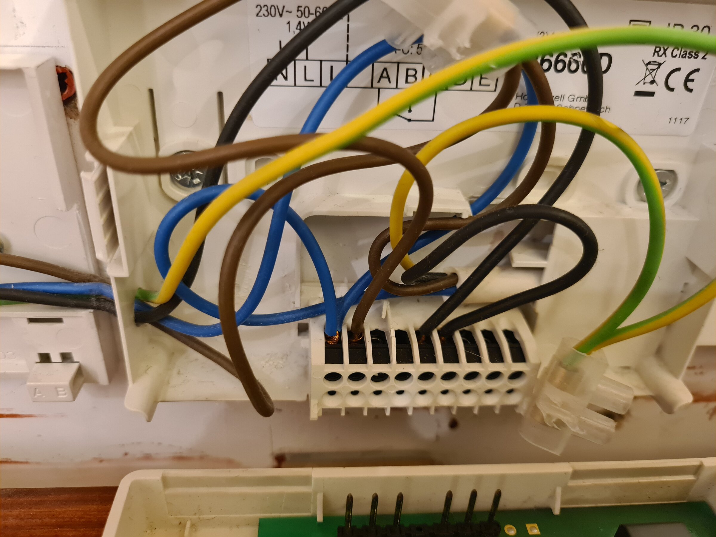

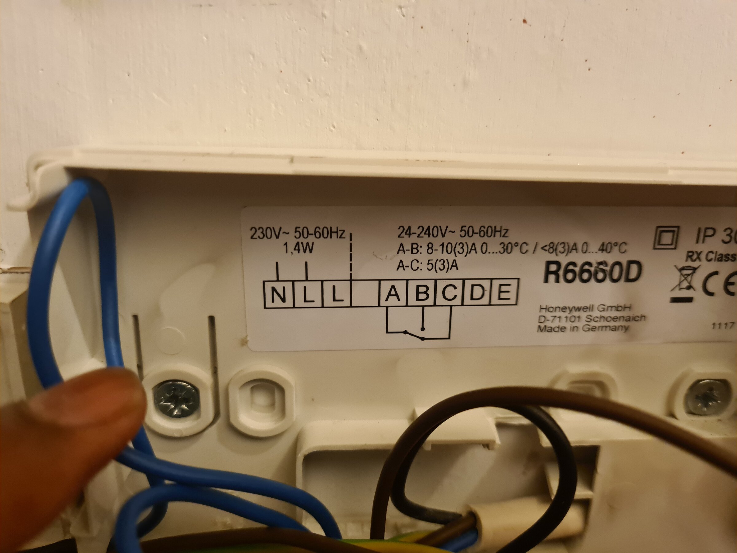

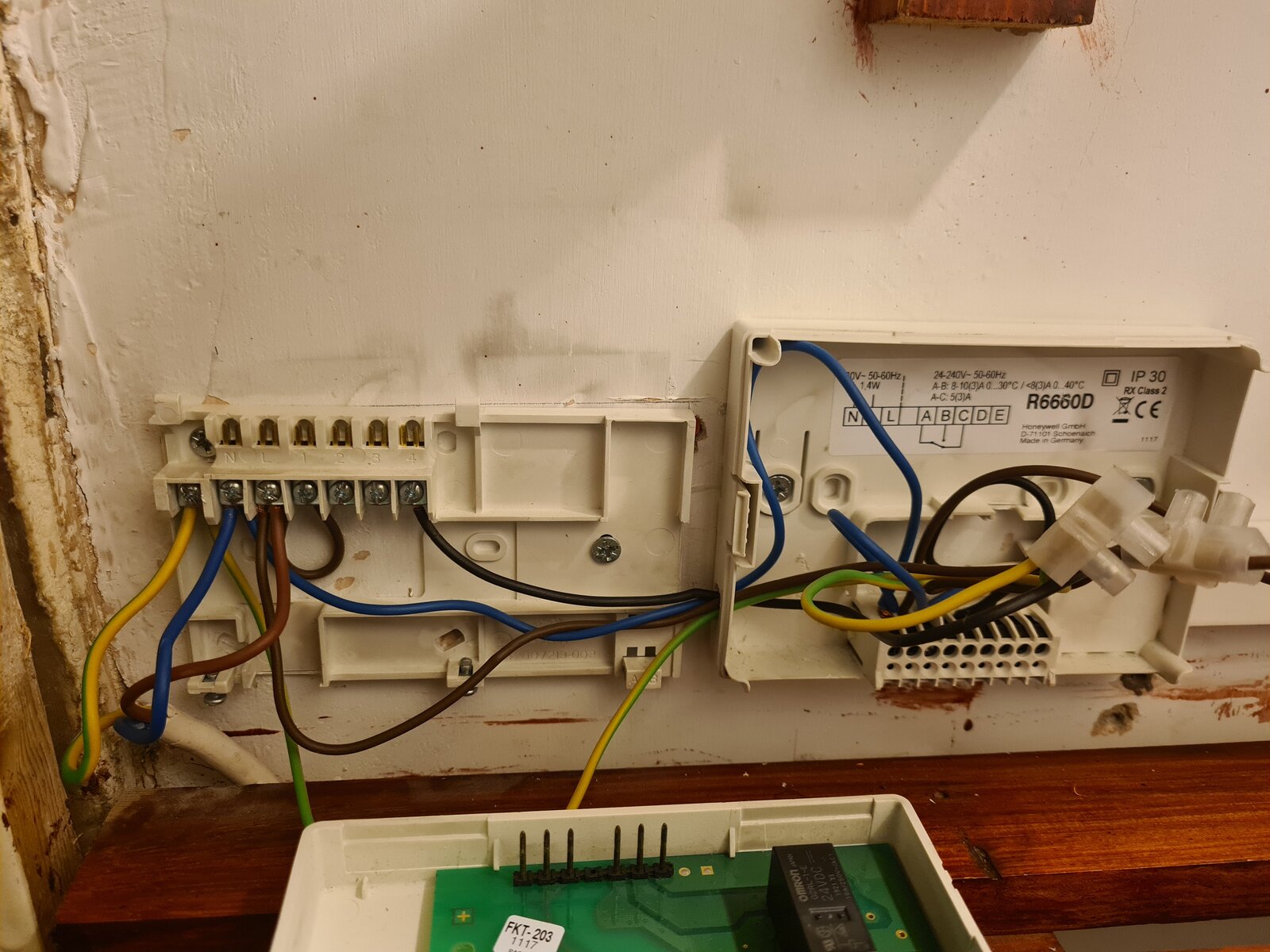

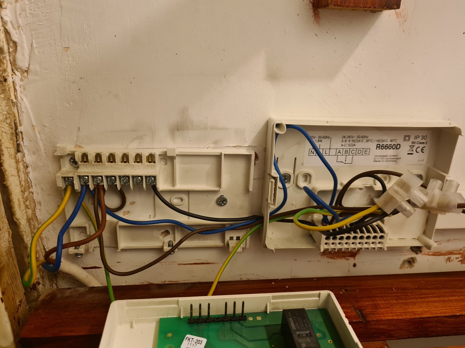

This was my old wiring from thermostat n reciever
You appear to have a black wire linked to the programmer via a brown wire and connector block, where has this gone? Have you done away with the programmer?
