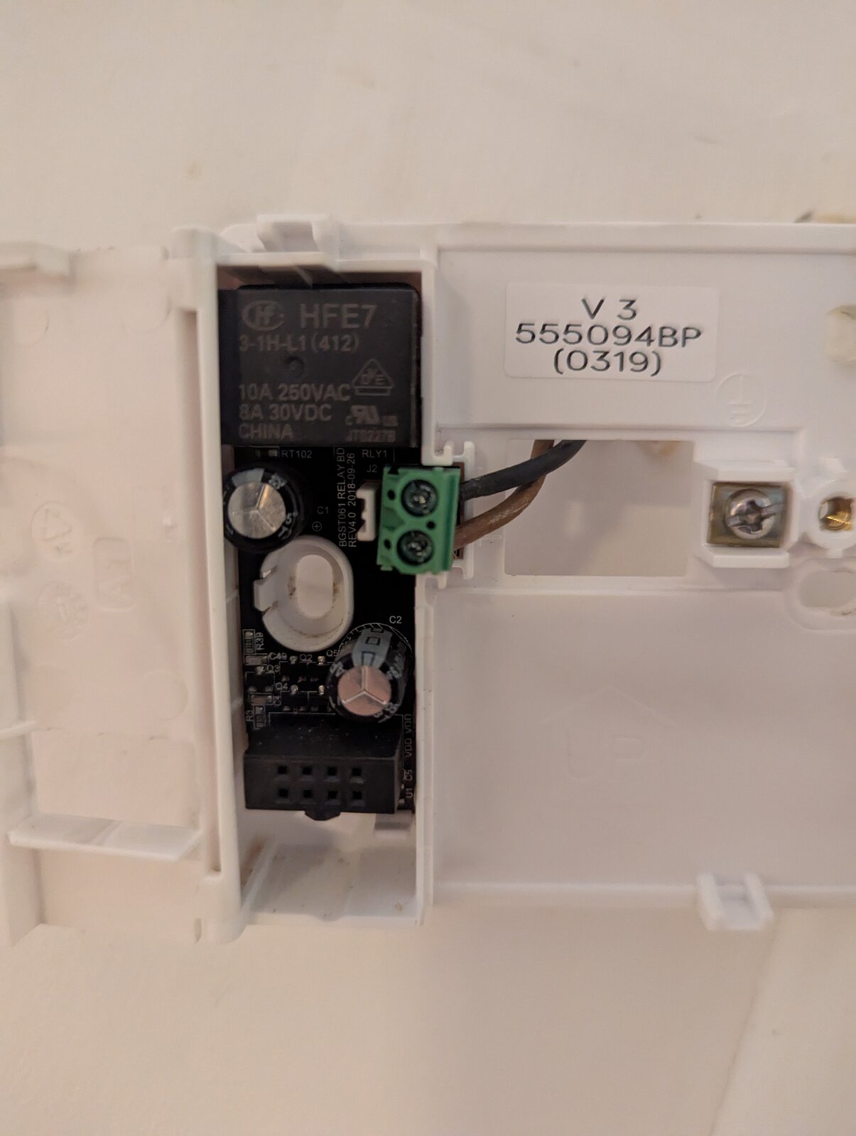

Hive thermostat playing up

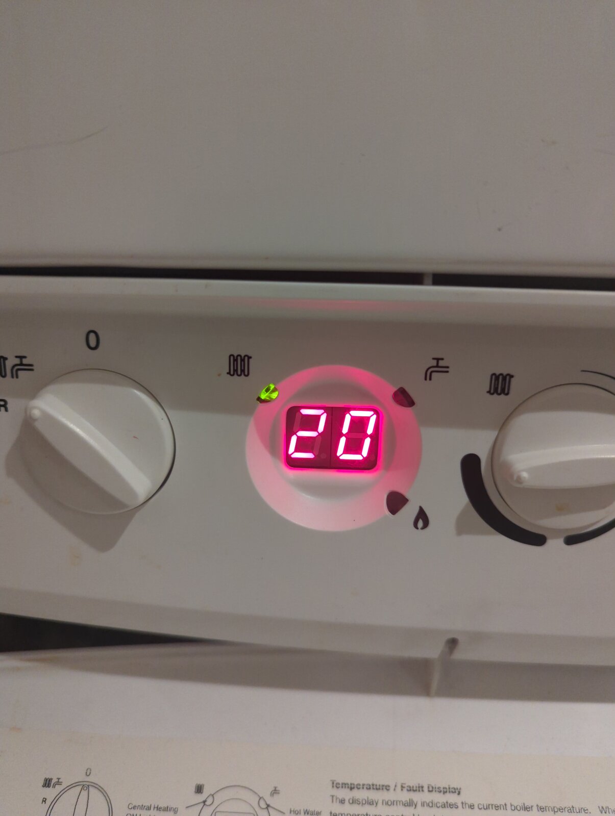

So it’s either the Hive or you may have more than 1 issue. What did the temperature reach on the front and how quickly?

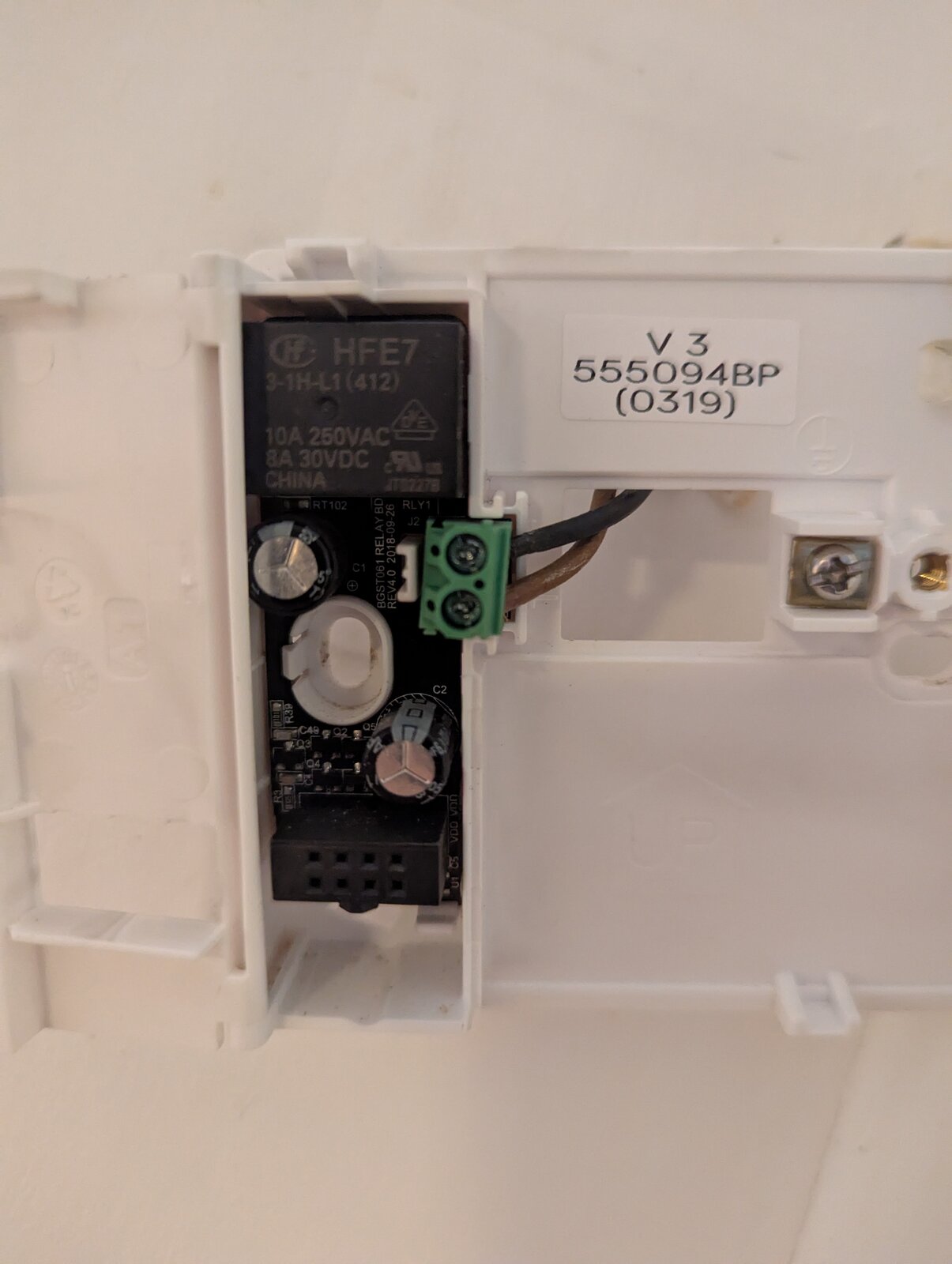

So I completely removed the hive and connected the 2 wires together. Heating fired up after a minute or 2 and I just had to put the integral timer on constant and it worked no problem. Left heating on for over an hour no issues. Must be the hive.
I'm glad it's nothing to do with the ignitor etc in the combi.

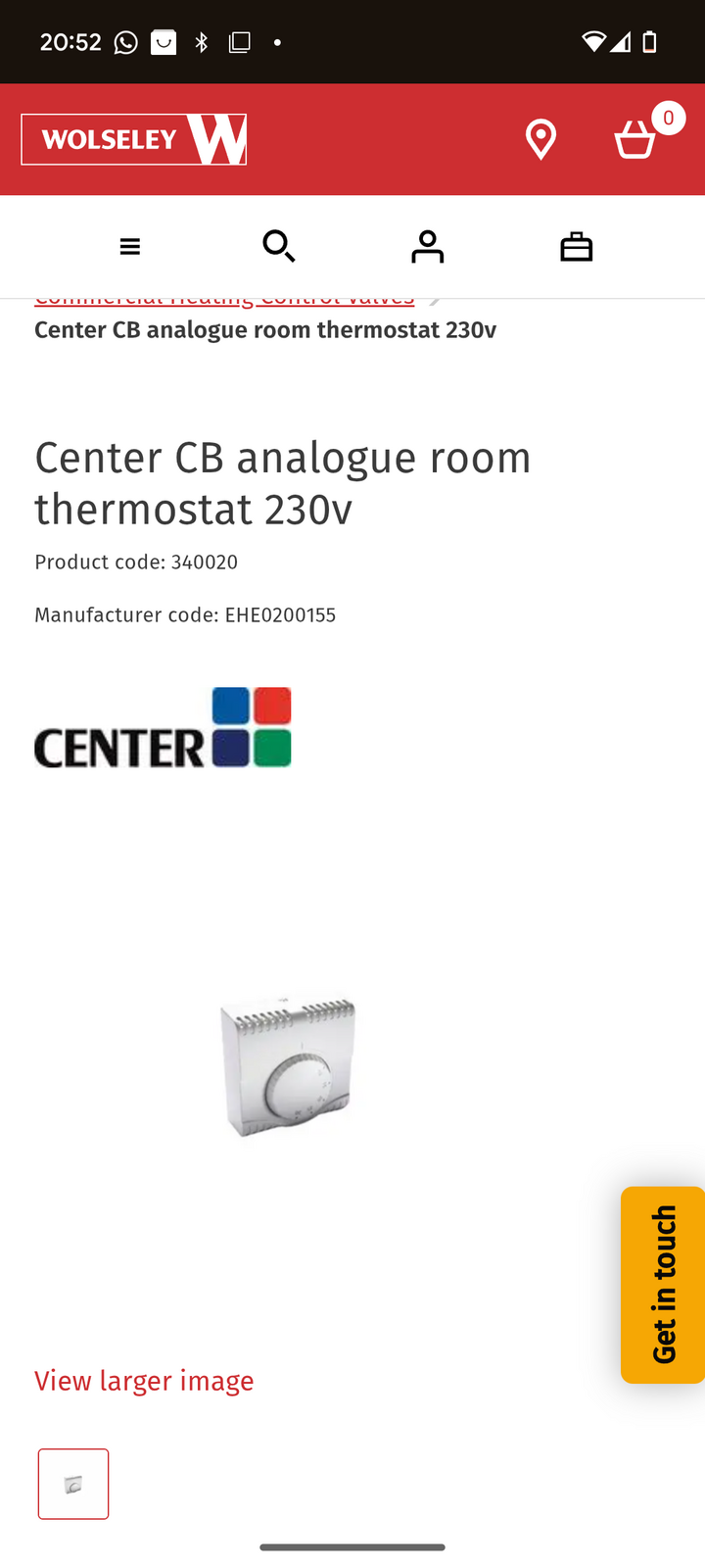

I've bought a plumb centre thermostat which I will fit tomorrow.

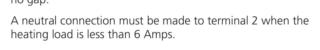

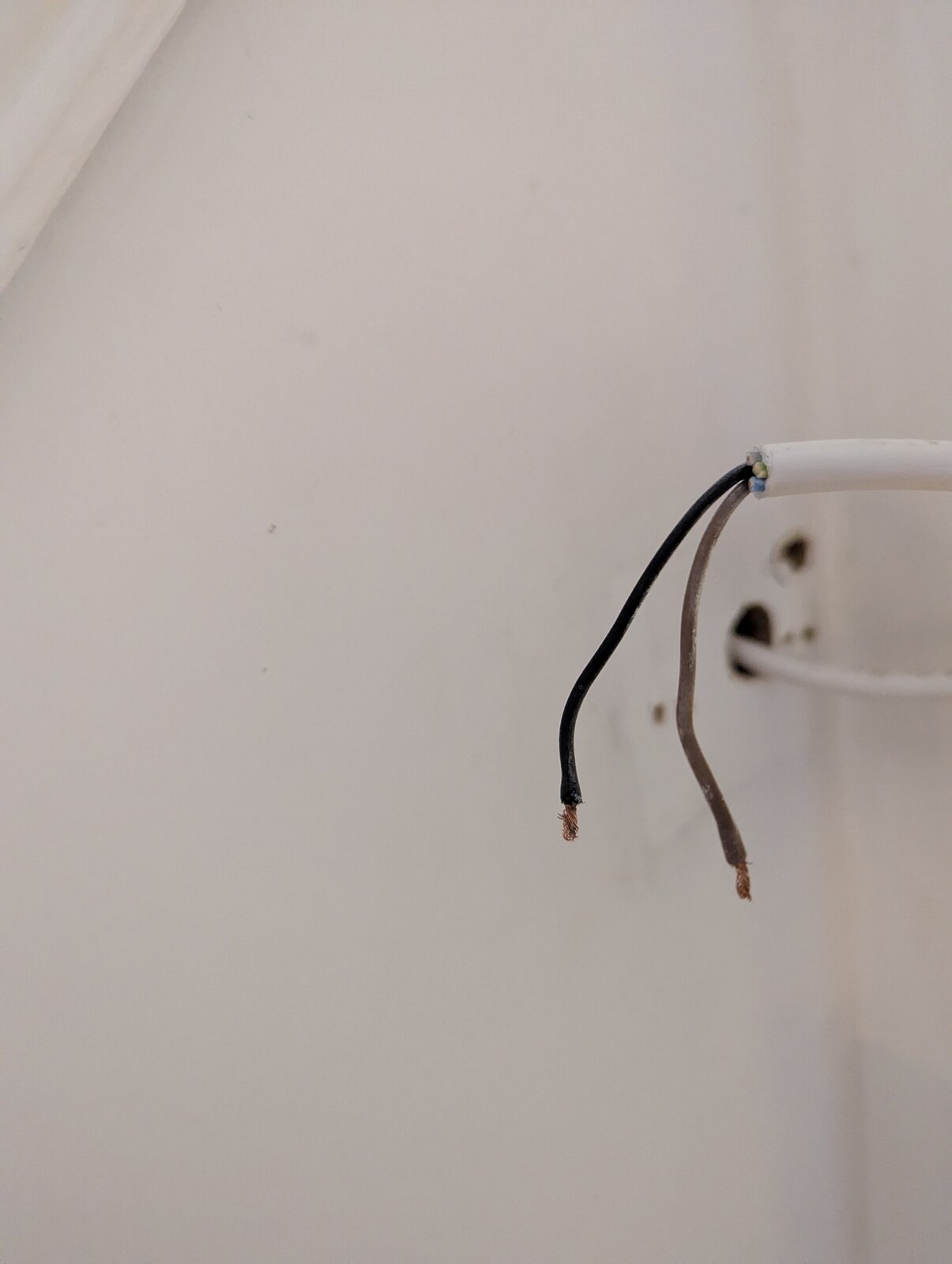

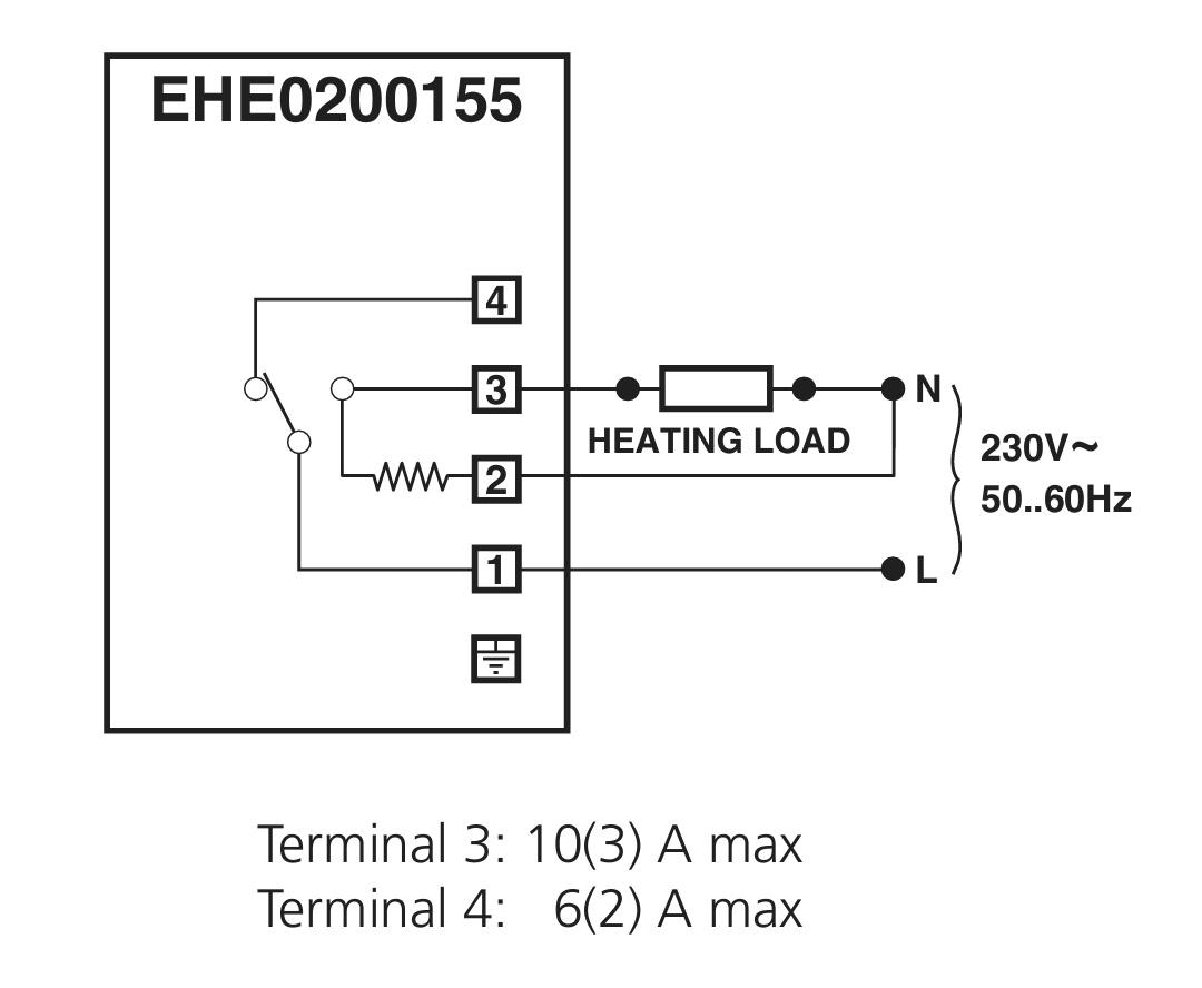

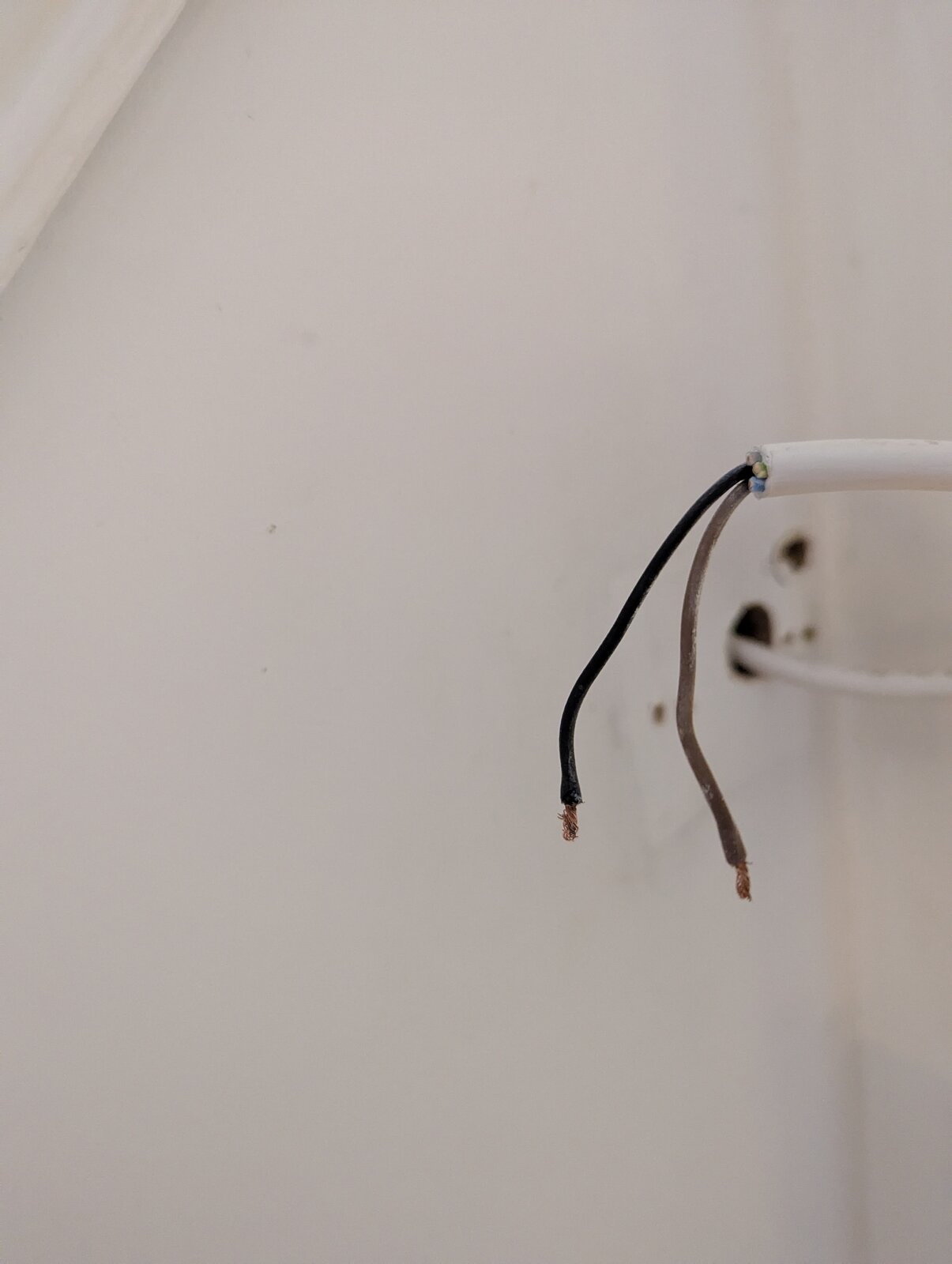

I don’t mean to throw a spanner in the works, but your PlumbCenter one is a 3 wire installation and appears you only have 2 wires. It’ll work, but will be subject to large temperature swings (known as hysteresis). If you just want a thermostat using 2 wires, better with a battery operated 2 wire type - plenty available.
I would agree, given...

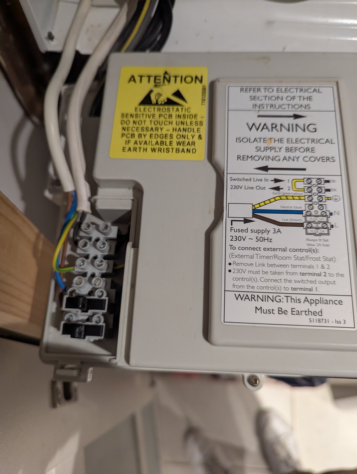

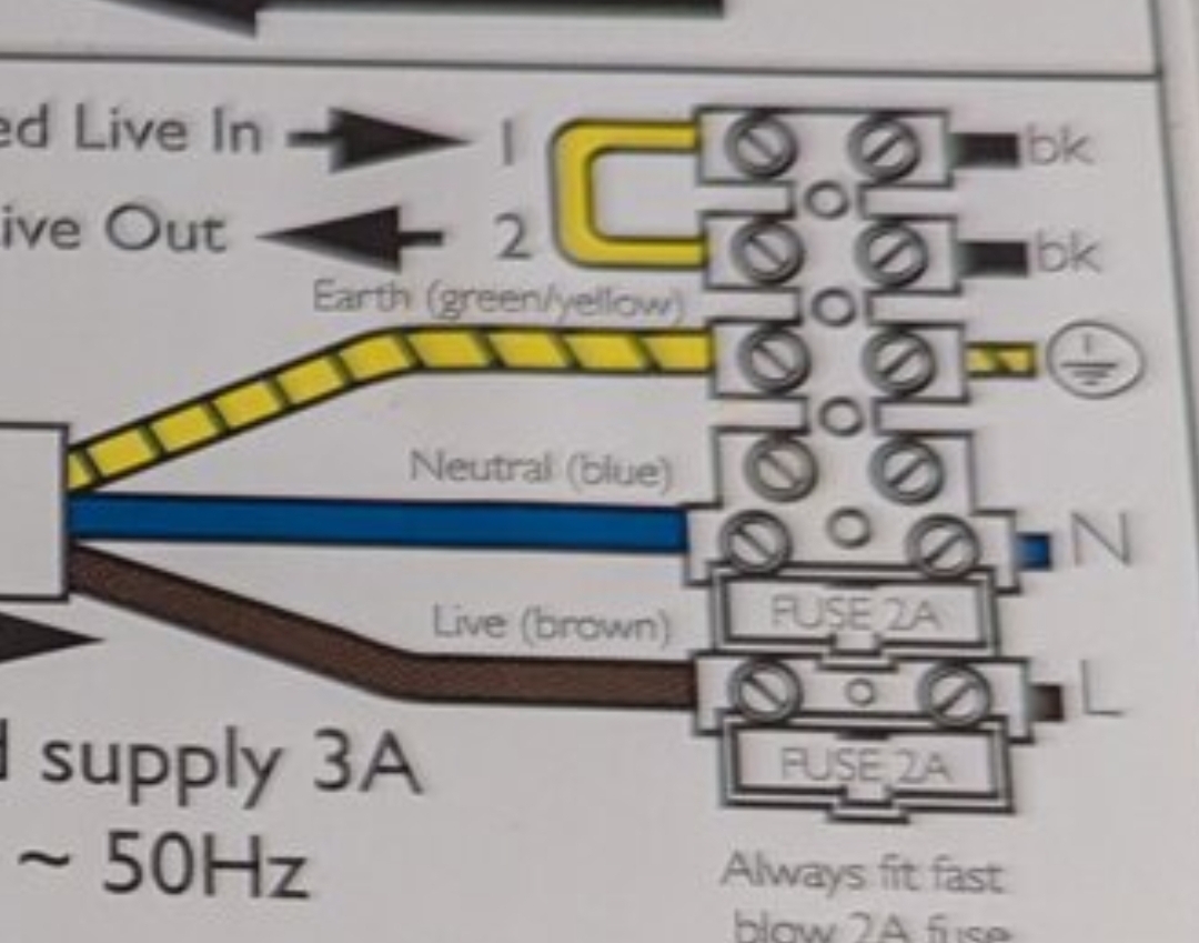

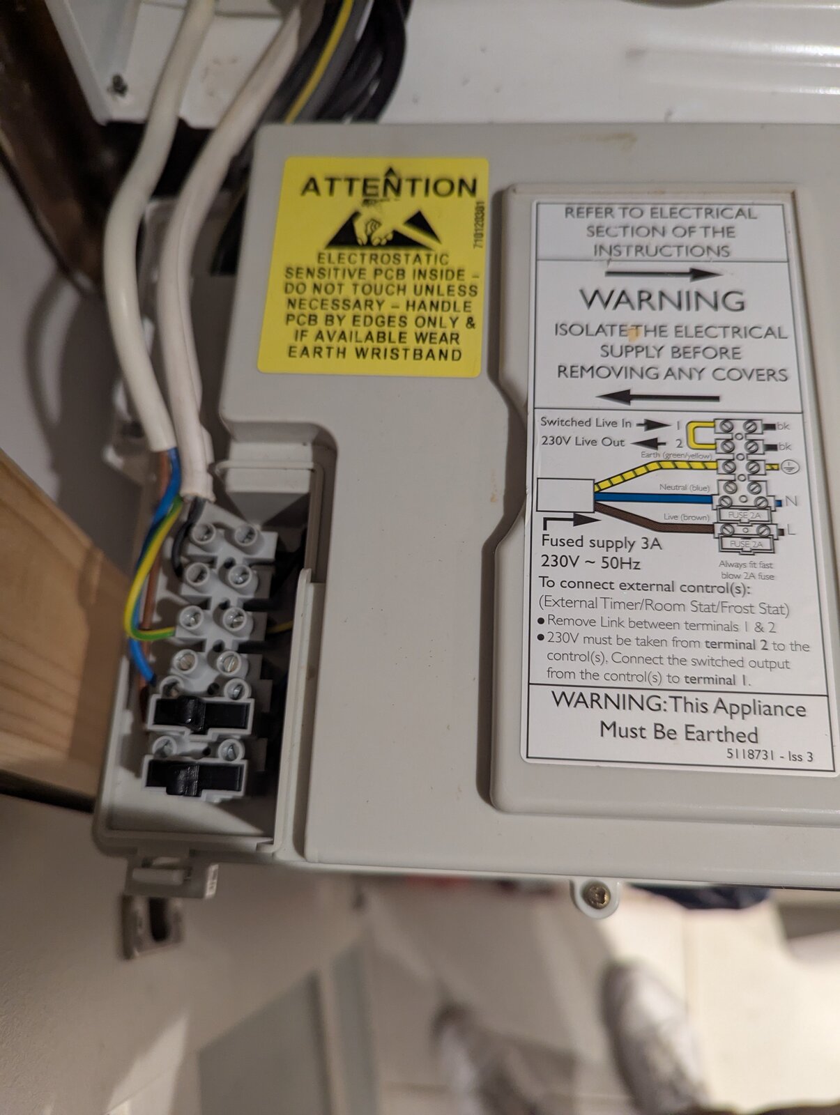

However, the flex to the thermostat is a 4 core + earth. There looks to be plenty of slack in the cable at the thermostat end. If there is some at the boiler end, the cable can be stripped back at both sides - the blue wire can be connected to N on the boiler, and to terminal 2 on the new stat.
At the boiler, it appears that the Black wire connects to terminal 2 (live out) and the Brown wire to terminal 1 (Live Return).
If that is the case, the Brown wire would connect to terminal 3 on the new stat and the Black wire to terminal 1.

Ok thanks what's the best way to link it? I don't have those u bend connector that come with boiler in the PCB

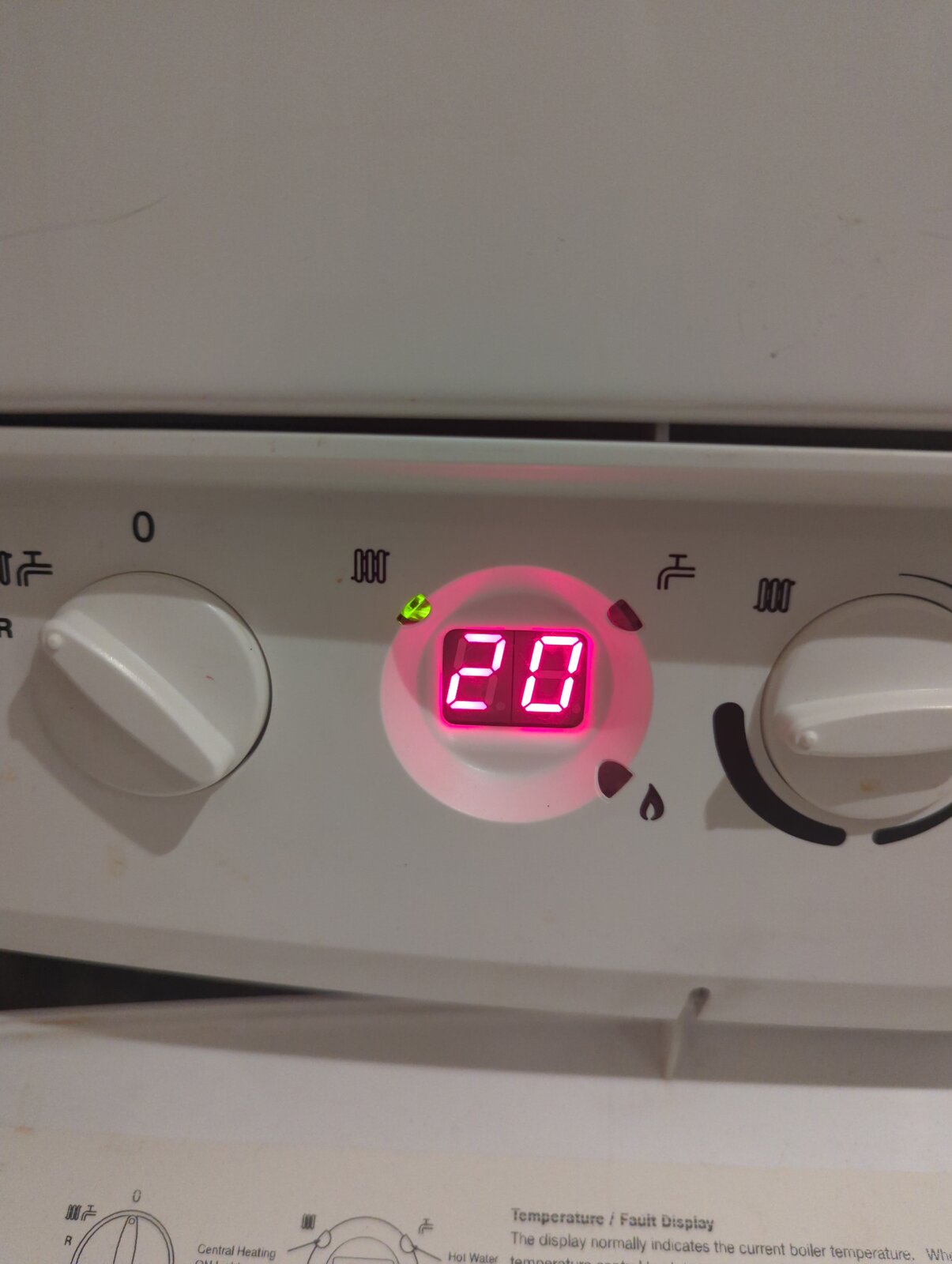

Might be better to call a boiler service guy in to attend and carry out a service on the boiler. Service would entail removing the burner ( boiler is 8 years old and I am assuming this is outstanding). Check the electrode gaps and clearances conform, clean burner and clean / flush the coils. Clean the condensate trap and pressurise the expansion vessel. Gas rate the boiler and flue gases be analysed for 8.4/ 8.7% co2 readings.
Ask him to look at the programmer too
I believe they are simply referencing the yellow wire link that would have originally been in place on the wiring terminals....

Although a boiler service is a good idea, if the boiler fires reliably with terminals one and two bridged out, and the integrated timer set to 'cont', that strongly suggests an external control issue.

Poster is saying he does not have the U link. A thinking person would get a piece of wire and create a link
