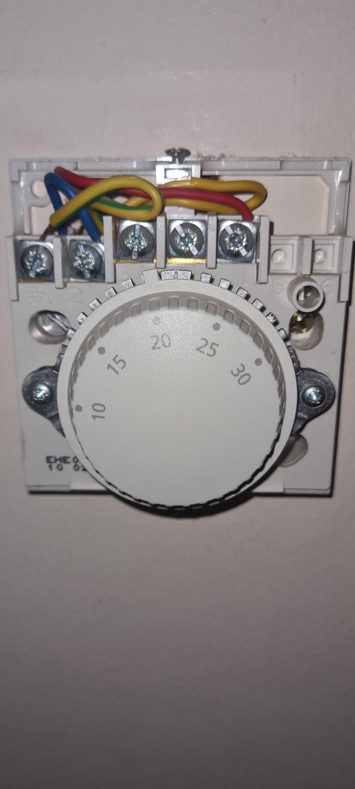

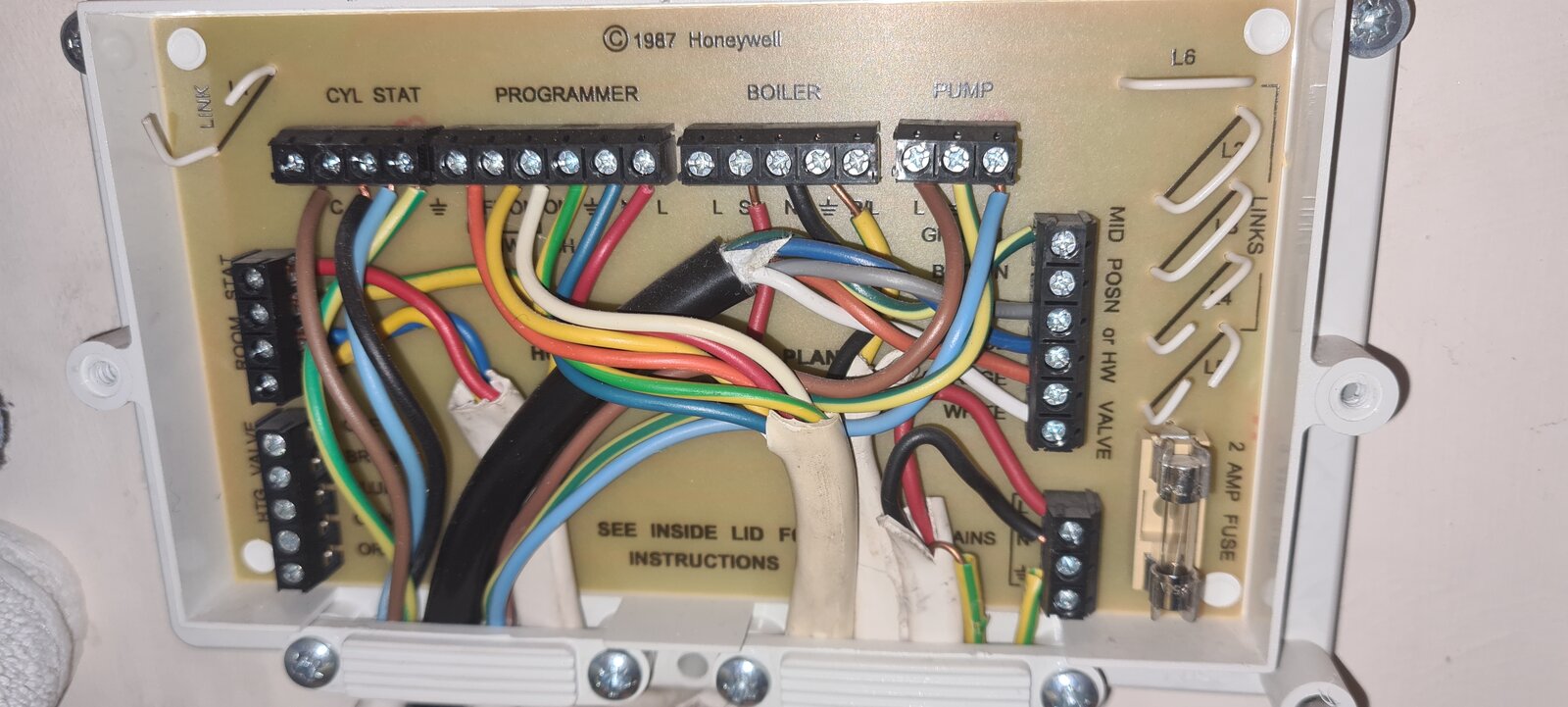

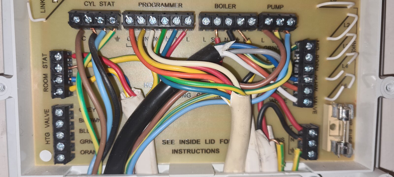

Here you go:
This is for controlling the heating and hot water via the hive. With your current setup, your thermostat calls for heat but the hot water timings will be done via your programmer. If you want to have that control via the hive, it's going to be a little bit more complicated and we'll need the wiring of the programmer as well.
