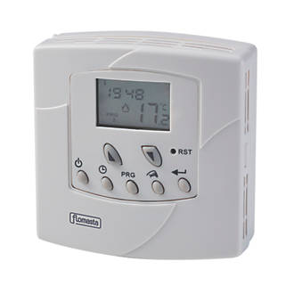

EM...............you've clearly got a massive brain....can I buy some of it from ya?.........sadly, mine aint! I have a 1yr old condensing combi, my existing progstat is too difficult to program for my small brain PLUS it don't have a boost (switch on for an hour) button, the hive looks simpler AND that all important boost button is on it

post a pic of your existing thermostat and I will guide you to a straight swap for something simple with a boost function, to buy a hive to do what you want is an expensive way to solve the problem
