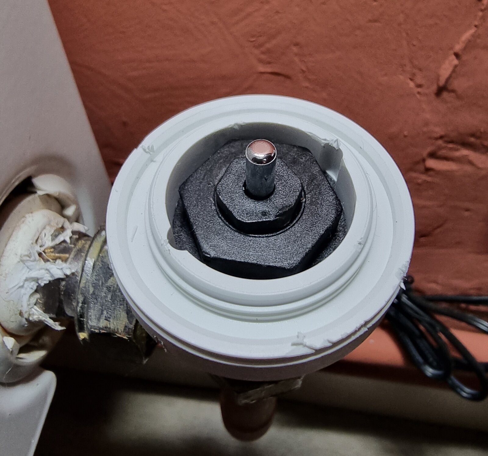

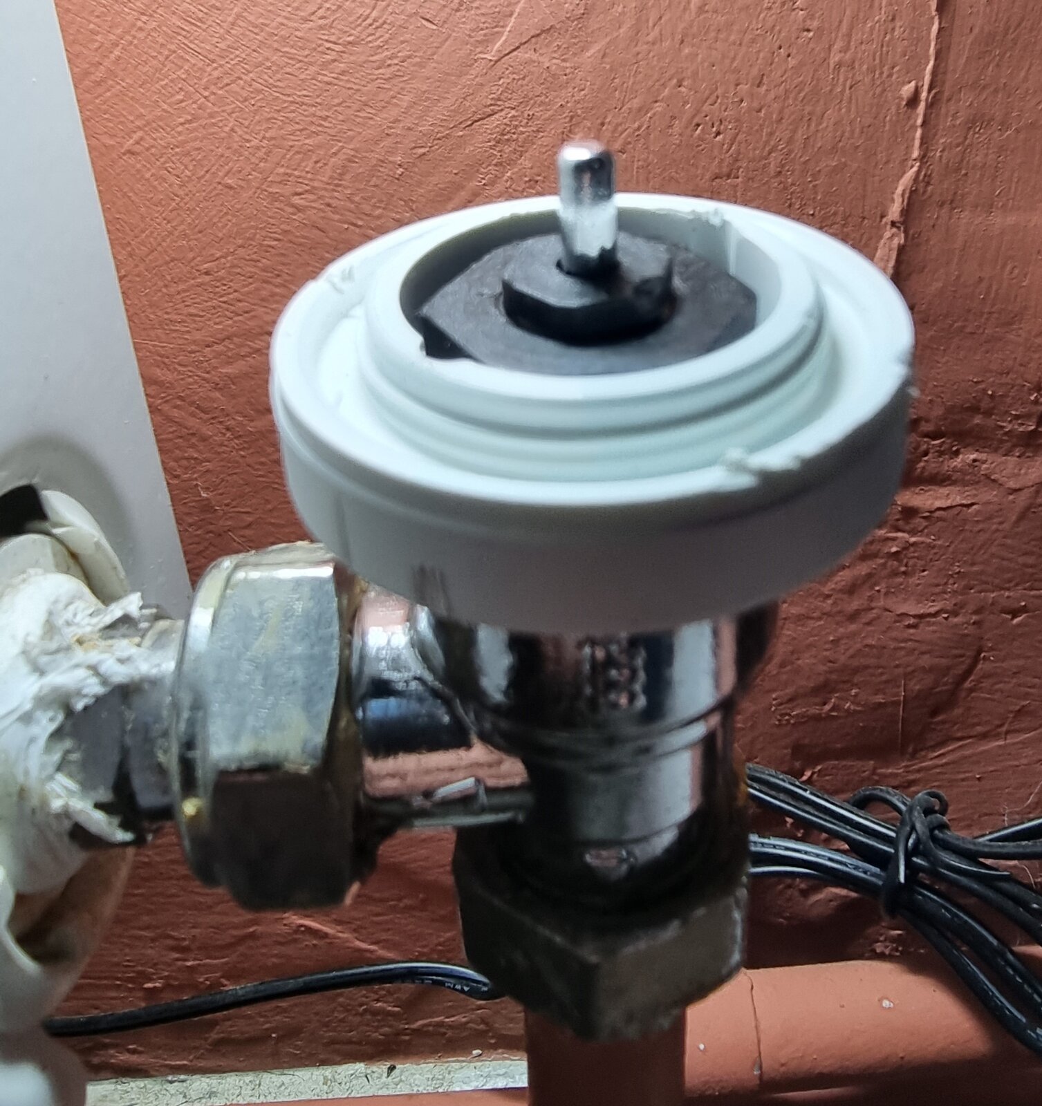

Hi this is the issue, I can't take the M30 attachment off without water leaking, when I try to unscrew it the black valve inside also turns and water starts leaking out.
I managed to get the adapter off using a dremel to carefully cut it off, and this is what the Valve looks like
Of course when I try to unscrew the M30 adapter it also unscrews the valve cartridge causing water to leak out.
any ideas tips?
nothing to do with the hive TRV you need to change the actuall TRV body
