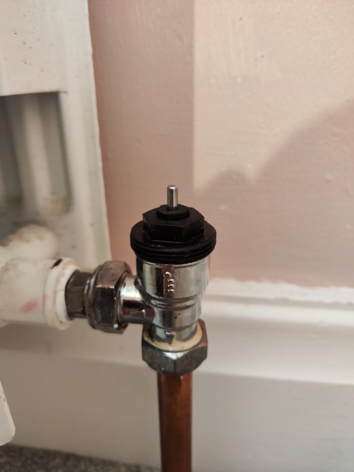

I had an issue with a smart tado smart TRV so I was going to switch it for a regular TRV whilst I sorted the issue with the tado.
Anyway when I started unscrewing the TRV water started leaking and the more I unscrewed the more water. I didn't take it all the way off because it was a lot of water coming out. When I screwed the TRV back on leak completely stopped. I've tried googling and searching but can't seem to find why it is doing this. It was fine when I initially swapped from traditional TRV to tado smart one. None of my other TRV act this way.
Does anyone have an idea what is going on?

A TRV is a sensor that pushes a pin in, nothing else, what you are saying is impossible , show a pic of what you are removing
Some TRV valve bodies have an hex nut on them that unscrews, if the tado TRV slots onto the hex nut then in theory it could unscrew if the OP isn’t removing the TRV correctly and the hex nut is lose.
I'm going to swap the valve over tomorrow so I'll take some pictures. What was happening seemed impossible to me also. I unscrewed a TRV in a different room which came off fine to reveal the pin and hex underneath but this one leaks water as soon as I unscrew it. I've checked everyday and kept paper towels around the valve and there is no leakage when it is screwed down.

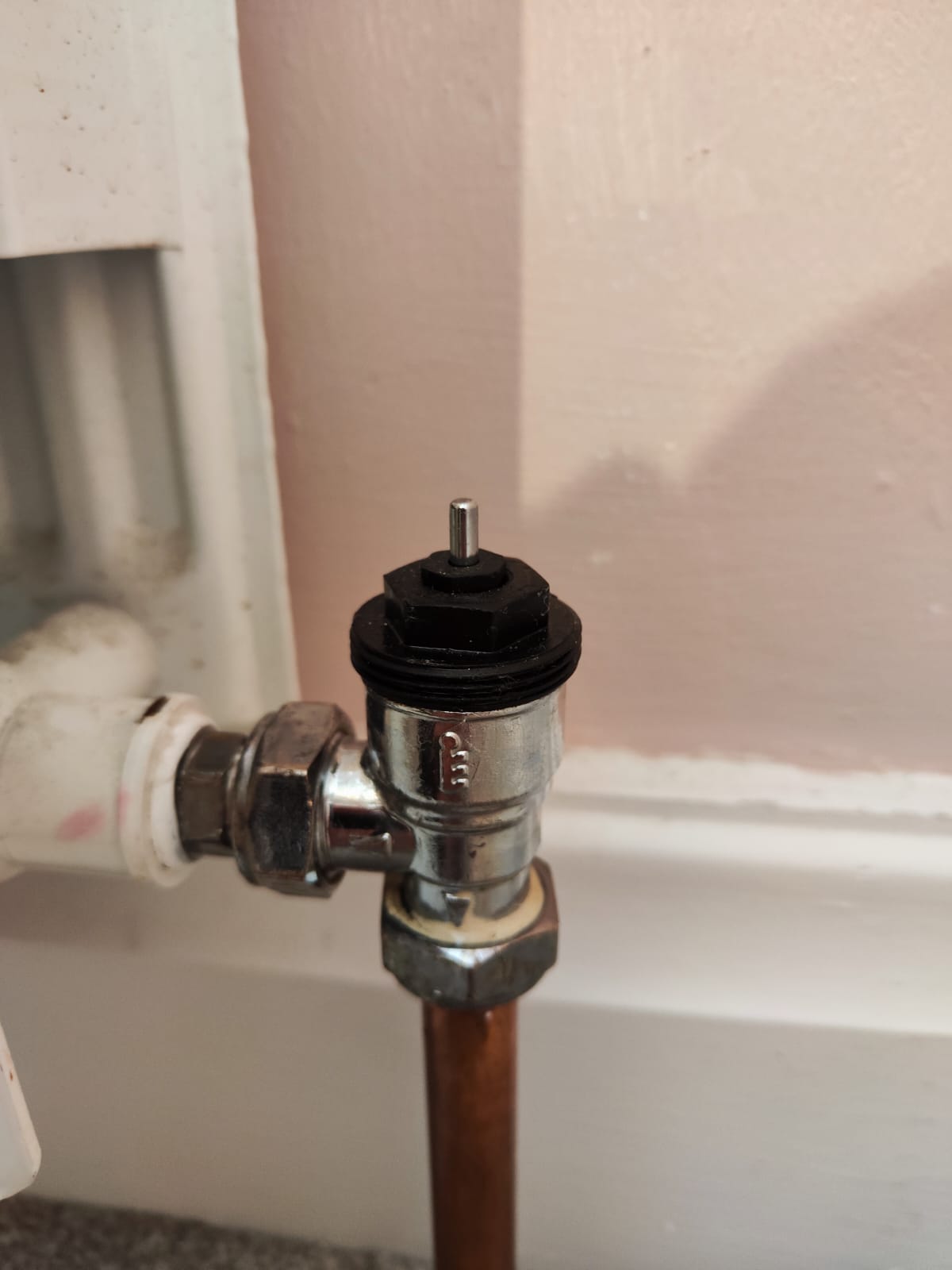

Thanks for your help people. I went and bought new valve ready to fit but when I went to take the TRV off for picture purposes to show the leak it came off no problems. (I had sprayed it with some wd40 a few days prior)
I can see what the problem is now though. The hex nut and the part the TRV screws onto are one piece and made of plastic so the metal from the TRV must have been digging into the plastic and unscrewing both when I was just trying to unscrew the TRV.
I can see what the problem is now though. The hex nut and the part the TRV screws onto are one piece and made of plastic so the metal from the TRV must have been digging into the plastic and unscrewing both when I was just trying to unscrew the TRV. View attachment 270136
That’s what I thought, you were turning the TRV body when you only need to turn the TRV retaining clamp.
