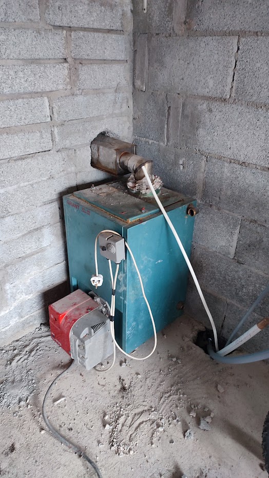

Hi,
I have moved my oil boiler out to the garage and removed the old thermostat and timer in the house completely. I have electric in the garage but not sure how to connect hive mini thermostat to the boiler.
Currently there is a socket for boiler and separate socket for pump - any help appreciated!

If I had to guess, I suspect that you may have a system that is plumbed in a way such that the boiler operates alone to heat just hot water, and then when central heating is required the pump comes on as well. With this set up it's not possible to have the heating on, without the hot water being on at the same time. Can you confirm that?
It is unusual to have a boiler with external controls (programmers & thermostats) and have the boiler and pump fitted with plugs :unsure: . But again if I had to guess I would imagine that originally the there were a couple of sockets wired to the external controls that the pump and boiler were plugged into. Can you confirm that? Presently, provided that it's safe to try, do the boiler and pump work when plugged in to the mains?

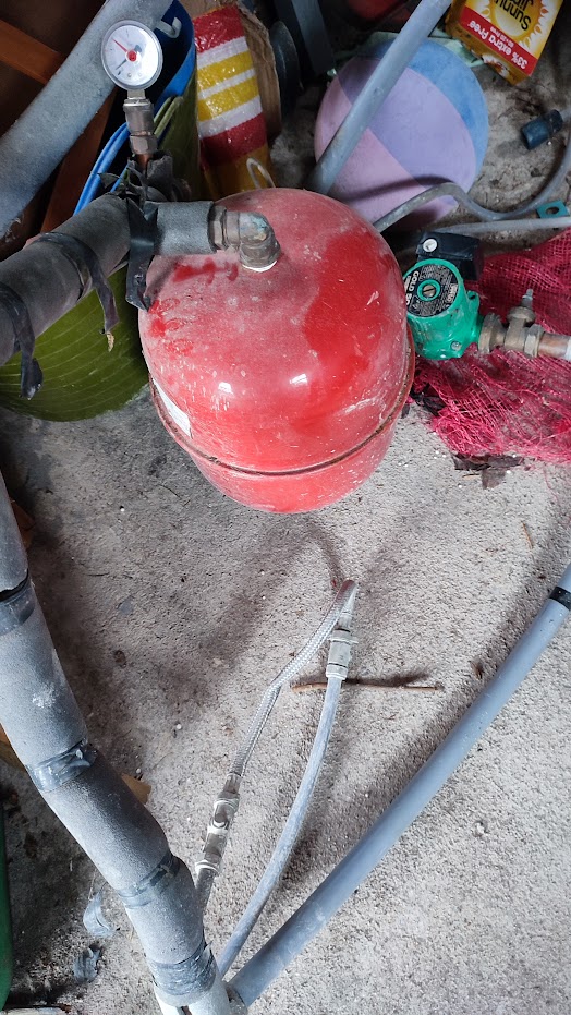

Thanks for the replies - the expansion tank, pump and oil line needs plumbed in.
No motorised valves - the boiler just heats up rads and hot water tank (in hot press) we just had a timer clock and thermostat in our hall before. All that has been disconnected but I think it basically just turned off/on a double socket outside in the old boiler house.
I am going to put a double socket in garage beside the boiler but just need help on best way to set up for the hive.

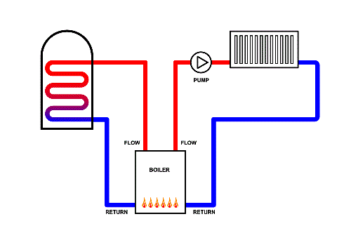

OK, provided that it used to work as per my previous post below, here's how to proceed. If the hot water is pumped and not heated by natural gravity circulation then it will be different, so you need to post back and let us know if that is the case.

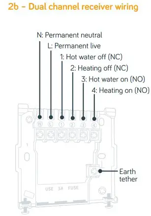

Then the Dual Channel Hive terminals are as follows:
Mains supply to (N) & (L) make sure to use correct fuse as per the manufacturers instructions.
Boiler L to Hot Water on (3) Boiler N to (N) - This is the mains supply to the control module that includes the boiler thermostat
Pump L to Heating on (4) Pump n to (N)
All earth wires to 'earth tether'
Set the Hive to operate with a "Gravity-fed and part-pumped system" the Hive instructions tell you how to do this.

With gravity heating of the hot water, the hot water channel (3) switches 'on' the boiler only and hot water circulates naturally around the hot water cylinder. So the hot water cylinder heats up.
Then, with pumped central heating, when the heating channel (4) switches on as well, so the pump now also starts, and circulates water around the radiators. The thermostatic function of the Hive will now switch the pump 'on' and 'off' to maintain the required room temperature as set on the Hive. However, the boiler being on a separate channel will still allow the hot water cylinder to be heated.
If you have a fully pumped system, i.e. the hot water cylinder and the radiators are both pumped, then it will be different so it's important that you find out which type of system you have.
The single channel Hive is for systems that don't have a connected hot water system (ie a combi boiler) if you were to wire a single channel Hive to a system with a hot water system then when the rooms were warm and the Hive switches off the heating it wouldn't heat any hot water either.

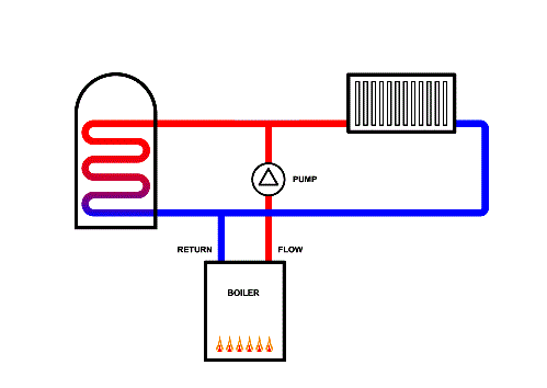

This is what I thought you might have had. Gravity circulation of hot water and only pumped central heating.
But if there is only one set of flow and return pipes feeding both the heating and hot water directly as per the diagram below, then you can't control them separately, without modifying the pipes or adding motorised valves.

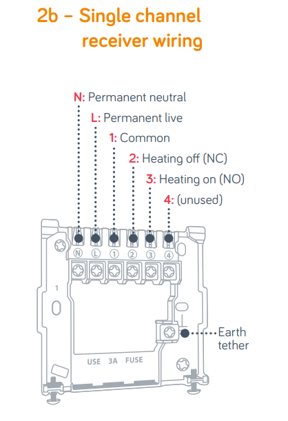

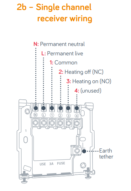

To utilise a single channel Hive with a system as per the above (but with the limitations I described earlier):
Boiler L to Heating on (3) Boiler N to (N) - This is the mains supply to the control module that includes the boiler thermostat
Pump L also to Heating on (3) and Pump N to (N)
Add a link wire between the terminals (L) and Common (1)
As I've not used Hive with a oil boiler, I would recommend that you check the current (Amps) drawn by your boiler to make sure that it doesn't exceed the current rating of the Hive receiver.
Looking at the manual for the boiler, it needs to be protected by a 5A fuse.
Will this cause any issue?
