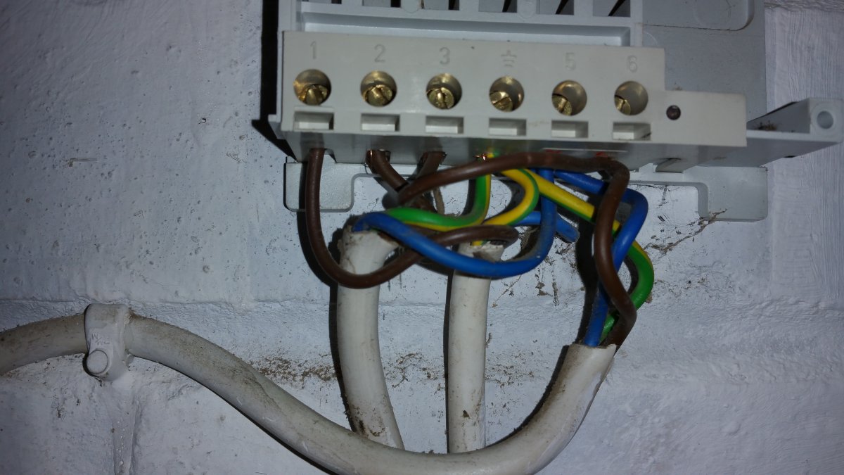

Hi Everyone,
I'm sure this has probably been asked before, I've read most of the posts on the Hive system so I think I have this correct but would like confirmation.
I have a Worcester Bosch Oil fired boiler, no thermostat, and a gravity fed water tank. I currently have no way of controlling my heating inside the house as the boiler and timer (which is next to useless) are both in an outhouse. The attached is a picture or the wiring in the Danfoss timer where 1 = HW, 2 = CH, 3 = COM, 5 = N, 6 = L, am I correct in thinking that to connect the hive receiver:
1 on Danfoss moves to 3 on the Hive receiver
2 on Danfoss moves to 4 on the Hive receiver
and the wire currently connecting 3 and 6 on the Danfoss is not required.
Any help would be greatly appreciated.
hive-jpg.88616
The old timer only allows heating on when the hot water is on, depending on what system of valves/pumps you have you may need to set the Hive to 'gravity' mode, so the hive works in the same way, or the boiler may not fire if only the heating is selected.
As for the wiring that sounds correct.
