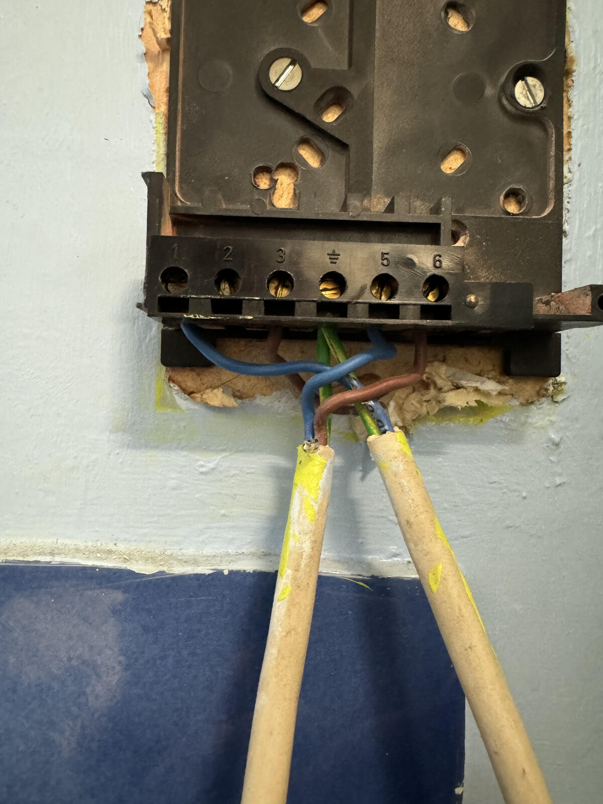

I have a Danfoss 103 timer, which is on my Vailliant VCW GB 242 E combi boiler.

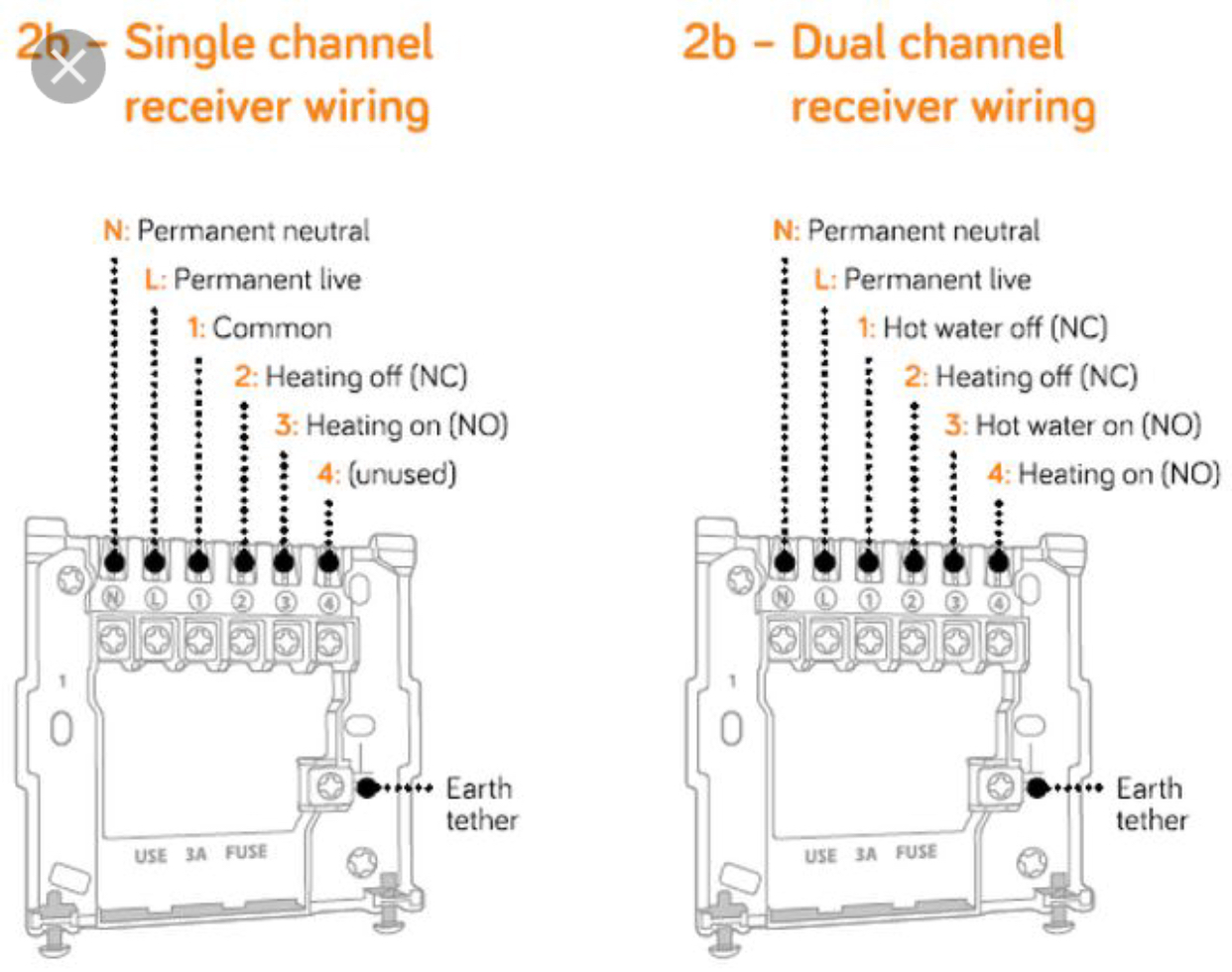

I want to switch the Danfoss 103 to a Hive thermostat, should I get the single channel one?
There are 6 wires in total currently going into the Danfoss 103, please see the photo. How should I wire these into the Hive please?
Thank you
Yep single channel, and any existing thermostat join switch wires, set to maximum or decommission, but you’ll need to alter some wiring.
Danfoss 103 to Hive
6 to L
5 to N
Earth to earth
3 to Com (1)
1 to Heating on (3)
