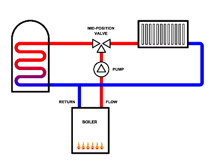

I wouldn't have expected to find a combi boiler, as stored hot water would be required for a home with 3 bathrooms, but for a property built in 1992 to have a gravity hot water system is very unusual. I would have expected to find a fully pumped system with motorised valve (or valves) to control the water flow from the boiler so that the pump also supplies the hot water cylinder (as per the diagram below) instead of it being heated by gravity circulation. Which is why I wanted you to check to be absolutely sure. If you compare the diagram below with the previous diagram sent you will see the difference between the two types of system. The wiring diagram I sent for installing the Hive is for a system with gravity fed hot water, it is not applicable to a fully pumped system.
FULLY PUMPED SYSTEM

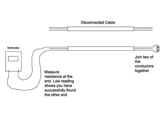

I've just gone out and bought a multimeter, which settings do I need to use to trace which wire is which?
That's not really something I can explain over a forum like this. But there are plenty of tutorials on line that will show you how to use it. The easiest and safest way would be to disconnect everything and then test each cable using the resistance settings to check the continuity of the wires in each cable allowing you to identify which is which. Check using the voltage function first to make sure that the cable you are testing is safe to work on.
To be sure, repeat the test with the far end disconnected and the reading will show a very high resistance.

Stem's cable testing diagram is very good, well done,
I would suggest that after finding the low resistance reading the two conductors are then disconnected from each other and another test, this time for high (infinite ) resistance is made to confirm it is the right cable.

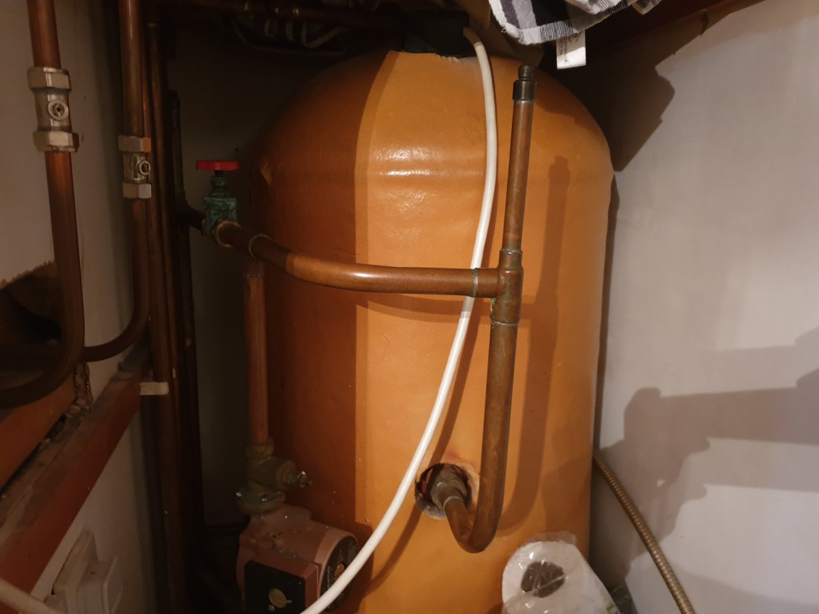

This is my hot water cylinder :

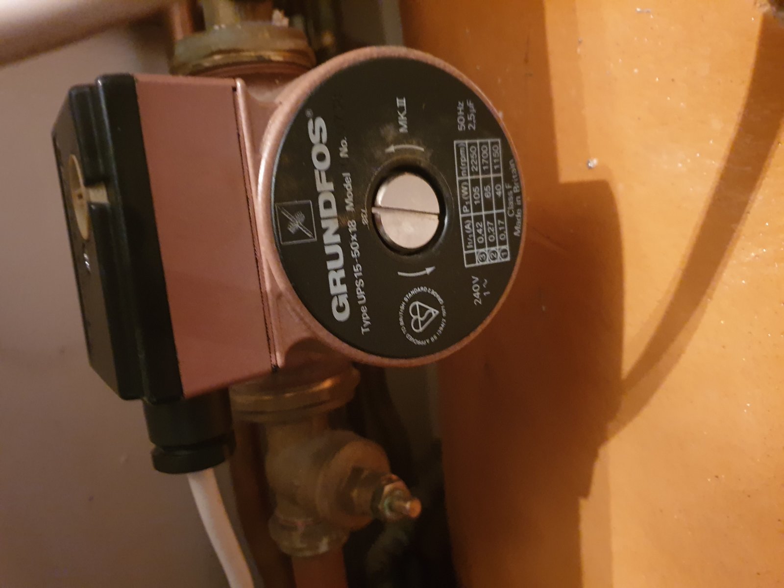

I take it that's the pump? So is my system fully pumped? If so would the wiring be different to connect?

That looks like fully pumped to me, the pipe from the pump supplies the hot water cylinder, so yes, the wiring will be totally different, meaning it's 'back to the drawing board' I'm afraid.
At the moment, for the hot water to be heated, the pump needs to operate, which means that the room thermostat can't presently be controlling the pump, otherwise you wouldn't get any hot water when the radiators weren't on. So the first question is if the room thermostat isn't wired to to pump, what is it wired to? I would expect the room thermostat to be controlling a motorised valve. Something like this.

your system is a total bosh, in the pic with your pump above it is a gate valve (red handled valve) looks as if that is a manual way to shut the heating off and leaving the HW only running, as @stem says a hive is no good for your set up without adding additional controls
