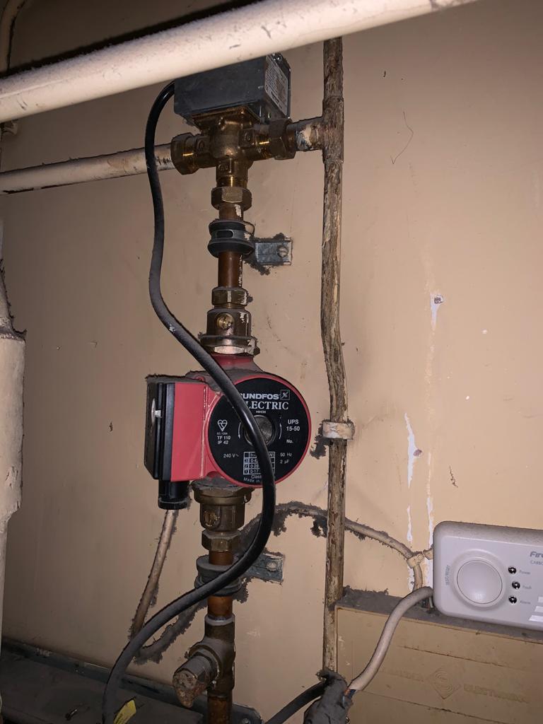

Hi I'm trying to wire up a dual hive hot water,central heating controller my Danfoss model 102, and its a three port valve with no room thermostat. Was wondering if there is a wiring diagram for this? Danfoss has a comm terminal which is confusing hive doesn't.
The Danfoss 102 will probably have a link inserted to join together the 'L' and 'Com' terminal. Hive has this link already made internally for you, so no extra external link is required.
Are you sure you have a 3-Port valve though? This type of motorised valve requires a 'hot water off' connection that closes the hot water port when no further heating of the hot water is required, but the 102 doesn't have this facility. (Hive does, it uses terminal 1)
there will be a label on your 3-port valve post a pic of it , you may have a simple diverter valve as opposed to a mid poition valve

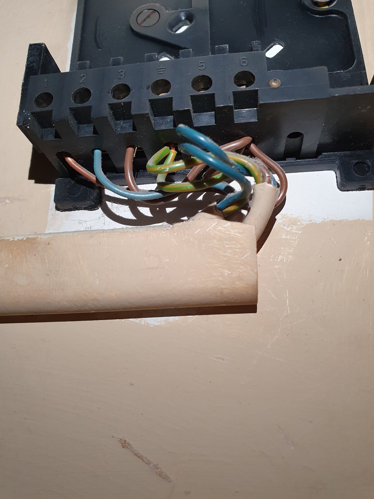

This is the danfoss 102

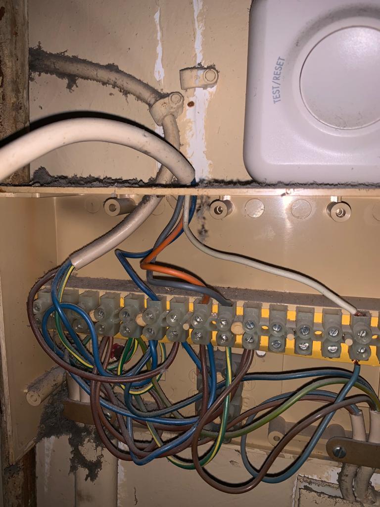

Photos as requested

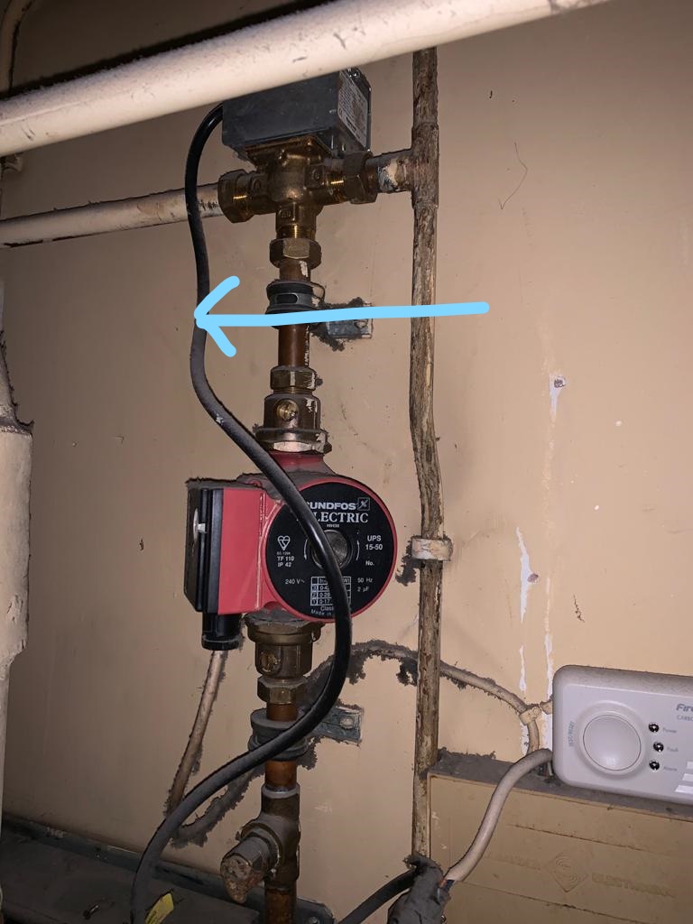

The cable on your valve is black, which is correct , but your pics show white cables in the junction box ? ahere does this change ?
