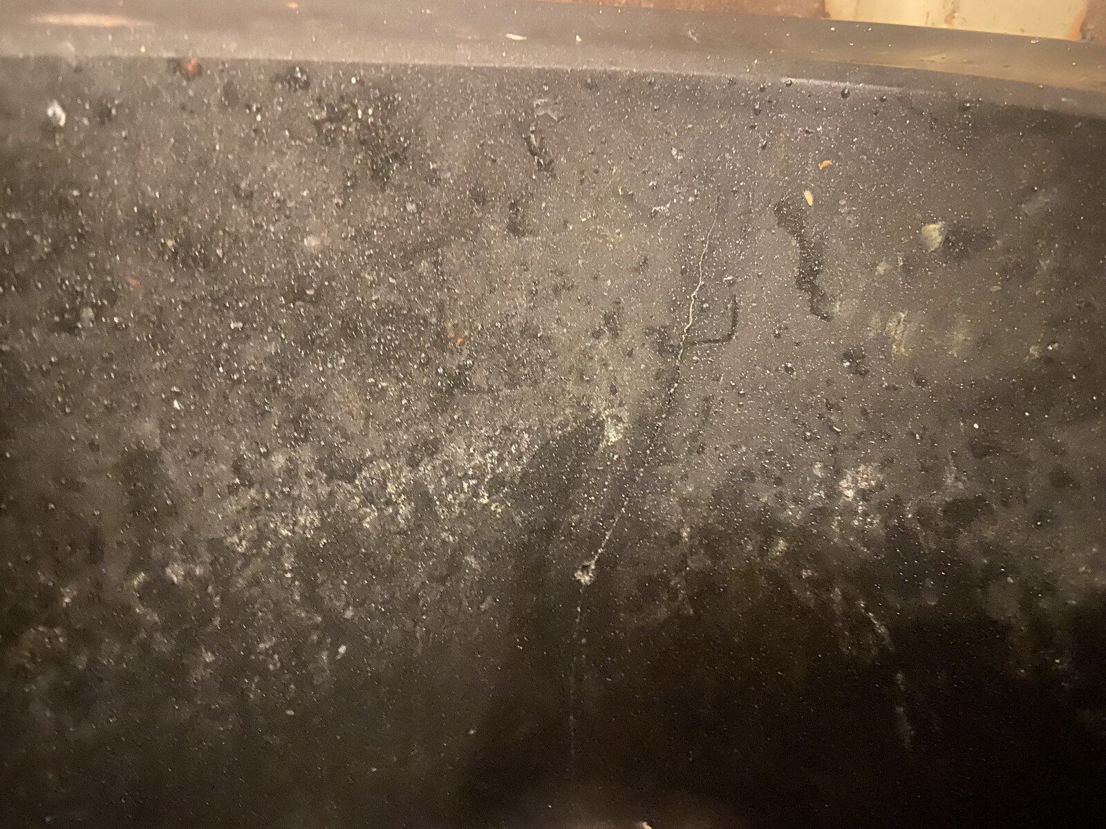

In a fit of pique (big row with er indoors followed by tins of lager spewing all over kitchen), I threw pair of scissors in disgust. Unfortunately they embedded themselves in kitchen sink. We now have puncture hole and crack a few inches long.
This was a Magnet Mocha composite, granite worktop fitted in 2016. Think this may be it.
Also included photo highlighting damage.
Other than using bowl or replacing, is there an epoxy fix for this?
Feel so stupid, but it is what it is..
I would try some car body filler, to fill the hole, then blather it widely, across the underside of the crack. The filler's grey colour, will not match, so you would either have to live with it, or find some sort of dye, to colour the filler.

Many thanks. What do you mean by blather? Also, the underside is v difficult to access. I tried taking a photo but could hardly see a crack. (It must be there as water leaking out)

Put plenty of filler on, over the underside, where the crack is. Spread it well either side of the crack. You must make sure the underside is both clean, and dry, before you start. You get just minutes, before the filler goes off, so you need to work fast.
It might help, if once the filler job has been finished, to add some superglue, along the crack, from the inside of the bowl, as an extra seal. Moisture makes superglue set rapidly, so again it needs to be perfectly dry when doing that, so it can be drawn deep into the crack.

Thanks. Will try the marine stuff. My main concern is difficulty viewing and then applying the filler to the rear of the sink. It’s almost like there’s no perceptible crack but water is coming through.
