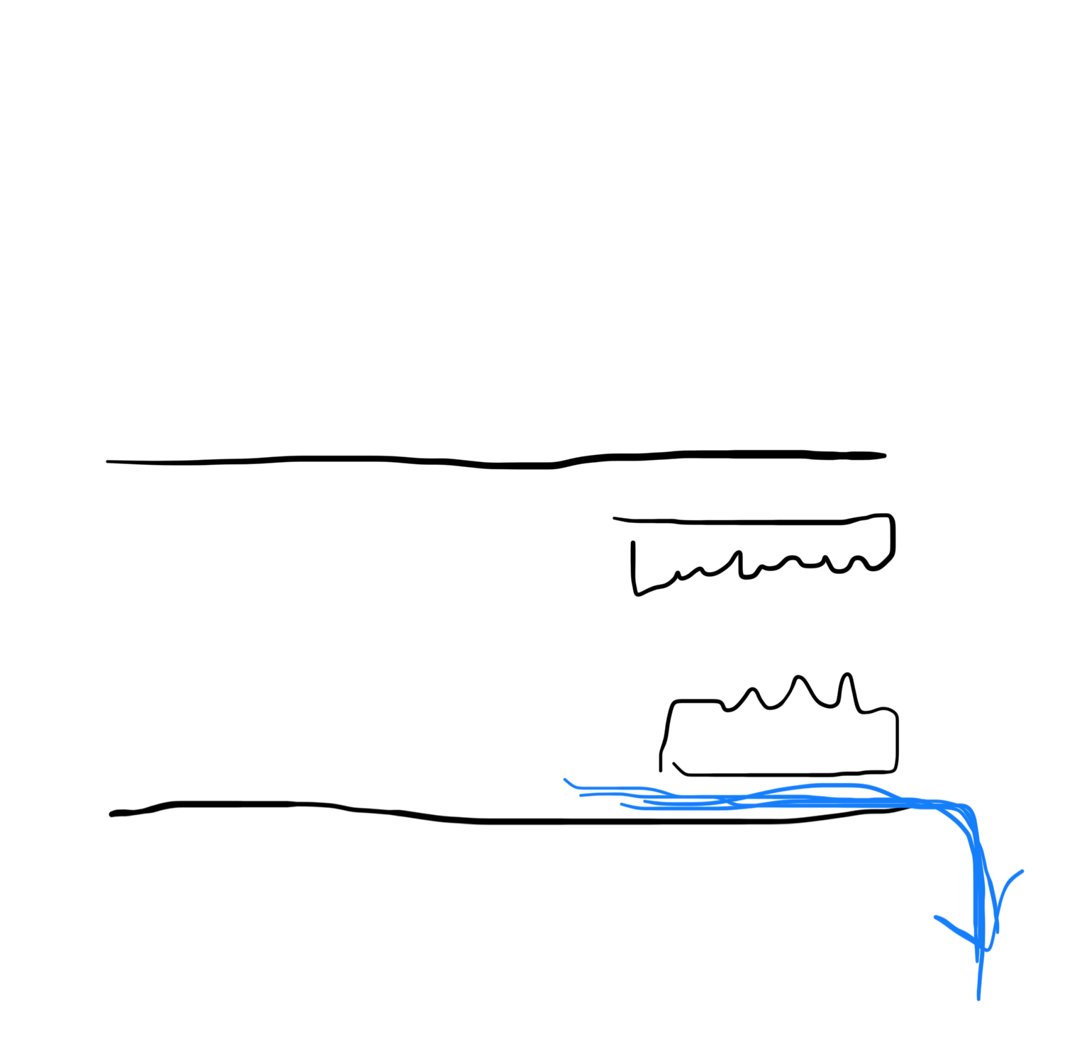

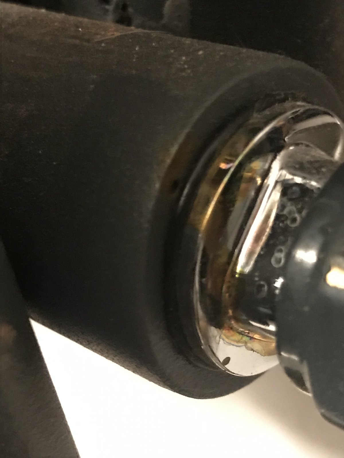

I just noticed a radiator dripping so closed the valves and it stopped. There’s a hole in it near the valve and i’m wondering what are my chances of fixing it?
It must be on the threaded part with it being so close to the end

If its on the female threaded spigot, where it mates with the male thread of the valve tail, you could try some liquid ptfe to remake the tail into the socket and thus seal both at the same time perhaps! Whilst you pursue the warranty claim :)

Only way to fix that is to drain, dry and weld/braise. Know anyone local that can weld cause that will take 2 secs and 2p of time to do.
I think you might be right.
I took the valve off today and I think the threaded part is an insert into the steel tube that’s the radiator bottom.
The weld must not be good all around the insert. I’ve sealed it in and out for now and if it leaks again i’ll get it welded. I’m pleased it’s not corroded.
I think the leak comes through like this:
