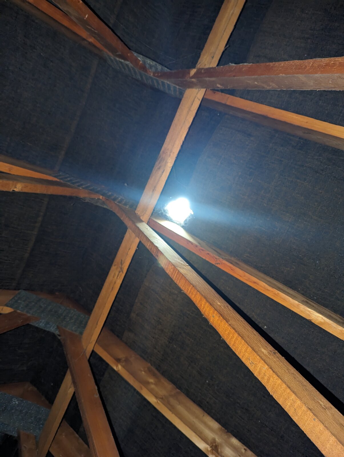

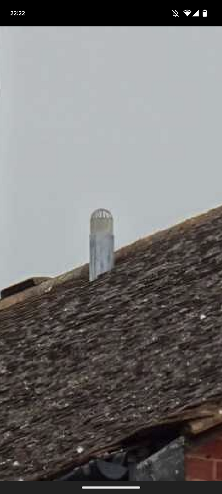

I have had a survey done on a house I intend(ed?) to buy.
The survey showed a concerning hole near the ridge where an old flue used to be. It appears that the seller, or perhaps previous owner before them, removed the flue but didn't bother to take care of the result 4-5 inch hole left over. There is visible staining of the loft floor boarding where water has entered through this hole and dropped on the the boards.
Does anyone have any plausible reason why this hole would just be left open?
How urgently does this need fixed? What are the options for fixing this?
Following the survey, I visited the property myself and took the photos attached.

It would likely need a new tile/slate or whatever the roof covering is made from plus a felt repair. I would get it done (or better yet the current owner) before winter as you don’t know the likely damage it’s caused. If current owner not prepared ask them to knock some money off. Also it looks like a soil and vent pipe, unless I can’t see it.
