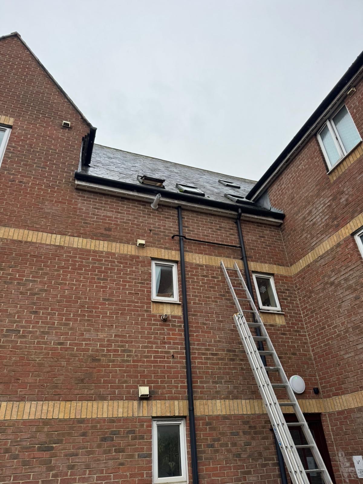

They seem to have come back today to finish the work. Does this now look compliant with regulations and a decent enough job (leaving aside the issue of distance between the flue and window)? Perhaps @CountryFan @Harry Bloomfield . Thanks again for your perspectives.
Well, the hole is fine. Did you ask about the distance from the soffit ventilation? The condensate pipe isn't insulated either.

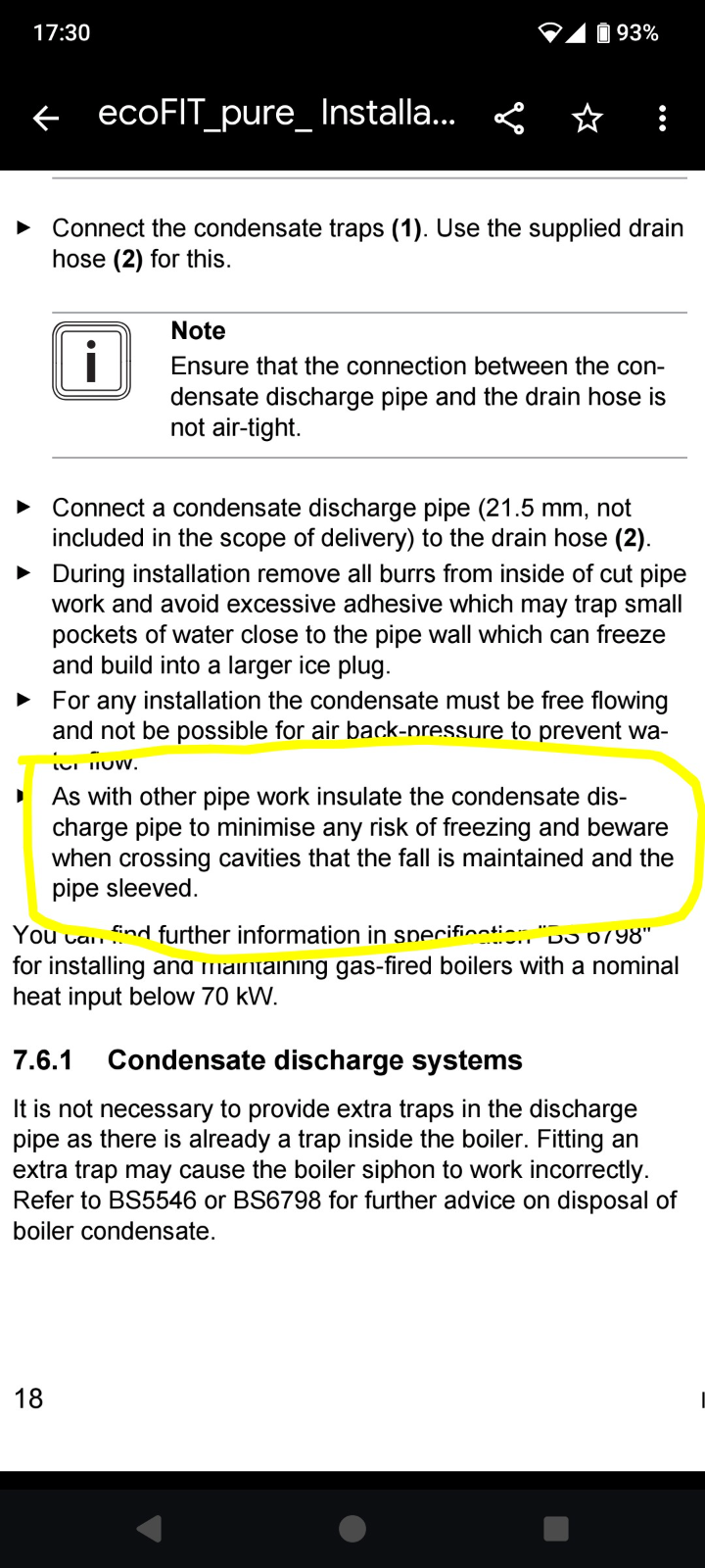

Thanks for the replies. I looked at the manufacturer's instructions here and they do say there should be a fall of at least 45mm/m and the pipe should be insulated. I will take that up with them. However there doesn't seem to be a requirement for supports along the length, nor in other regulations that I could find - is there a particular place that would stipulate that and apply here?

There is little, if any obvious fall.

Common sense, dictates that it needs to be adequately supported. Once that pipe gets condensate in it, it will be much heavier, and the heavier it gets, the greater the droop, the heavier it will become, with an eventual complete collapse.

Although its not right it is not going to collapse with around a litre of water an hour trickling through it
I got a call back from the engineer who said:
- there is a significant fall and the photo is deceiving. I guess it's hard to verify...
- the pipe is 32mm, so it doesn't need insulation, and he claims it's generally uncommon for condensate pipes to be insulated. I can't see this stated in the manufacturer's instructions. Does that make sense to anyone?

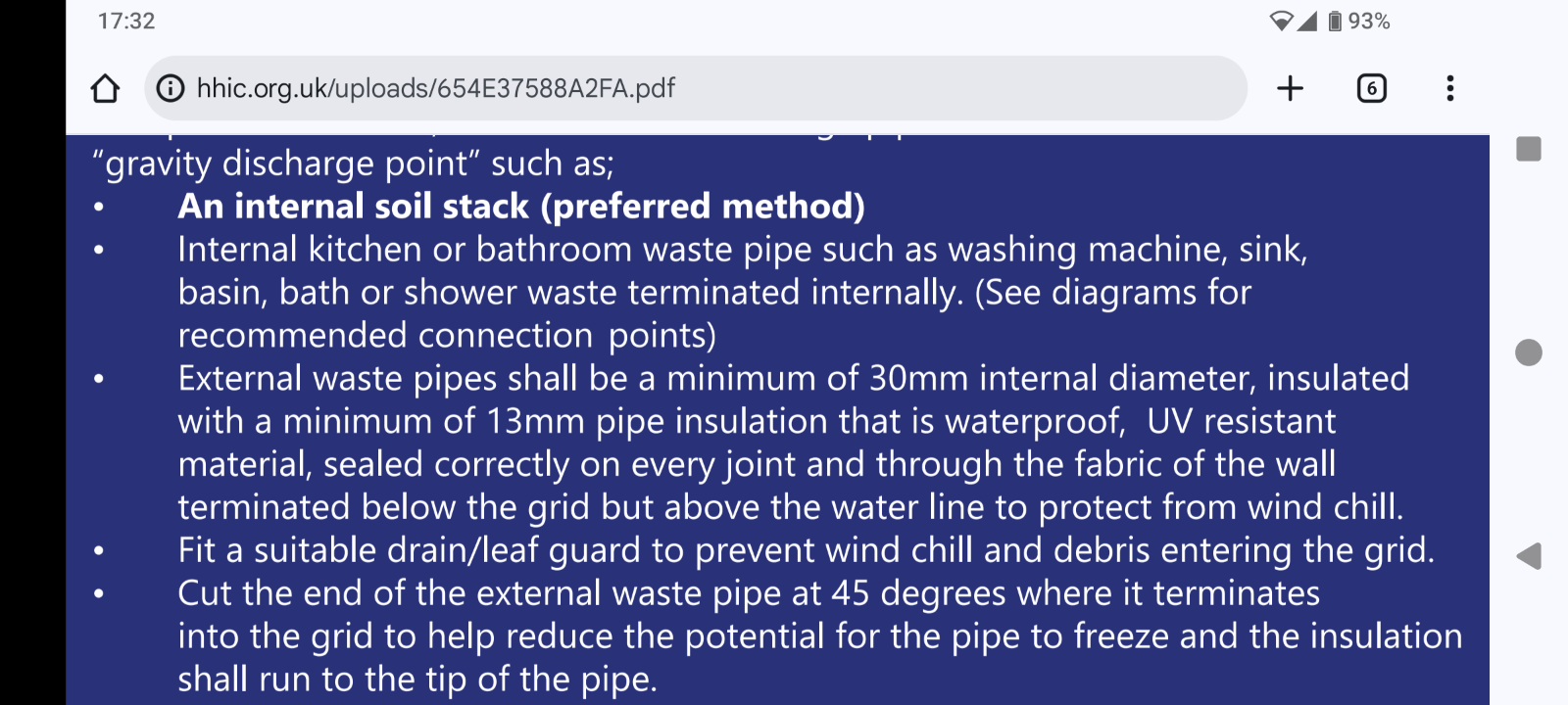

From mi's and hot water and heating installation council (second paragraph).

If it’s not sealed inside or out, then no it doesn’t. Should be sealed to the building fabric, but mi’s will stipulate what they want.
Any opening to the building, such as an air vent, ventilation, holes et al. The flue should be 25mm away, might be more from the soffits, again would be in the mi’s.
Coming back to the issue of the flue position, would could the consequences be if it were determined to be too close to the soffits, eaves or window? Can that be rectified without having to do major work? Or could it mean the flue must be moved again, and consequently probably the boiler as well? Would the boiler need to be deactivated immediately or would there be time allowed to arrange to do remedial work? Would I have recourse to recover the costs of any remedial work from the installers?

AFAIR that particular flue position is not shown on the building regs. or manufacturers diagrams.
Gas-Safe tend to suggest we use our "engineering judgement" and of course the unscrupulous installers will not care less whether it's actually safe.
It's possible a plume management kit might be an option if deemed unsafe.
A vertical flue below a rooflight has a 2m clearance but that's very different to this situation.
I would email all concerns to Gas-Safe requesting their opinion. If there are any issues they will force to installers to correct them at their own expense.
