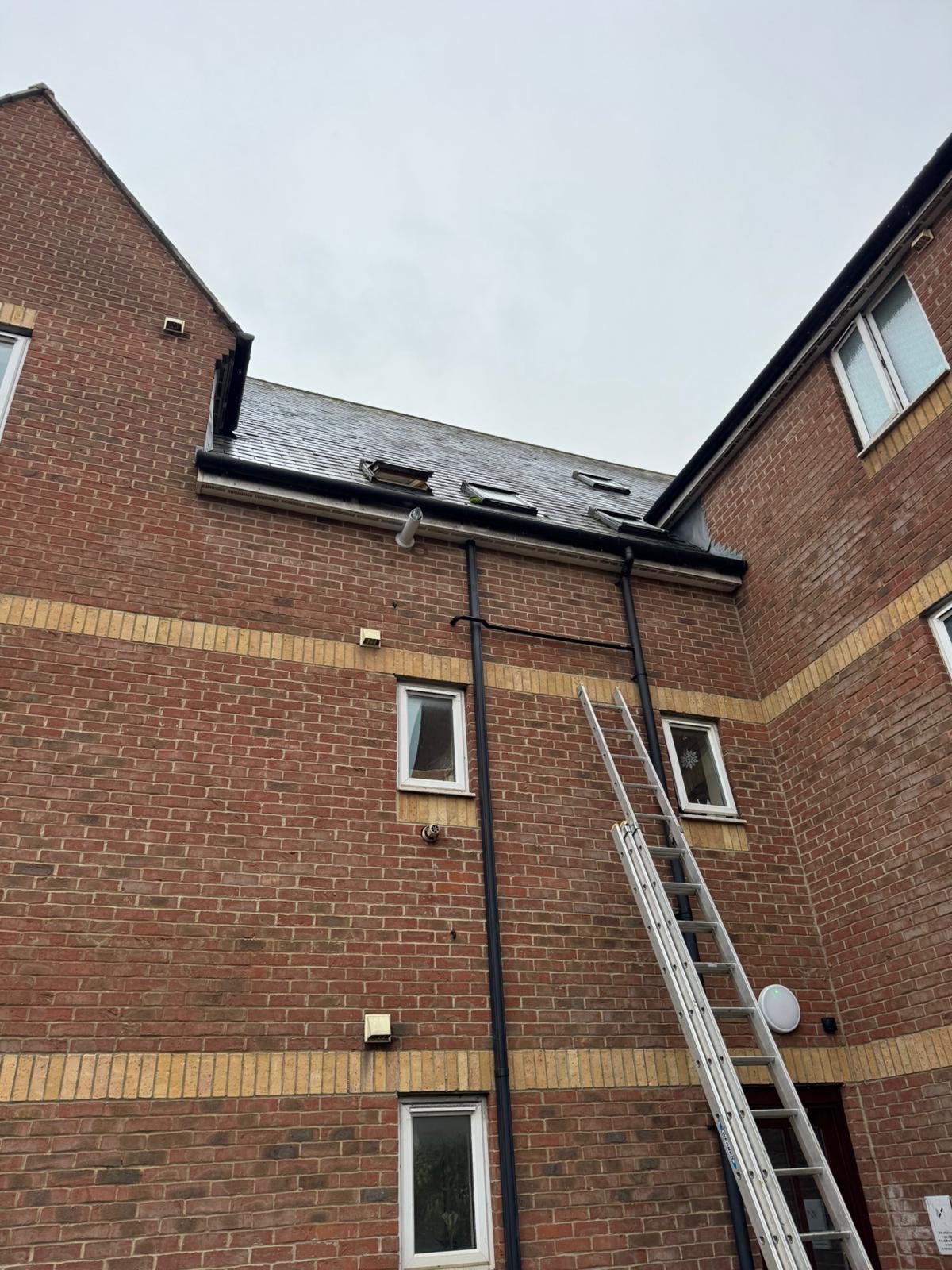

Boiler installer left old flue hole open
Ah OK, sorry for misunderstanding. I don't know if that pipe in the bottom right is new - I don't have photos of that wall and don't remember what was there before. I believe the previous boiler was non-condensing - it was a Ferroli F30, plausibly from 2004 when I think the flat was built, and my EPC from when I moved in says the flat would benefit from having a condensing boiler installed. Is it likely to be a newly installed condensate drain pipe then? And it ought to have been connected into another drain?

It looks as if the installer, only had access from the inside, so did all the work from inside, completely ignoring the outside finishing. Perhaps the intention is to return later, to complete the job?
It only came out in email discussions afterwards about another issue that the flue had been repositioned, and they mentioned none of the other issues raised here, so I don't think they were planning to come back to it!

You need to make sure they return, and properly complete the job. I cannot imagine why they might think it was OK to leave an unfixed hole in the wall, like that.

Drop a tape measure down, from the lower edge of that Velux, to the flue pipe. It is required to measure greater than 300mm distant.

It's also worthwhile your investigating the purpose of the white pipe. If it's a condensate disharge, when the boiler is in operation, every so often, it will discharge a batch of condensate water, out of the pipe. The water is slightly acidic, and needs to be discharged in an acceptable way. Simply pouring out, from a height, is not acceptable.
I am not a plumber but I have seen the liquid from condensate pipes erode concrete (albeit very slowly).
Yep, as @Harry Bloomfield it's slightly acidic and will eat away at most things over time, exactly the reason it must not be metal
Neither is the white pipe, has to be insulated through the wall now

No it's not a dumb question. The pipe is already in the wall (if it is indeed that one), but should have been up sized to 36mm and insulated in the wall or at least externally. As for the installation, if there was a deviation to the quote, they should have discussed it with you. I wouldn't expect it to pass a gas safe inspection - if they don't respond I would speak to these (gas safe register). Were the company definitely registered?

Almost certainly it's the condensate pipe, but be good to confirm. If so, even if it's insulated it still needs to be piped to a drain.
Much better if possible, is to route it to a drain inside the flat, eg to a washing machine or dishwasher drain. That also avoids the frost problem.

I sent them an email with the various issues and asked them to call me ASAP. The company director called me quite soon after and said they were booked in to do the external work in 2 days time. They hadn't mentioned this before in a couple of weeks of emails back and forth. He seemed to be implying that this had already been planned, though it's not clear to me.
Though now I'm wondering if I approve them going back, whether that means that if the freeholder subsequently objects then I can't say this was done without my knowledge, and I should tell them to hold off until I've discussed it with the freeholder. But then it may take weeks to get the repair done. Ugh...
Something else that seems off is that the director said they'd now received the Building Regulations Compliance Certificate, but I wonder how that is possible to get legitimately before the work that's needed that was identified above is carried out.
