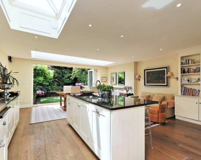

OK, lets be constructive. I have an open plan room with a roof lantern and bifold. Not too dissimilar to this and this is the look I am trying to achieve:
I will also have lamps.
What would you replace these downlights with, given what I am trying to achieve?
I have four of these...
https://www.ledhut.co.uk/spot-lights/ceiling-lights/18-watt-led-downlight.html
in the half of my kitchen where the units and worksurfaces are, along with a roof lantern. I chose them specifically because they have a wide beam angle and I could get them in warm white, and they are unobtrusive with white surrounds.
They provide very good lighting, no shadows when using the worksurfaces. I do have units with a gloss cream finish and white walls, so I guess plenty of light dispersing around at all angles helps the cause too.
