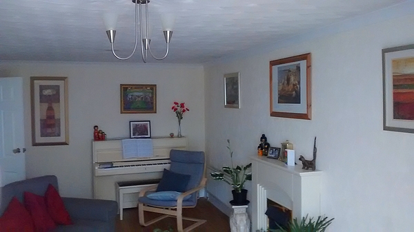

my wife suggested daylight as we dont have a window in this room...to put one in would cost aroun £1000 so we moved onto daylighting at one end and warm white at the other end where there are french doors opening onto a conservatory with translucent roof sheets
on a dullish day, as it is today.. the far end of the room away from the conservatory is very dulll...that is where we would have put a window in a side wall...so leading us to think to put in 3 largish daylight led bulb units with drivers fitted into the bulbs

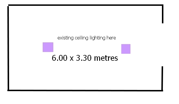

you may see where i am going wrong..dont hesitate to advise
i have also attached the room plan and pics just to see, for interest and for any other viewers who can steer me a bit forward

Are you going to be using the lighting during the day? If so then by all means use daylight lamps. It'll then look similar to your conservatory, though of course will still never be as bright. I would still be very reluctant to pepper a living room ceiling with holes though. Could you find cool white LED lamps to fit those fittings you have now?
For evenings you will want some warm white lighting like i described above to relax in. You could achieve this with some uplighters or even some table lamps.

i am looking at a large but slim surface fitting which i agree i could do a 6000-7000 K near the piano and a warmer unit at the conservatory end..we have actually got the tv that end so its not an are where we read much...although even with the existing light at the piano end we can read...we seldom have the conservatory end light on except for when we have a number of people visiting...which include 7 grandchildren..:)
the existing lights we brought from our recent move...and since the ceilings here are marginally lower at 7'-6"...seem to be a bit intrusive
your idea about using other bulb types could mean we could perhaps get new light fittings which dont dangle so much and do a bulb swop on them...i am pursuing that now since the hole in the ceiling situation could as you point out look rather bizarre in our 1985 bungalow styling..which we like
