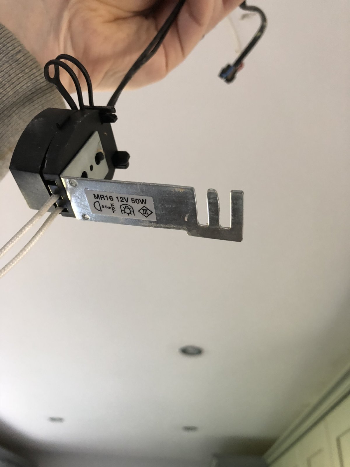

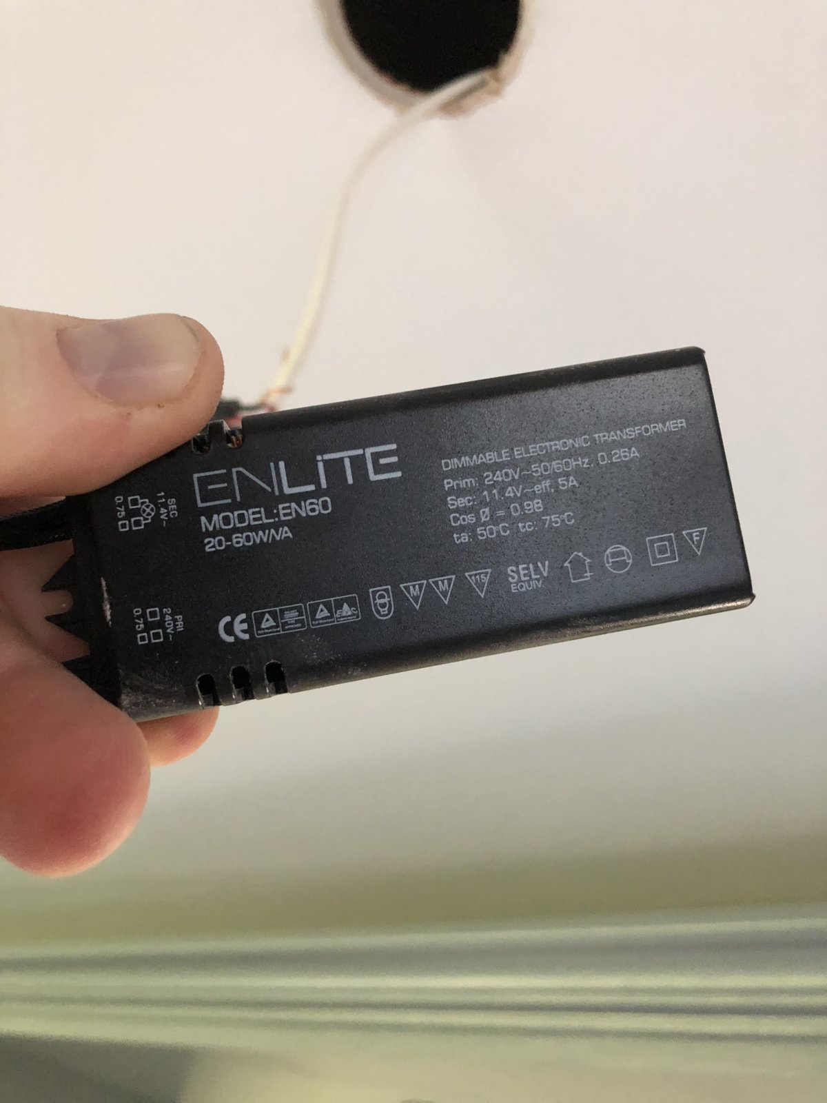

Ok folks so this is what we have going on up there
Looks like main feed going into a transformer. Then going into something else and then to the halogen light fitting.
Any thoughts on easy fix to put LEDs in based on this setup?

I tried the easy option of fitting LED bulbs in existing fittings and they didn’t draw enough power from the existing transformers and just gave a dull flicker.
The power supplies are rated at Sec 11.4V~eff 5 A
That ~eff means the output has the same effect as 11.4Volts but could be an output that averages to be 11.4 volts and may have high frequency pulses as high as 36 volts. The driver in the LED lamp will be "confused" by these high freguency / voltage pulses and wil not operate properly. An incandescent lamp will work normally as it will average out the pulses.
Can you tell me why I wouldn’t use one of these as a direct replacement for the ‘switch mode’ and connect LEDs to that?
https://www.screwfix.com/p/halolite...va/48058#product_additional_details_container
The product you’ve sent a link to looks a bit too complex for me !!! and I wouldn’t know what to do to connect 6 lights to it
Appreciate the help
Because that is another switch mode power supply similar to what you have. It has a minimum load requirement of 20 watts (your LEDs will be no more than 7 watts) and the output will be in tens of kHz not 50 Hz.
You could use six of the transformers I linked to or use one and an electrician to wire it up.
