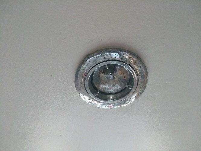

A recent EICR picked up the fact that 6 out of 7 downlights in a bathroom needed replacing with ''new led suitably rated downlighters on a one for one basis''.
All existing downlights are halogen.

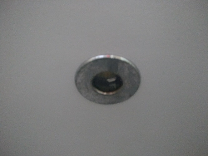

Downlight number 7 was above the shower cubicle and was not mentioned as needing replacing despite being halogen. I'm assuming this is because the IP rating is sufficient.
My question is:
Can I swap out the 6 existing downlights for new LED downlights, if so, which IP rating, I'm assuming IP65 minimum ?
Can I leave the shower cubicle downlight as it is , meaning the circuit will be 6 led and 1 halogen ?
Will this cause any issues with the existing light switch?
I have had issues before when changing to LED fittings with light switches not having enough load on the circuit to work properly.
All bulbs must be dimmable.
Thanks for any info
downlights to room x 6
downlight to shower x1

re the shower light. There’s no problem In leaving this as halogen, and the switch etc will be fine. except that halogen lights have been phased out - that’s why you don’t see them in Tesco’s any more. So you’ll need to be changing that soonish. Better to change it while you are at it.

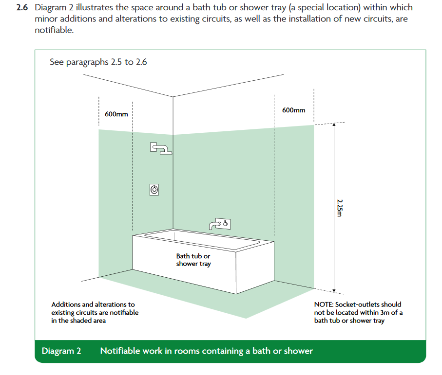

No reference to IP ratings in Part P.

Will I encounter any issues with these, or is it as straightforward as swapping out the existing light for these ones
Issues, maybe.
Make sure the existing hole size isn’t larger than the new fittings!
Probably the existing fittings are 12v. Your proposed ones are mains voltage. If they are 12v there will be one or more transformers that will need to be removed.
Any LED fitting? There are other requirements, some of which are part of other building regulations that need to be taken into account. Things like acoustic performance and resistance to thd passage of moisture are also required to be complied with .
Your electrician has possibly assumed correctly that fire-rated fitting are needed in that ceiling. The Enlight fittings in your above link are not fire-rated.
The requirements for IP ratings and the definitions of zones in bathrooms etc are not in Part P. They are in BS7671, the Wiring Regulations.
