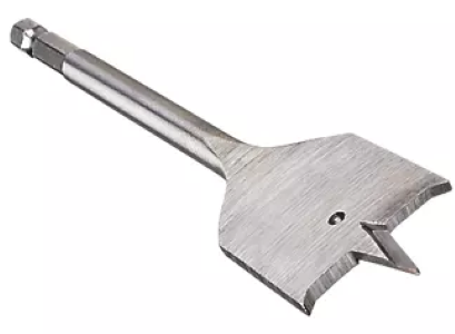

Thinking about it, a holesaw is an expensive way to drill a small one-off hole in timber-derived materials. Frankly a cheaper way would be to get a spade bit, the type with a plain centre point and spurs or nickers on the outer edges of the body, thus:
That's a deWalt 25mm spade bit, but you can clearly see the plain centre point and the spurs or nickers at the outside edges (I use Irwin x4 spade bits for that reason - pre-COVID/Brexit you used to be able to get a set of 16 no of those for just over £20, a bargain). As opposed to that there are bits like this Bosch spade bit with a screw centre point which I find almost uncontrollable, producing a fast but rough hole because the screw point causes them to pull in very quickly:
If you can clamp a piece of scrap wood firmly to the hardboard back of the hardboard it should be possible to drill through from one side only. Alternatively, if that isn't feasible drill through from both sides, as above. Spade bits are designed to be used at high rpm. If drilling from one side only without back support there will invariably be an amount of breakl-out at the back. To minimise this don't push too hard and ese-up as you get to the end of the cut

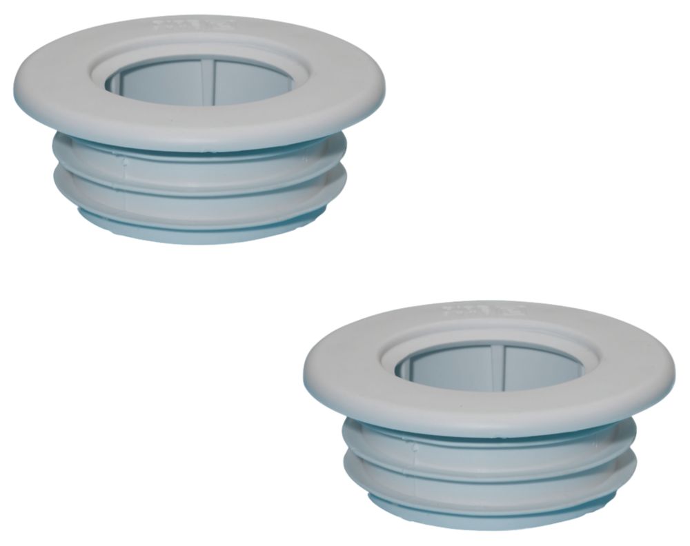

You could use a 20-25 mm hole saw and potentially source (first) some kind of plastic trim to hide the edges?
i wouldn’t care too much about a pipe hole but even a modified version of one of these
would do?
basically just find a neat plastic disc to act as a cover
