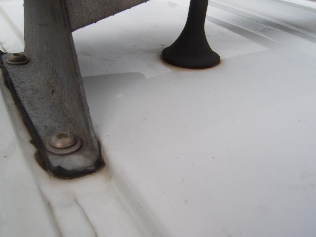

C Carlnorwich Joined 7 Feb 2008 Messages 206 Reaction score 6 Country 12 May 2010 #1 Untitled Media owner Carlnorwich Date added 12 May 2010 Comments 1 I would like to remove my roof rack and an emergency light from the roof which should be easy enough. Question is, what do I do about the holes that will be left behind? Many thanks.

B Burnerman Joined 7 Feb 2008 Messages 26,400 Reaction score 5,883 Location Northumberland Country 12 May 2010 #3 Halfords do a range of rubber blanking grommets - they take paint, too. John
P pen4uk Joined 21 Mar 2010 Messages 74 Reaction score 1 Location Kent Country 23 May 2010 #4 Easy fast way matey, Araldite around the hole edge and lay a penny over it 5 mins Rock hard no leaks and ya can't see it on that high roof MAGIC PENNY
