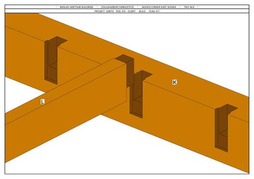

That unfortunately is a nasty arrangement. Are you sure there is not another 9x3 trimmer joist near the outside wall picking up the end of the trimming joist (the vertical one in the sketch)?
Also the joists ends fixed to the trimming joist need to be left well alone as they will be partially cut and jointed at the ends and pinned with big nails. So you actually need to be as far away from them as possible. Certainly not close and this is obviously the oppersite of what you want. Essentially I would not do it. However, just how far from the joist ends can you get?

Doing the holes 2' (600mm) from the ends you would probably be OK. Just take a good look at the joists for defects like large knots splits or shakes. If they are all sound then I would think it would be OK.
Edit: Use solvent weld pipe and joints in the floor void and a sweep bend not a knuckle bend. Possibly an anti-vac trap instead of the normal(due length of pipe run).
IMO you could drill 12" from the end if need be. With a 9" deep joist, there's still plenty of meat left on it to take the shear force.
I would not disagree, but if traditionally fitted with a notched ends at the joint and the possibility of ungraded timber with some defects better to be safe. If modern with joist hangers and graded timber then OK Traditional joint as below changes the section at the end. There are other joint type but all reduce the end section. Shear isn't the problem
Thanks guys...The joints are all tennon and mortice, joists look good...no massive knots, shakes or splits.
