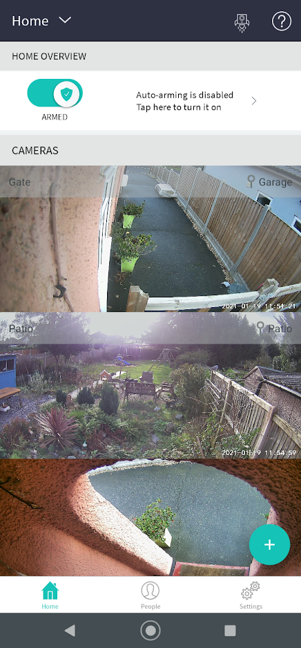

I have 2 Neos cameras. Designed really for indoors, but I have mine in outdoor enclosures.
They are £25 each, enclosures about £10 (you could make something) and they store short video clips on cloud for free, or for about $2.50 through Google Pay you get longer clips. Night vision is good. I have turned telephone alerts off as there is a lot of alerts, especially on driveways where car lights will trigger it. The sun coming out also triggers it, as do spiders, flies, cats etc! Wifi only (2.4Ghz)
But for under £100 I can't complain. Been up for about 2 years now.
Obviously over time it will be more expensive than some HDD based systems.
Mobile screenshot (reminds me, need to move the patio back to the patio area - pointed at the garden when my son wanted to camp out during lockdown!):
not sure what the resolution recorded is and that's when it will count as will day/ versus night images.
It be esy to see someone on the first image furthest away from the camera (detect), but wont have a useful image until they are much closer I suspect with 2 to 3M of the camera, but hard to say, with certainty. I gues having someone stood at various points would demonstrate the limitations with a digital zoom where necessary.
