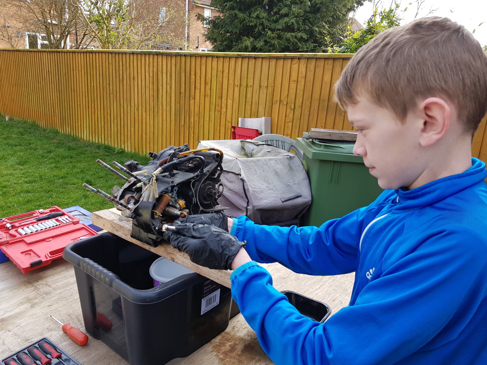

I had an MT-5 as my first bike and built it from the engine up at 13.
Found a basket case and thought it would be a good project for me and my lad.

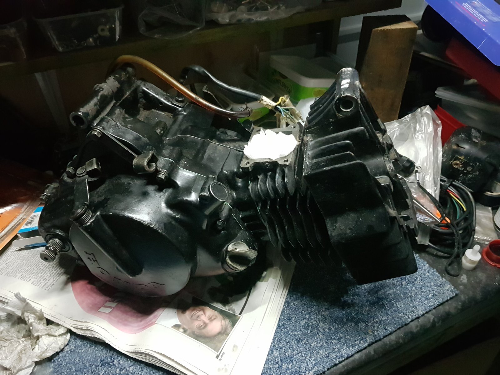

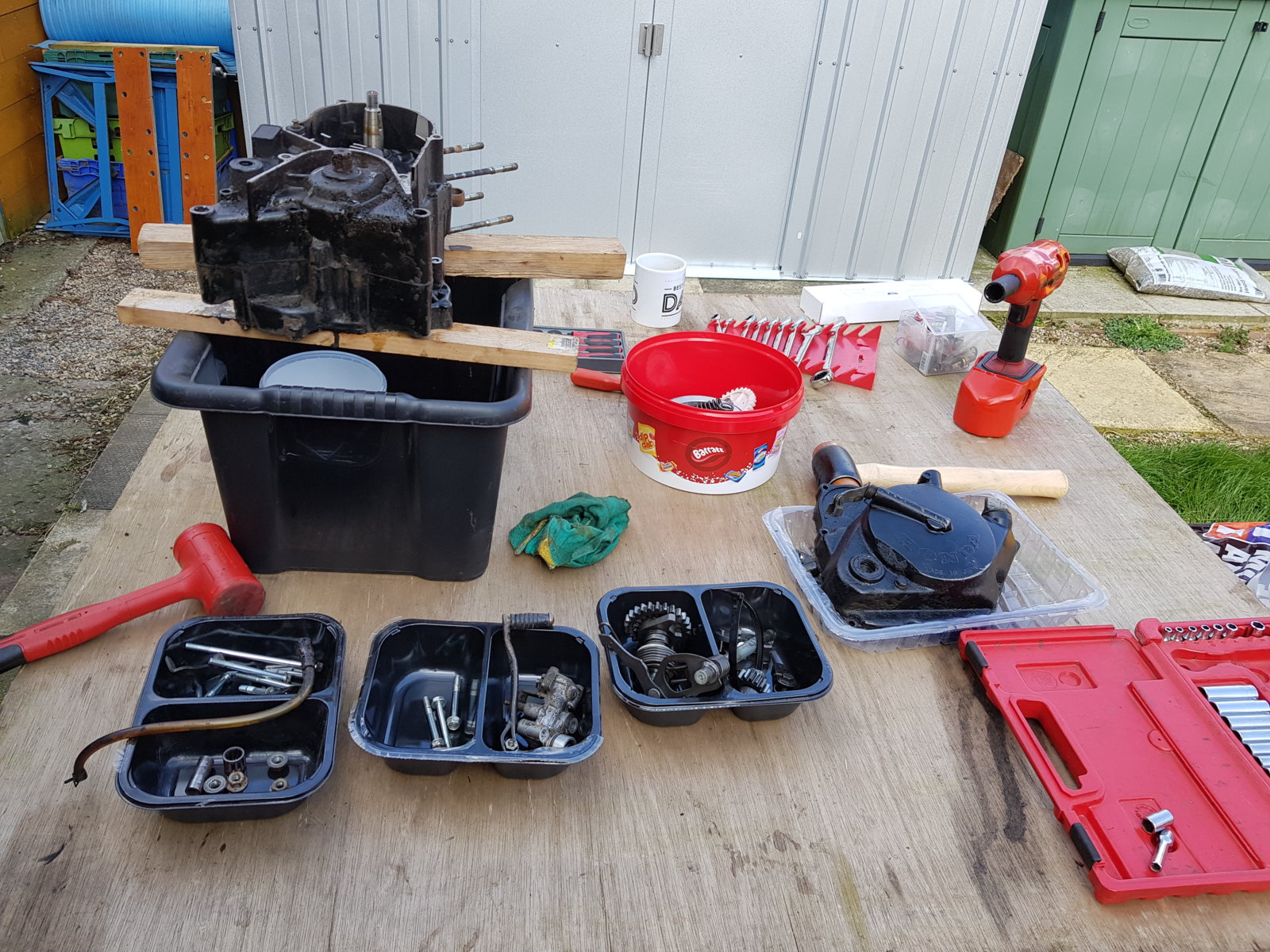

He's done great so far, new fork seals and we've stripped the engine, new main bearings etc.

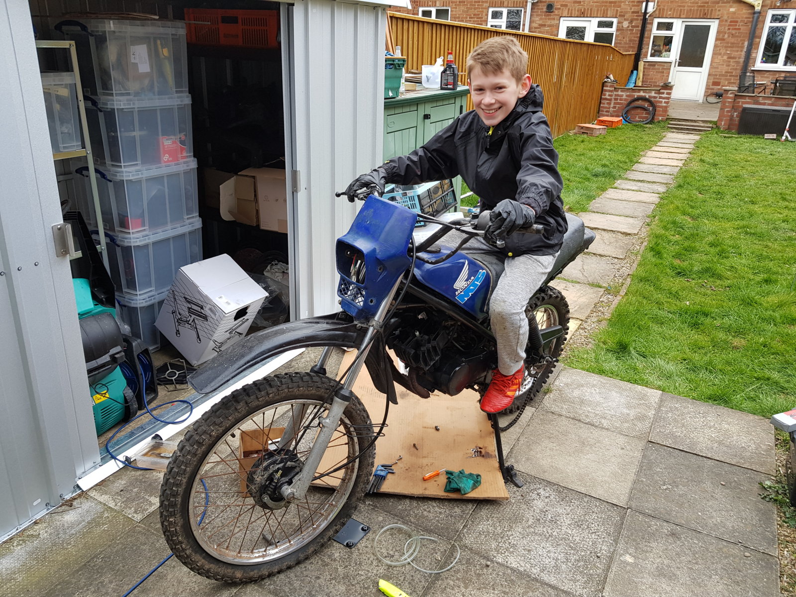

His face was priceless on Sunday when he got it running after spending a good couple of days grafting.

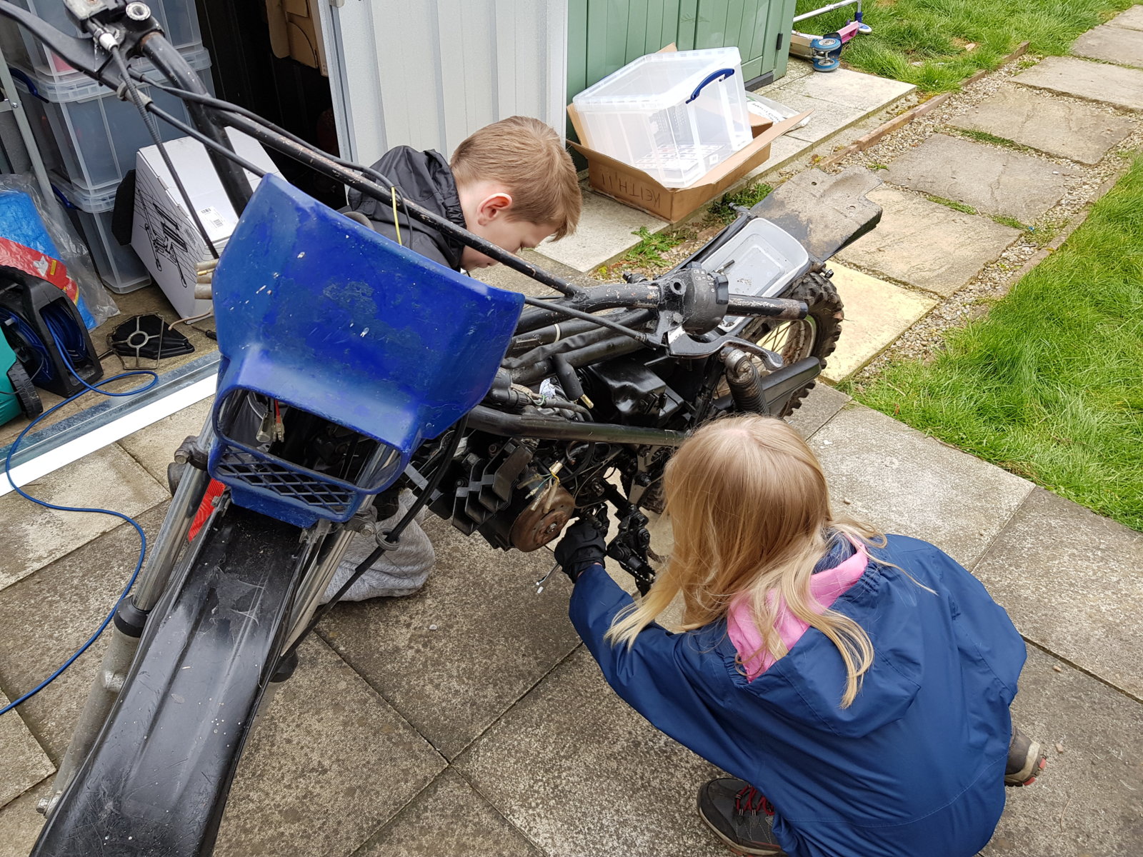

Daughter even pitched in!.
Just thought I'd lighten the mood with a happy post..

Yep reed valve and 2 stroke pump!. The RHS main bearing is lubricated with gearbox oil, we've put new seals in and bearings.
Grampians and Ebay for most bits, or modify later Honda parts to fit.

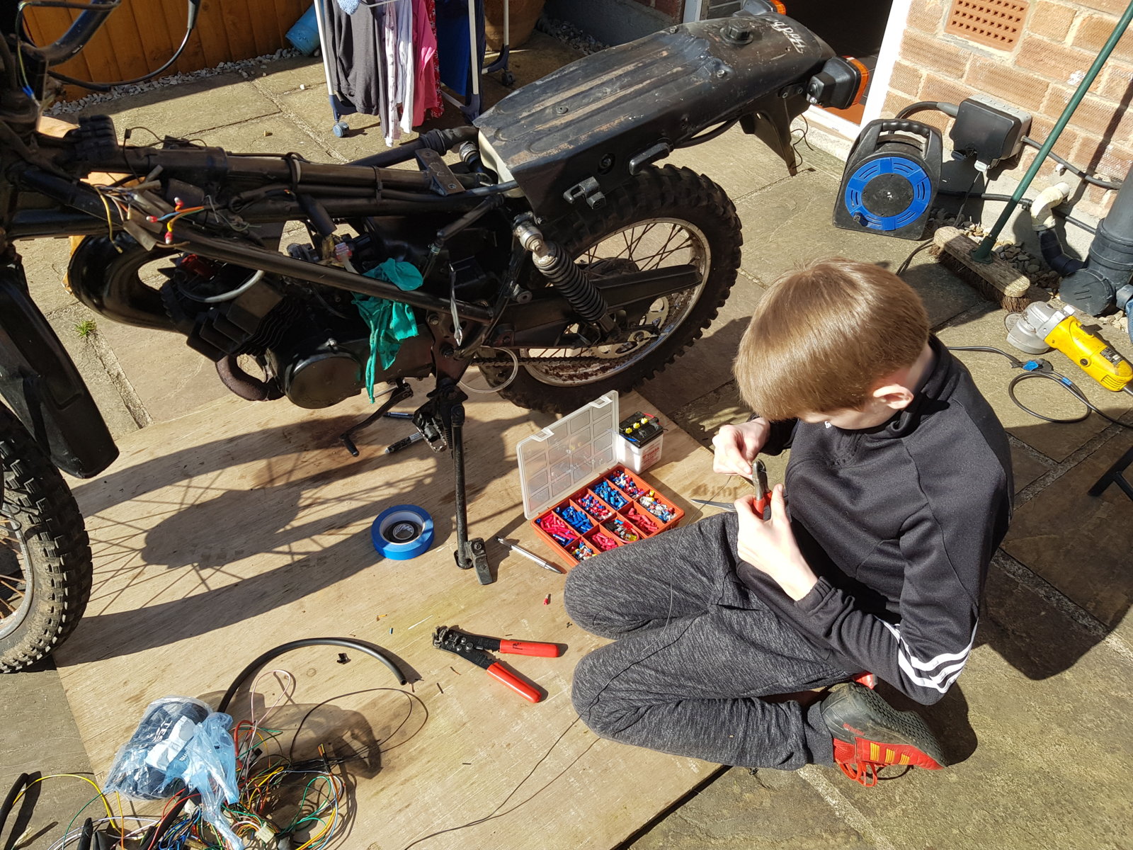

We are building a wiring loom from scratch so he knows what does what, got some bullet connectors with the clear sleeves to look factory fit!.

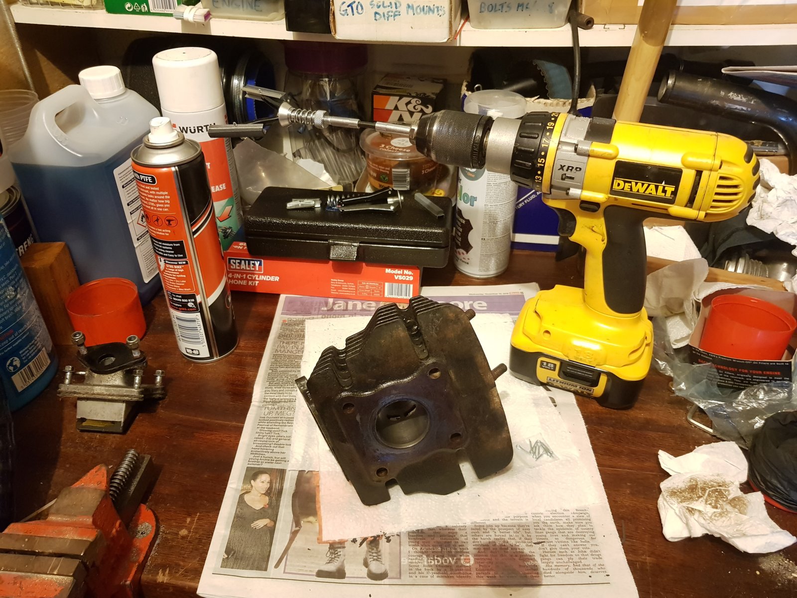

The bore isn’t plated Nikasil or anything daft, is it?
Were there rubber plugs sandwiched between the fins to stop ‘ringing’?

Nah it's a good stout steel liner in the barrel.
I believe the blocks are to stop the fins distorting but could be wrong!.

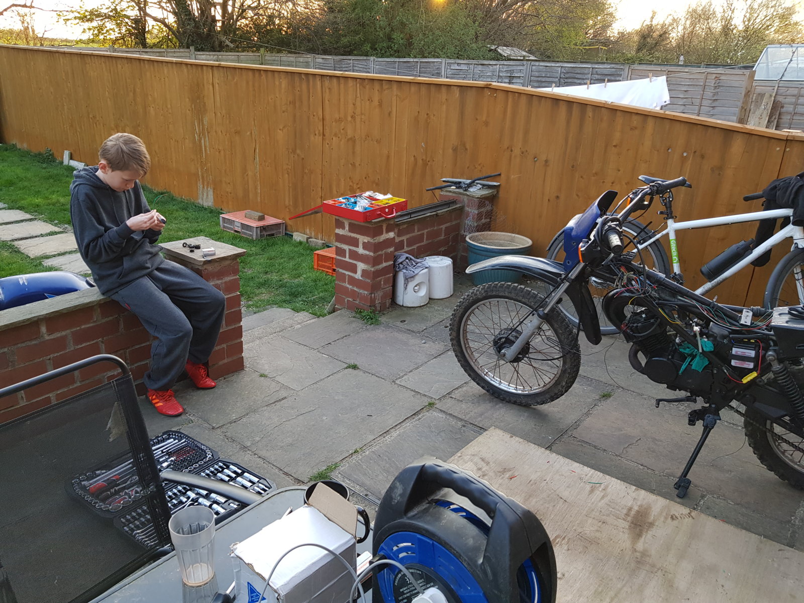

We've built a wiring loom from scratch over last couple of weeks and he's had his first couple of rides down the garden (to get used to using the clutch).
Roll on end of lockdown and we can test it properly!.
What an excellent project! The only comment I would make is to solder all the electrical connecters rather than crimp. I know it is more time consuming, and requires a degree of skill, but once learnt, never forgotten! Best of luck to the young man and his dad!
