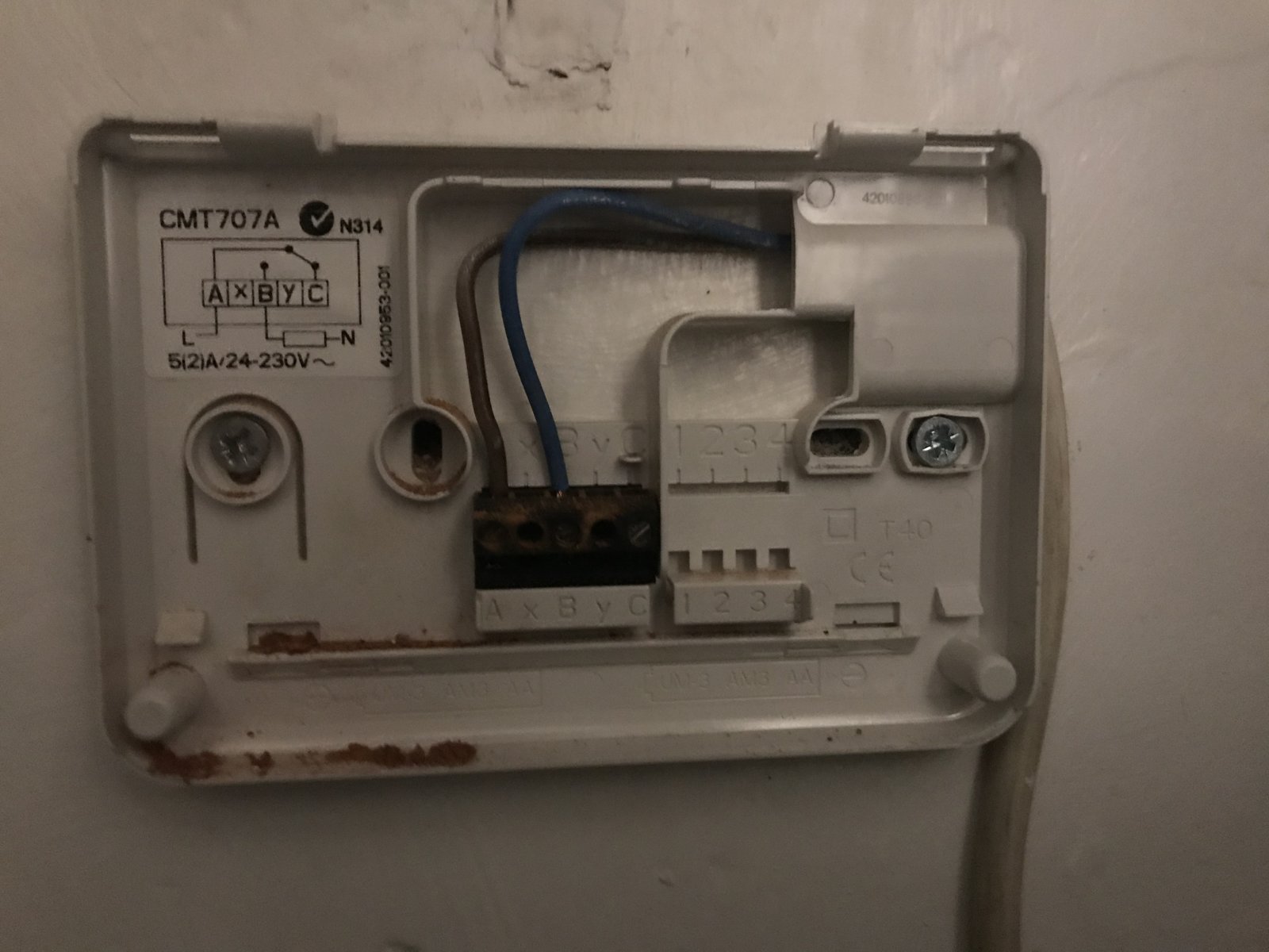

Hi all, I am a year one apprentice who is looking to change the Honeywell CM707 thermostat for hive.
Below are the pictures of the current wiring. I have connected a voltage tester between Line and Neutral at the thermostat and it read 50V. The property has old wiring and everything is protected with cartridge fuses with no labels.

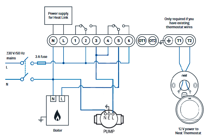

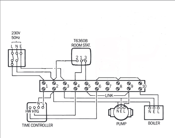

Nest e would work from that point, but not Hive, as @EFLImpudence says one would normally fit the wireless thermostat base at the boiler, wiring centre, or programmer position, with only the sensor at the original thermostat location.
You say old property so possibly not a combi boiler, with old or oil boilers they often switch off/on, with modern gas boilers they adjust output up/down, old and oil had all the storage of hot water out side the boiler, and also pumps and valves outside the boiler, because Hive has the common internally liked to the line in the duel channel version, it can't be used with many systems. Both due to voltage and with very old systems you need the supply to N/C and N/O with the com going to boiler.
To convert this C Plan C-Plan_old2.jpg to work with a smart thermostat needs something like this C-Plan_basic_Nest.jpg but Hive can't be wired that way, to be frank it may work in theory, but in practice in many houses the water will thermo syphon through the pump when stopped, so it would be better to convert the pipe work where one can, I say where one can as old boilers often don't have a run on, so rely on the cylinder having no valve to stop over heating, and so only way to fit valves is the Y Plan as the default is DHW so again some where for the heat to naturally go.

The Honeywell CM707 terminals A & B are simply connected to an internal on /off switch. When the stat turns the heating 'on' the wires in A and B are connected together, when it's 'off' they are not. Various voltages can be used and will come from the boiler directly, but as far as you are concerned the two wires are just connected to a simple on / off switch.

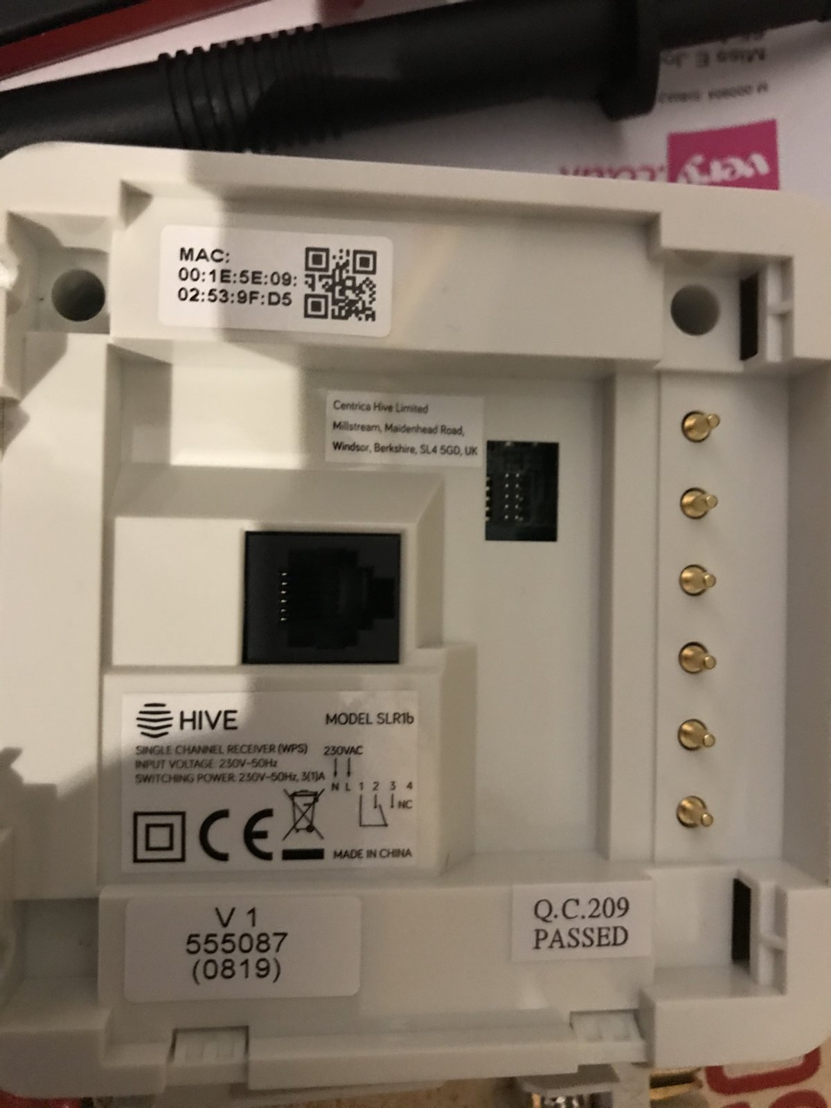

The corresponding terminals on the Hive Single Channel version are (1) 'Common', and (3) 'Heating On'. The voltage doesn't matter because the Hive Single Channel receiver has a voltage free switch, the same as the Honeywell does, so will switch whatever voltage is applied from the boiler.
However, in addition, and as you figured, the old thermostat is battery powered but the Hive receiver requires a permanent 230V supply to power it connected to N & L. This should come via the same FCU supplying the boiler.

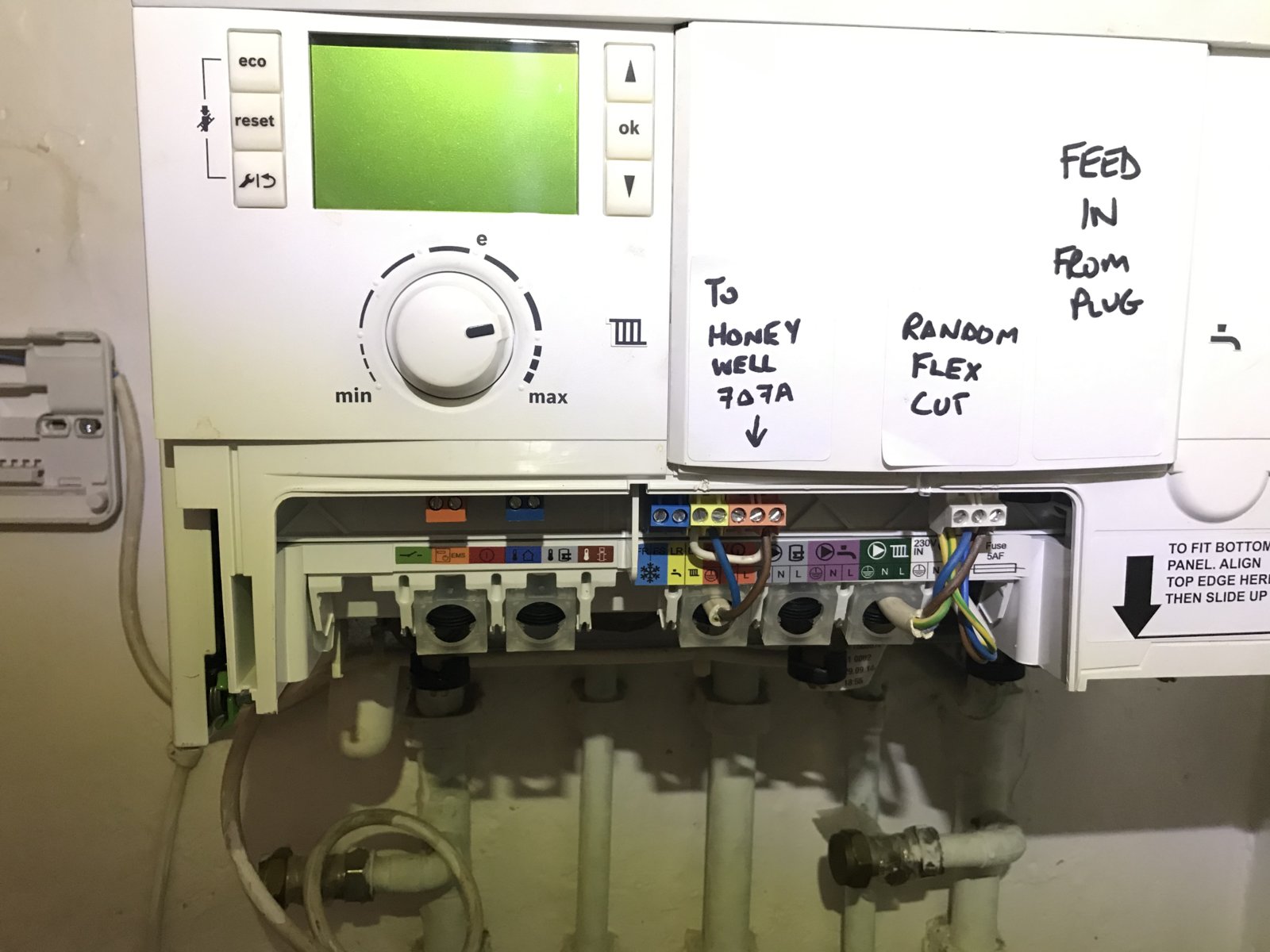

Hi guys I have a little bit more info
The boiler itself is a Worcester Greenstar 30Si
There is no supply that I can see currently for the Hive receiver.
Any help appreciated

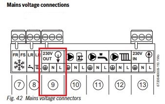

This is the 230V supply for external controls

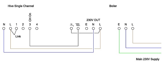

Remove all of the existing wiring to the existing external controls, but not the white link to the tap symbol, then, for a single channel version of Hive:
Hive N goes to Boiler '230V OUT N' [(9) in the diagram above]
Hive L goes to Boiler '230V OUT L' [(9) in the diagram above]
Hive 3 goes to Boiler 'LR' [with the radiator symbol (8) in the diagram above]
Add a link between Hive terminals L and 1.
On another matter, this is the incoming mains supply, I would only expect to see one cable in here. Where does the second one go?
OK thanks. That redundant cable should go then, and you want to end up with this.

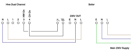

The above is for a single channel Hive. If you have the dual channel version of the Hive, the wiring terminals are different but you can include time control for the hot water, should you want to add this, as per the below.
As combi's provide instantaneous hot water when a tap is opened, most folks don't bother adding the hot water control, but it would stop any hot water pre-heat function working when set to off.
