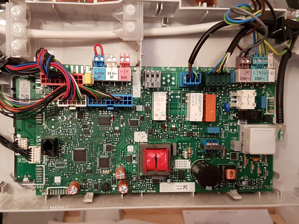

Hi all,
To start off - I am going to say I am new to this side of DIY but happy to dig in so to speak without setting off any alarm bells/fuses etc
As per the title, I have a Valliant ecoplus 837 combi with a currently installed Myson MPRT. The latter is from what I have found out a mains powered stat with 2 backup batteries?
Wires behind it as grey, brown, black and is simply an on/off stat.
Neither of the above are installed by myself or anyone I know - it was with a new build home I bought last year.
The new stat is an Honeywell evohome which comes with a BDR91
Having got into the PCB of the boiler, I have the attached image for you.
Am I correct in saying that the current RT 230V are the black/grey going into the Myson and they are now infact the A and B of the Honeywell?
The other bit to it is power - I can see the L and N on the PCB plug in turquoise and there is no 24v RT Bus used on the left.
Can I feed the L and N to the Honeywell from the Turquoise plug?
ie: put a block and split two wires out for L and two for N plugging one L and N into the PCB turquoise plug as it is now and the other two in the Honeywell?
I also see the "Opt" block in the middle which also stats N L - is that used instead/at all?
Thanks in advance
If it has batteries, it is NOT mains powered. The MPRT is a battery powered device, the mains version is MPRTMS and does not have batteries.
The BDR91 requires 3 wires - L & N for the permanent mains supply and the 3rd one connects the B terminal in the BDR to the RT terminal in the boiler.
You will also need a link from L to A in the BDR91.
You can most likely use the existing wiring, although where it is connected may need to be altered, and certainly confirmed where it actually connects to before using it.
