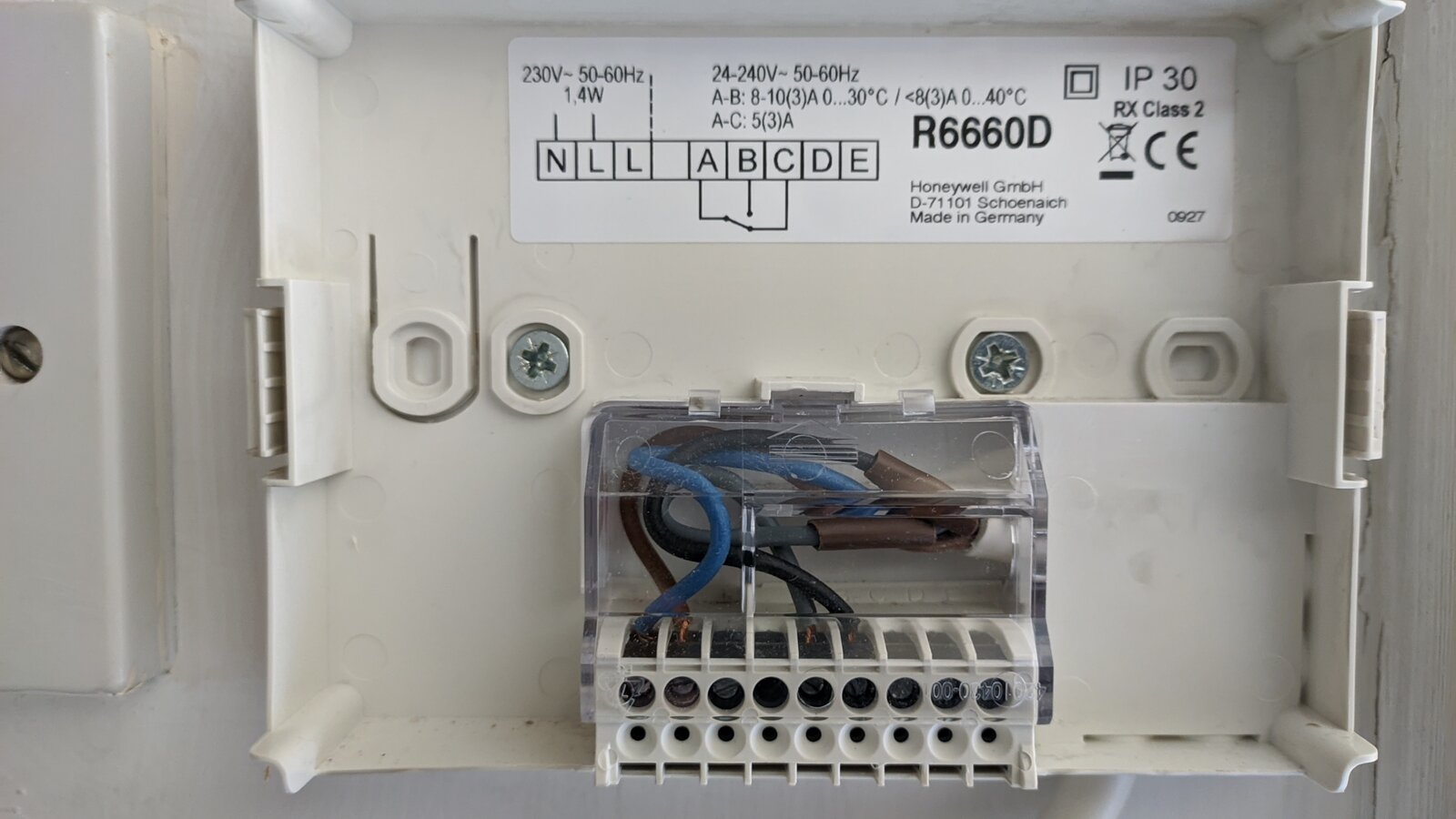

Yes, it would be the ones from A and B, but if you have a linked common, that would need to remain too. Can you post a photo of the wiring inside the relay box?

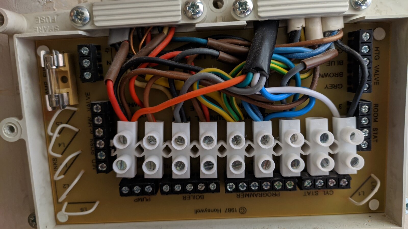

Thanks Chris, popped open the case and have this (the one with the single grey button) The other photo is of the slightly larger blank plate "mothership" it's connecting to.
Looks like I don't have an A, but have the C (assuming same thing), just a process of switching the leccy off, binding those two for the moment, and control on/off at the wall using the manual controls when required?

Yes, they must have changed it years down the line, as they’re a and b now. It will still work by putting the black wire in with the grey, but as per your username switch the electric off first as it’s mains voltage indicated by the brown sleeving. Yes, just have to turn off when toasty. You can probably swap it once you have a new thermostat, but this will should get your heating on for now.

Done!
THANKYOU!
Couldn't get them in the same connector, so threw them in a wago unit
