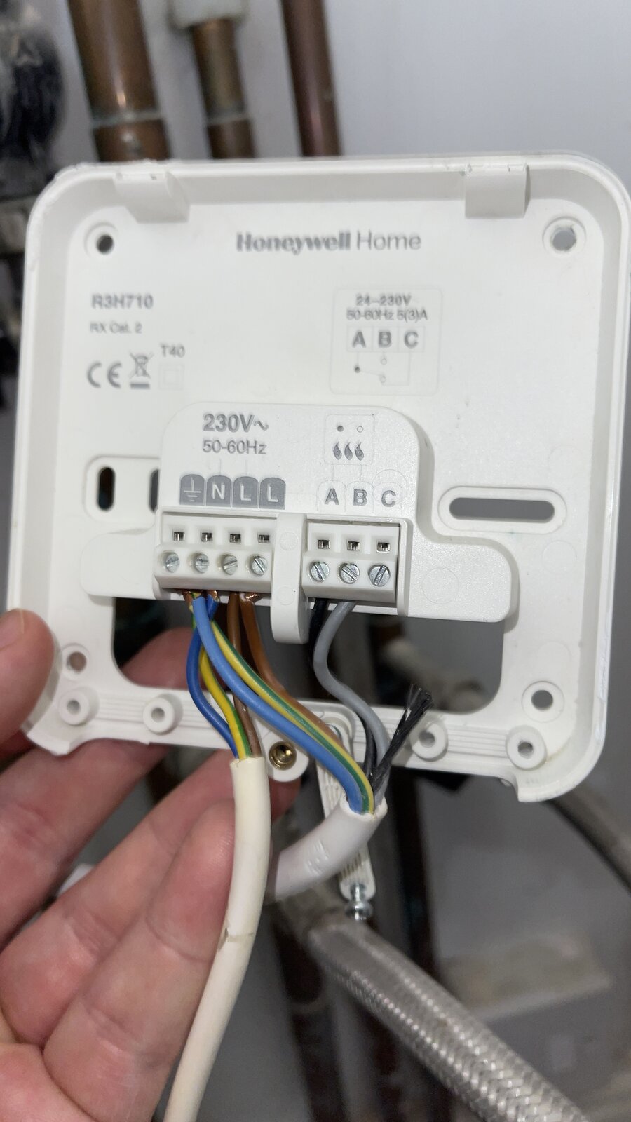

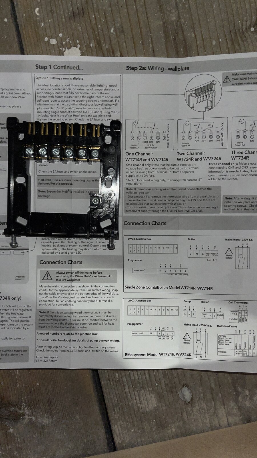

Hi
First post. Looking for some guidance on the subject.
Got a Honeywell R3H710 and would like to move to Drayton Wiser. Single channel. Combo (Ideal Eco 2).
Any guidance on moving the wiring over would be appreciated!
Thank you in advance!

Boiler make and model and how is it wired?
Honeywell looks like 'volt free' contact switching on A and B to the boiler heat call input, not looped mains.
Wiser is mains switched to boiler call for heat so may not be suitable? {Or boiler wiring may need altering to suit?}
The single channel Wiser can be volt free switching, just leave the link out.
Doh! Of course it can! (looking at the install leaflet again).
Then OP just needs all earths to the earth terminal, all Lives (brown) into the Wiser L terminal, all neutrals (blue) into N and move A and B into COM (1) and ON (3) respectively.
Simples. (Mains off first of course).
Boiler make/model may still be relevant if it is Opentherm compatible.
