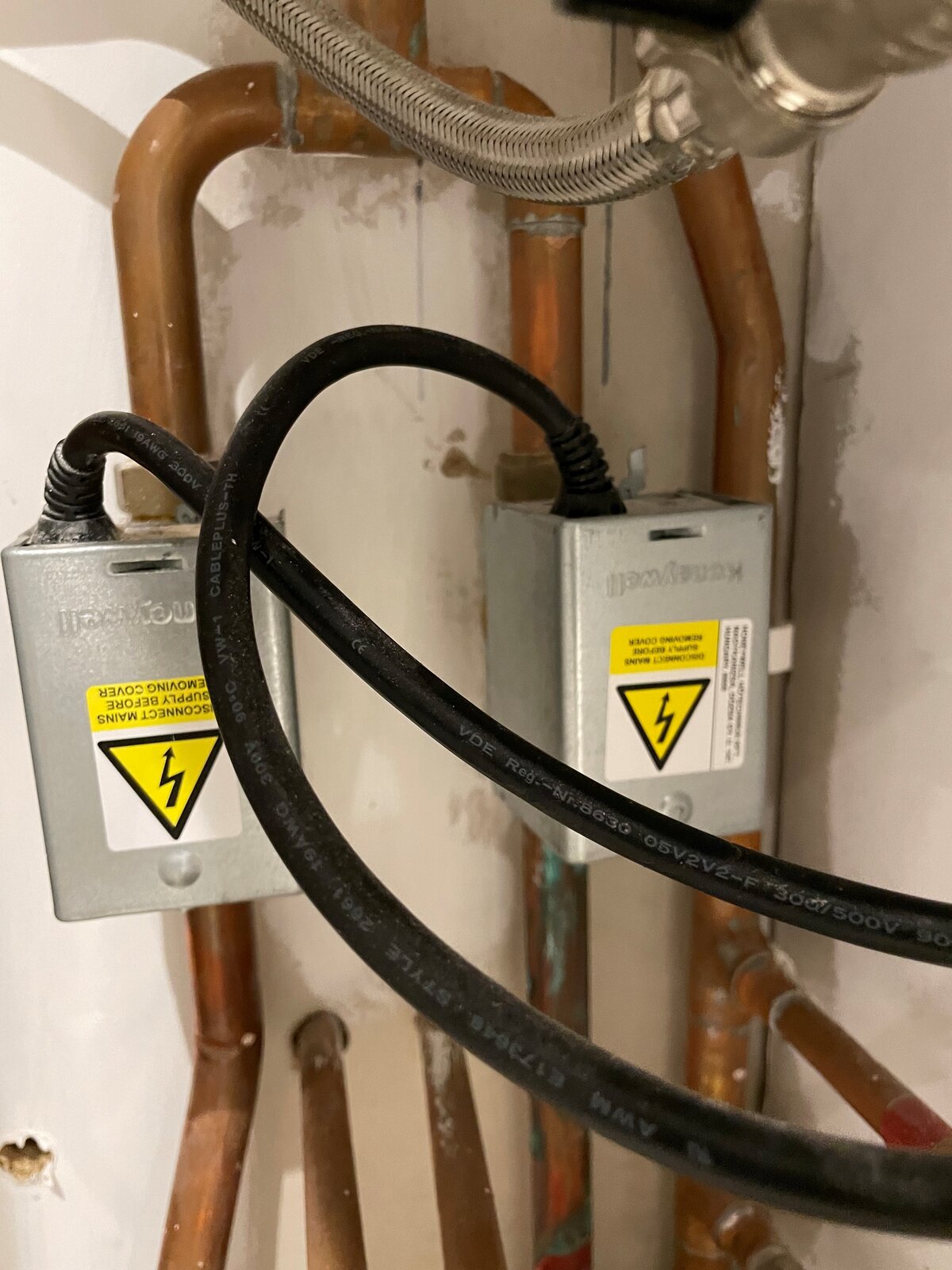

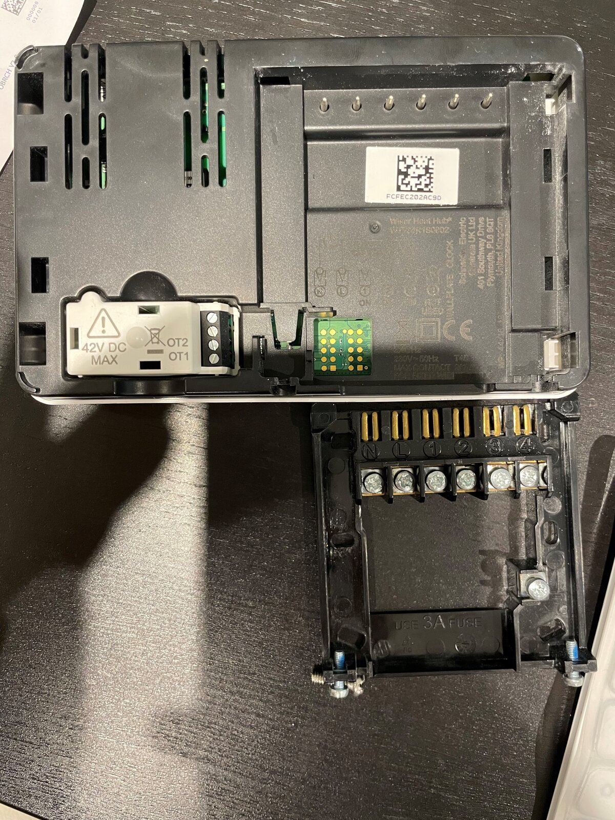

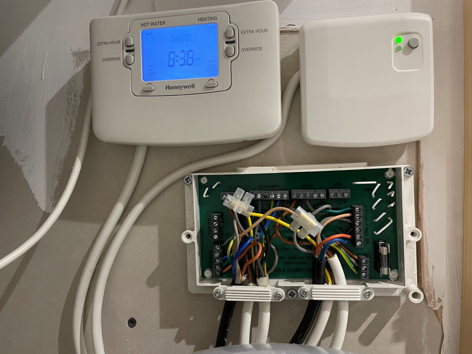

Hello, moved into a place that has Honeywell for heating fitted (don't know model number) - there is 2 zones for heating... I am trying to find out how to map from this to Wiser Drayton... Would really appreciate your inputs, planning to switch over Friday this week.

You might be able to just use the same back plate as what’s on the Honeywell and clip the Wiser onto that.
You have a wireless receiver fitted there, that will need to be linked out/removed
Are you sure you have two heating zones? From your photos It looks more like one 'Heating' zone plus Hot Water'
Aha is there a way to identify if these are two heating zones or just one heating zone + hot water?
