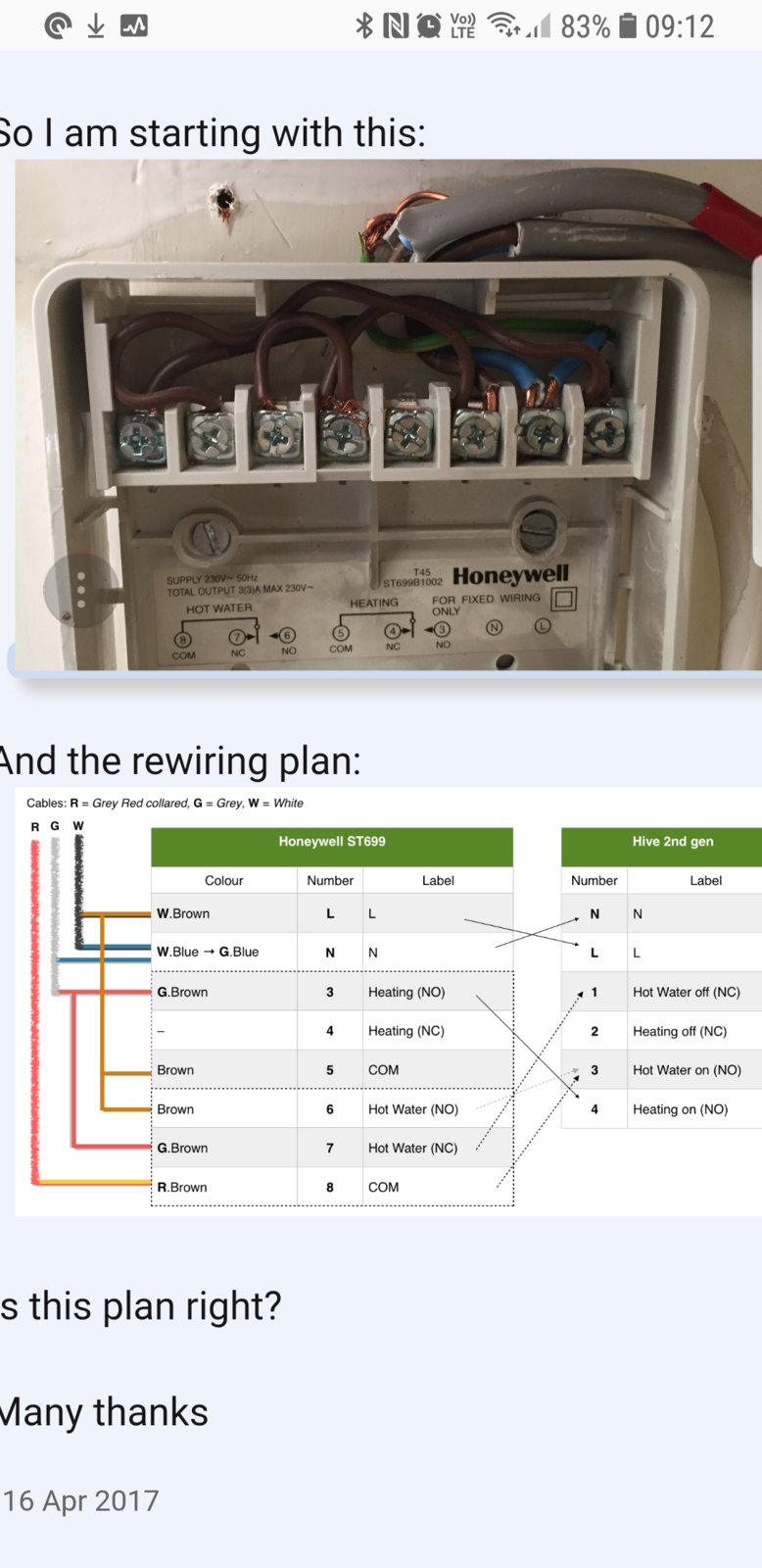

Hi I recently installed the hive to replace my honeywell st699 as per the attached. I did the 8 to 3 like the solid dotted line rather than faint but when I press hot water only it does not fire the boiler. Is this because my baxi megaflow does heating and hotwater together hence the com wires. Does anything need changing or should I just use the central heating setting knowing its always heating the hot water. Any help greatly appreciated. Dan 07814464894
The Honeywell in your photo is wired up in a manner that is normally associated with heating systems that don't allow independent control of the hot water and heating (ie those where the plumbing restrictions mean that it is not possible for the heating to be 'on' without the hot water also being 'on') Normally wiring like this is seen as a bit of a fudge and is usually associated with antiquated systems that have pumped central heating and hot water system that circulates by gravity. I've never seen this set up with Megaflo.

The wiring can be reconfigured to provide the same outputs from the Hive as are presently provided by the Honeywell.
From your photo, the Honeywell looks to be wired as below. I haven't shown the connections to N & L as they are the same for both. (With the exception of the link wire fitted to the Honeywell L)
Connecting & configuring the Hive as below will provide the same live outputs that you have now:
However, you also have a Megaflo, which are not suitable for gravity hot water circulation and they come with their own motorised valve, so I suspect the Honeywell is only part of the story and there is a bit more going on.
The above configuration will replace what you have now like for like, but will not give independent heating and hot water, so it would probably best to get an expert in to advise you on the best way forward.

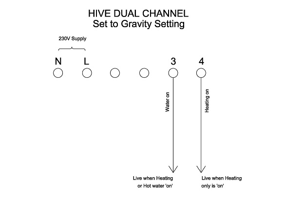

Thanks for the update. If you do decide to go ahead as it stands, get rid of all 3 of the brown links and then swap over the remaining wires:
Honeywell N to Hive N
Honeywell L to Hive L
Honeywell 8 to Hive 3
Honeywell 3 to Hive 4
Don't forget to set the Hive to gravity mode.
Then it will work as it does now [hot water only, or heating and hot water] You can still upgrade later if you wish.
Thanks Dude, its wired up the way you said but just hot water not working in isolation as we expected. Didnt need gravity mode as I think its a fully pumped system. Shame its not as simple as bridging connections like the honeywell.
You do need gravity mode, which just describes the method of switching. The Honeywell you had was manually configured for gravity mode using the link wires. That's what they were there for. Gravity mode just provides two outputs. It can be used with a pumped system, but doesn't provide independent control.

Swapping it for the Hive should have done exactly the same thing, but does need to be set to gravity mode as the Honeywell was.
Hive in gravity configuration
1. Hot water only (Hive terminal 3 live)
2. Hot water & Heating (Hive terminal 3 & 4 live)
Hi stem, thanks for your help. Put it into gravity mode and works perfect now. Hot water can be run independant to the heating.
