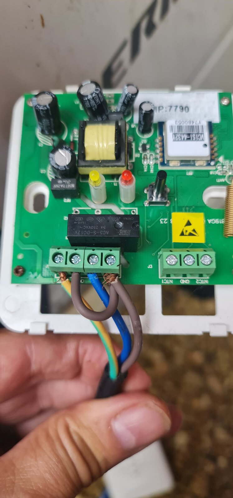

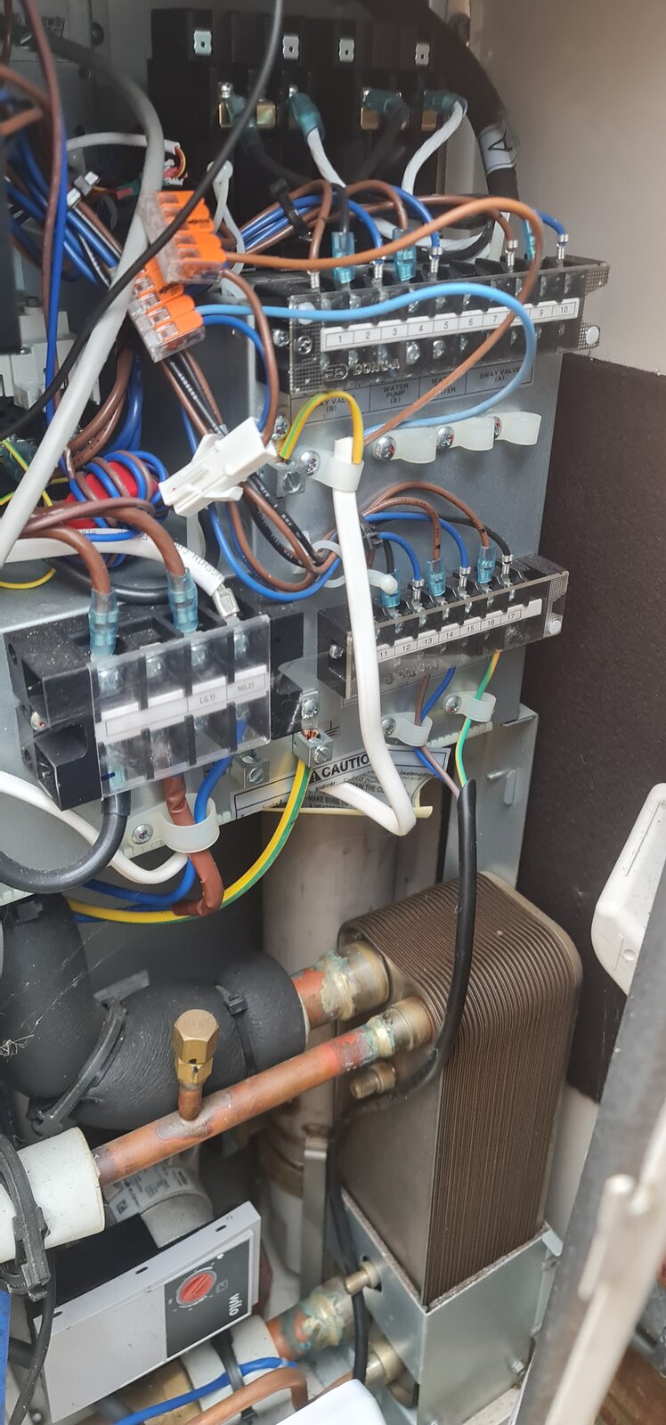

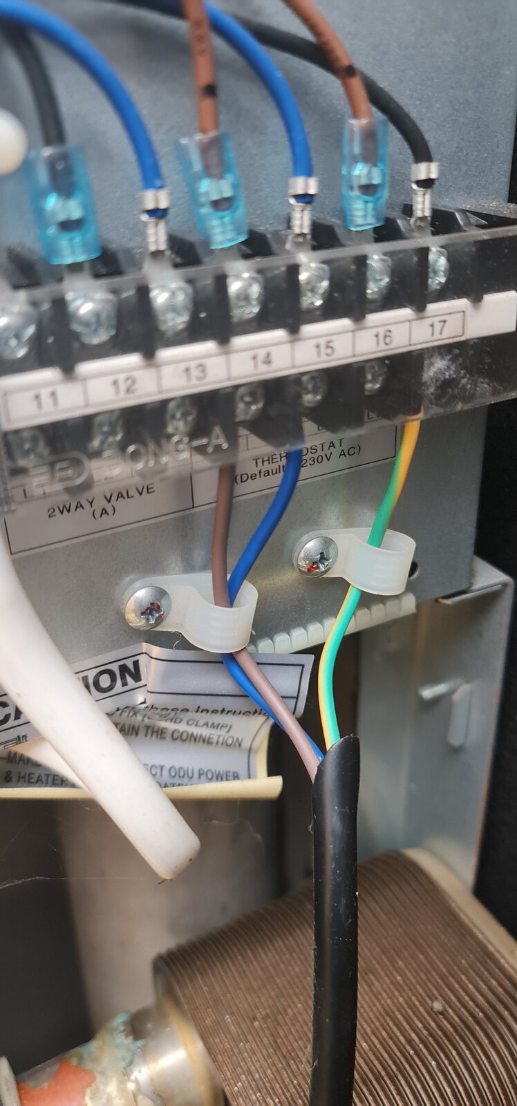

Looking for some guidance
Lg Therma V heat pump had an optima wireless programmer which died
Want to replace with a T3r
Wired the same way earth neutral and then live with live bridged which work but there is no Neutral to switch
Some photos
Not my wiring !!!
I assume it just needs a neutral back to a perm neutral inside the LG
Anu guidance appreciated
Sorry, I'm not really sure what you mean about no neutral to switch?
If the Optima was working then wouldn't its neutral have been attached via the blue wire?
You could really do with a four core cable, it is no longer permitted by the regs to have a green/yellow wire as a switched live.
The cable clamps should also be used!

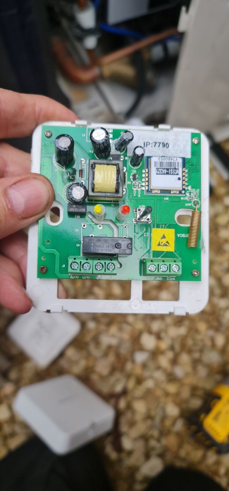

This is what I found when I opened the optima remote unit
I agree about the 4 core cable

Should there not be a neutral running to the right hand connector
Can you take a picture of the white writing under the wiring and terminals of the Optima?
I suspect it will say something like NO, COM, N and L.
With the Brown going to L and a link to COM.
The Blue going to N
And the green/yellow isn't an earth connection, but is a switched live going to NO.
If you replicate that wiring on the T3R, as in your last photo, it should work.
No, there shouldn't be a neutral to the right hand connector.
The Blue going to N

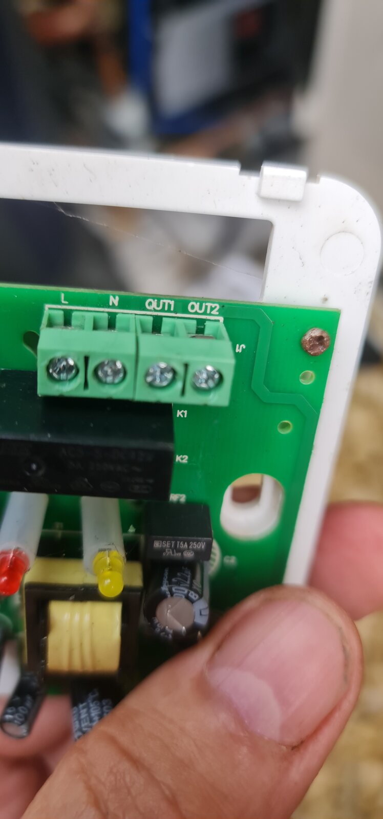

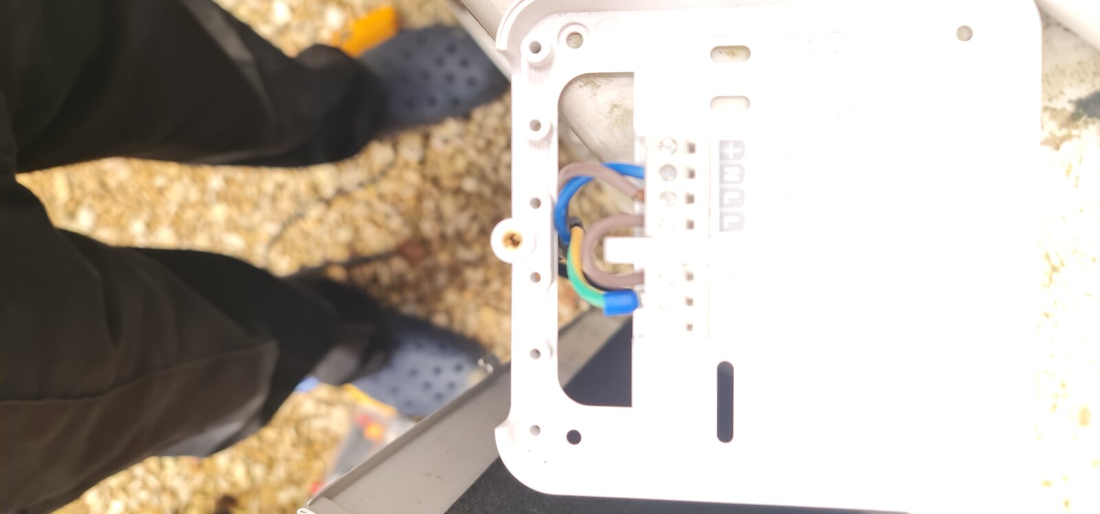

Pics as requested
I only have 3 wires coming in
The old board is labelled
N
L
OUT1
OUT

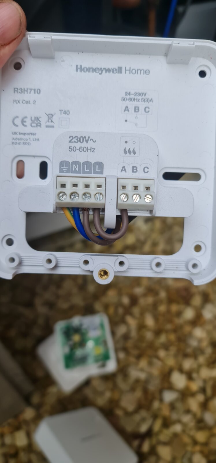

Last pic is the T3r
Again, the green/yellow wire isn't an earth connection.
As it was in the Optima, it is a switched live - it will connect to the T3R terminal B.
This is why you need a 4 core cable...

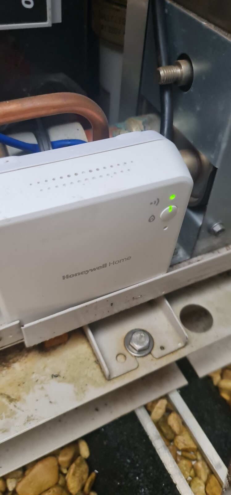

So conne ted the switched terminal ro B on the t3r
Wireless conne tonight is working as when I call for heat the t3r clicks and says on but nothing happens on the heatpump

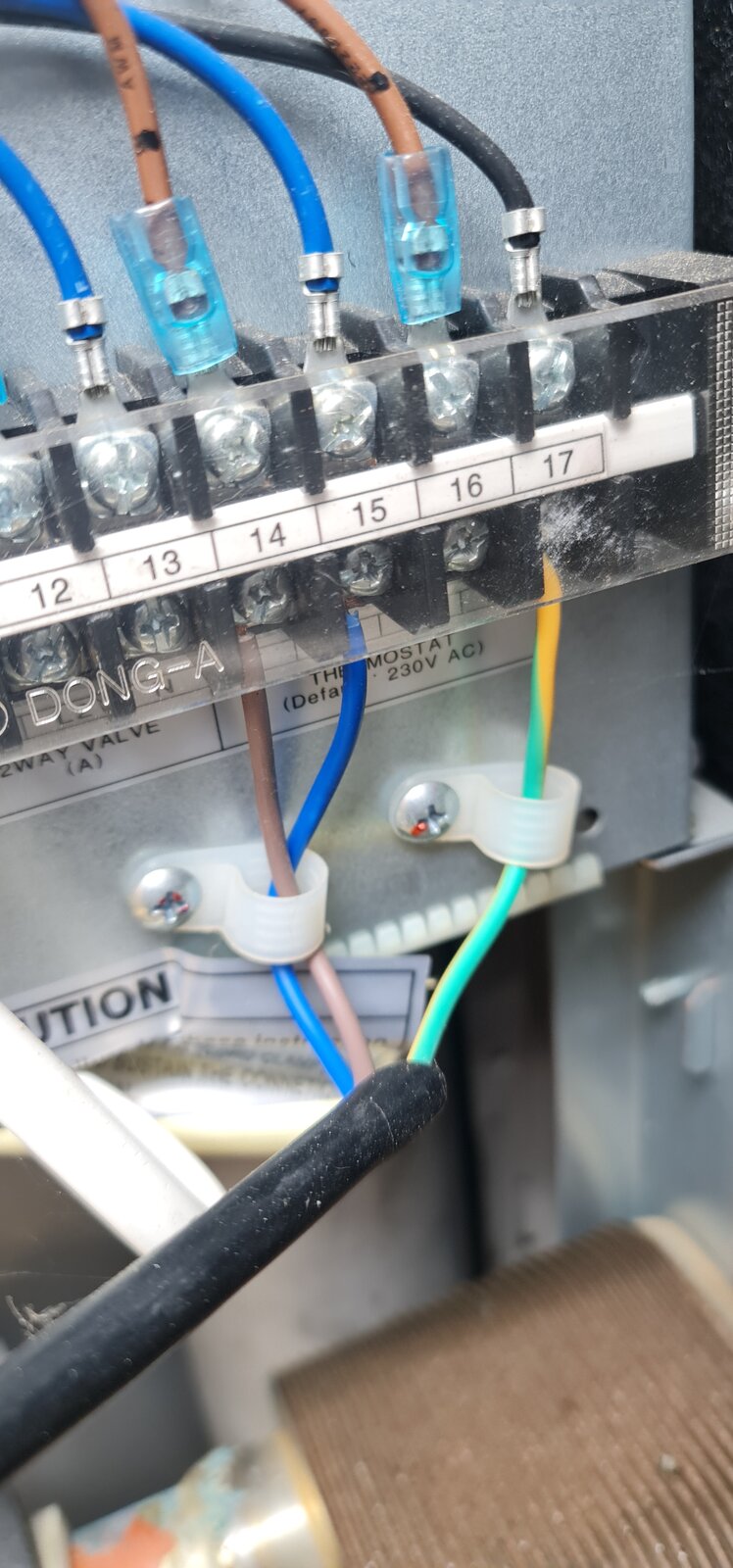

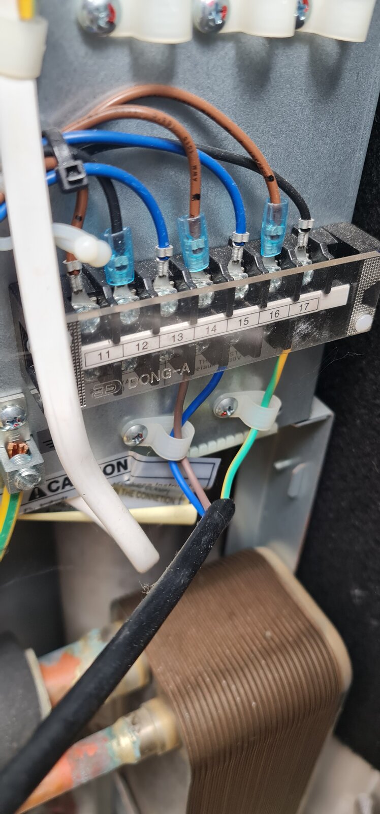

Live conneted to terminal 14
Neutral to terminal 15 and what was connected to earth on the optima is connected to 17
Thanks used his video
Had to change the cable as was using green/ Yellow as switched live
No have 4 core cable with new connectors crimped on and labelled correctly

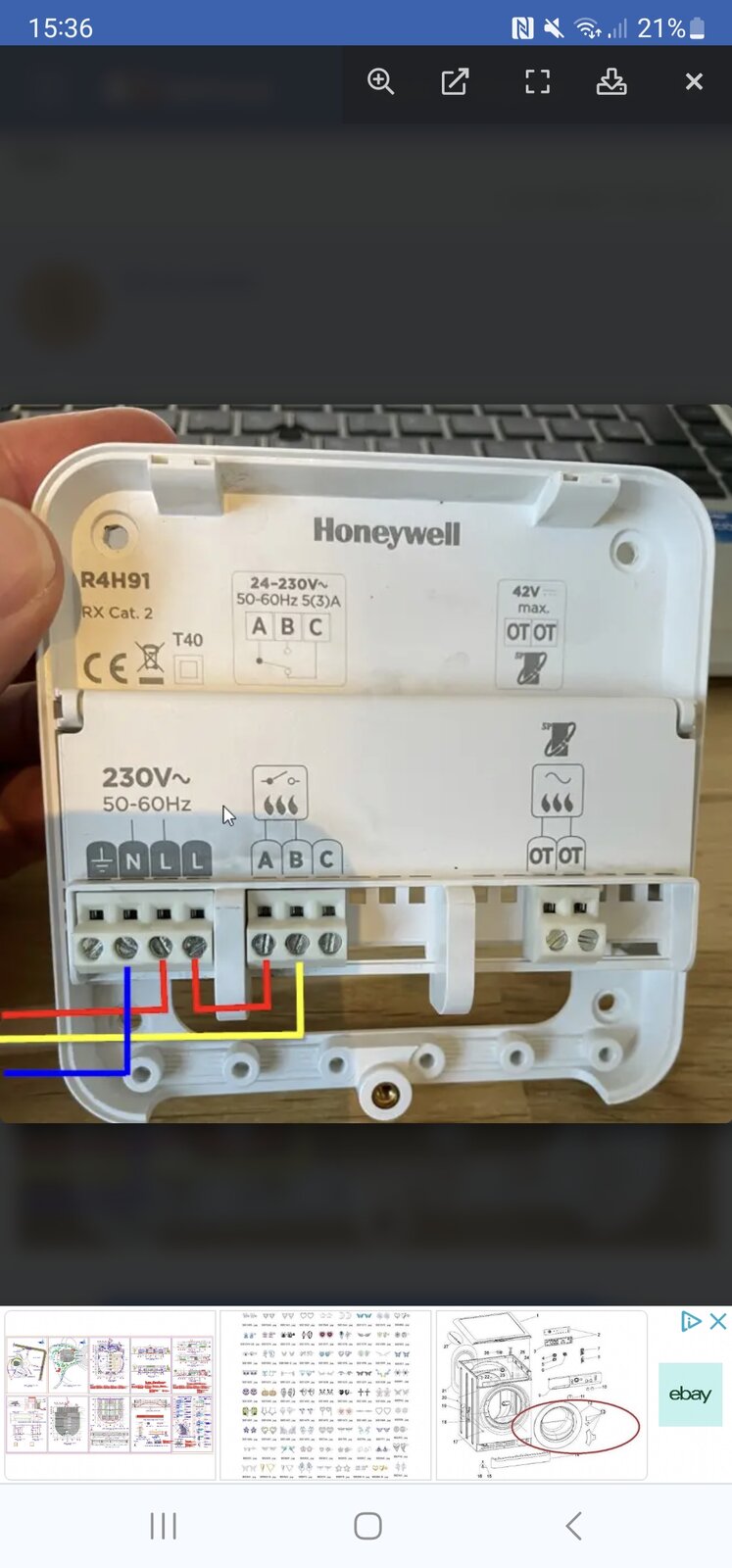

Regarding the T3R base unit wiring, this video may be of use.
A relatively decent video :)
Although he does use some incorrect terminology i.e. calling a cable, a wire, then using low voltage, instead of extra low voltage, etc.
He says all mains cables should have an earth connection, which isn't true - the units are double insulated, so could be supplied by a two core flex.
It is also permissable to only have one of the cables earthed, as long as both cables connect between the same components; the way he connects the earth's together in two cables going to the same place, could possibly create interference problems.
But in my opinion, his worst offence is a breach of the regs by not identifying the line conductors; the blue wire he uses for the switched line should be marked (ideally oversleeved) in brown.
