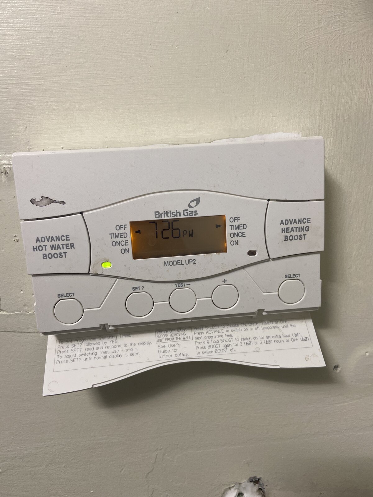

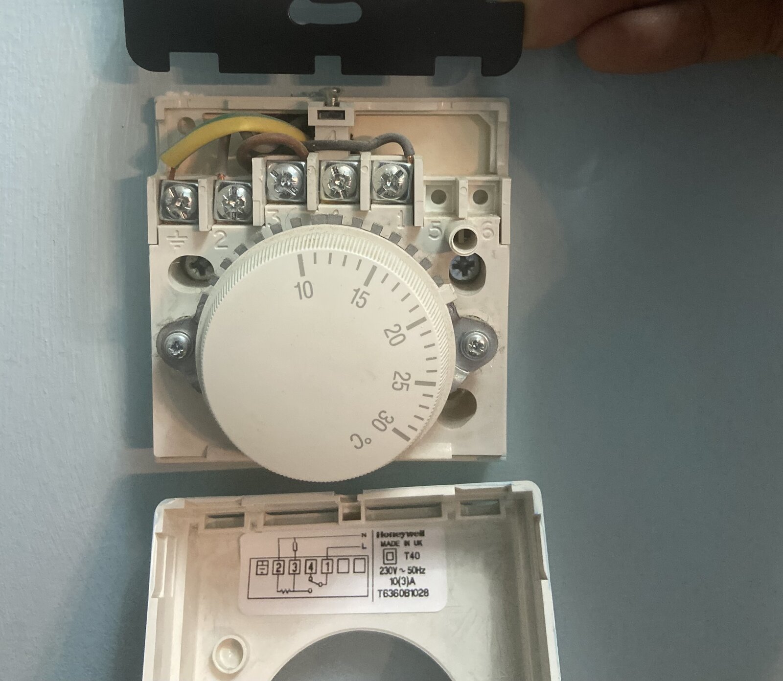

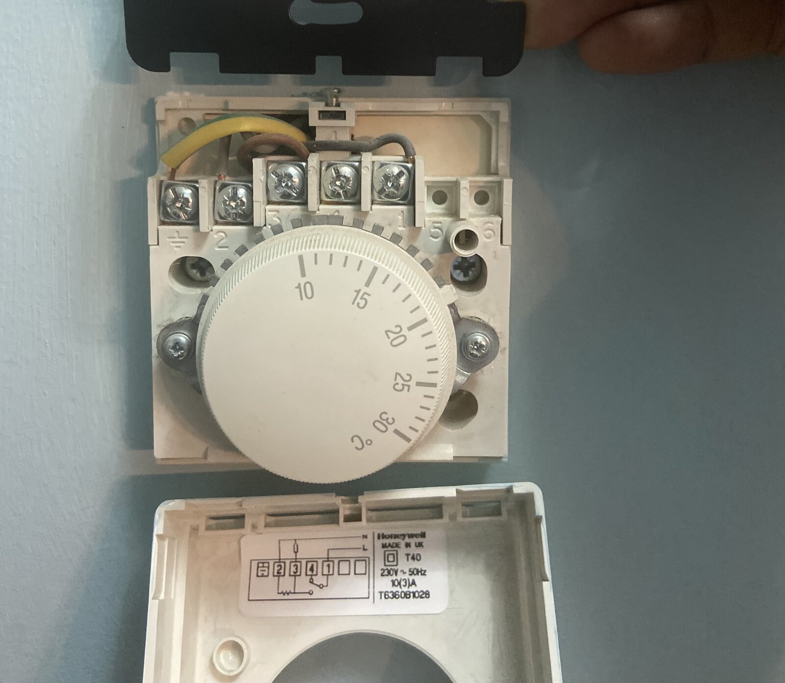

Hi, I’ve got Honeywell old thermostat and looking to replace with a wifi one for remote access. Any advice which smart thermostat will be suitable replacement that will work with this wiring and is for a reasonable price?
Please see the picture of the current.
Many Thanks in advance!

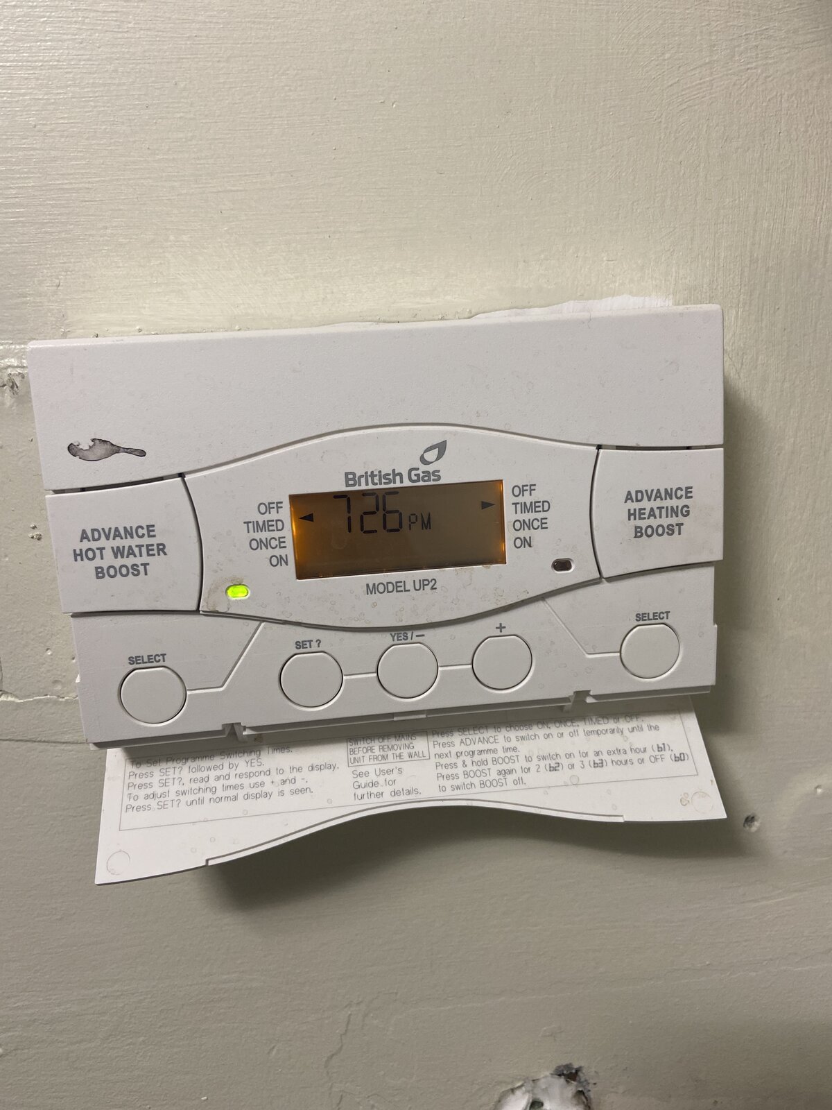

Thanks mate for responding, I’ve got Logic Heat 15 Boiler (not combi) and this controller. Thanks

thanks, but replacing the main unit is all fine but the thermostat is not taking any wires, as simply connects wirelessly. so will it mean the current Honeywell rotating thermostat wires become free? As I believe no as how it will make the circuit complete?
Just to clarify. You want to keep the existing time controller, but change just the thermostat to one that can be controlled remotely?
Some of the above suggestions assume you will be changing the time controller too. Please clarify before we mislead you.
Or to place that into more context...
Your time clock is a ubiquitous BG/Drayton programmer - it fits on an 'industry standard' backplate.
The Dual channel Hive, or Drayton Wiser have been suggested, because they will slot directly onto that backplate and work, with no need for any further wiring (they also provide the smart stat capability you want and remote control of the HW times).
However, you are correct - something will need to be done with the existing stat.
The simplest solution is to turn it up to maximum.
Alternatively, it can be bridged out, either behind the stat, or traced back to the wiring centre, or programmer.
If you only want a smart stat to replace the existing (keeping the BG programmer), it appears you have a neutral connection at the stat; this should give you a wider choice of replacement stats.

thanks for all responses, basically I simply wants to replace just the thermostat to have the ability to set temperature remotely. Thanks
