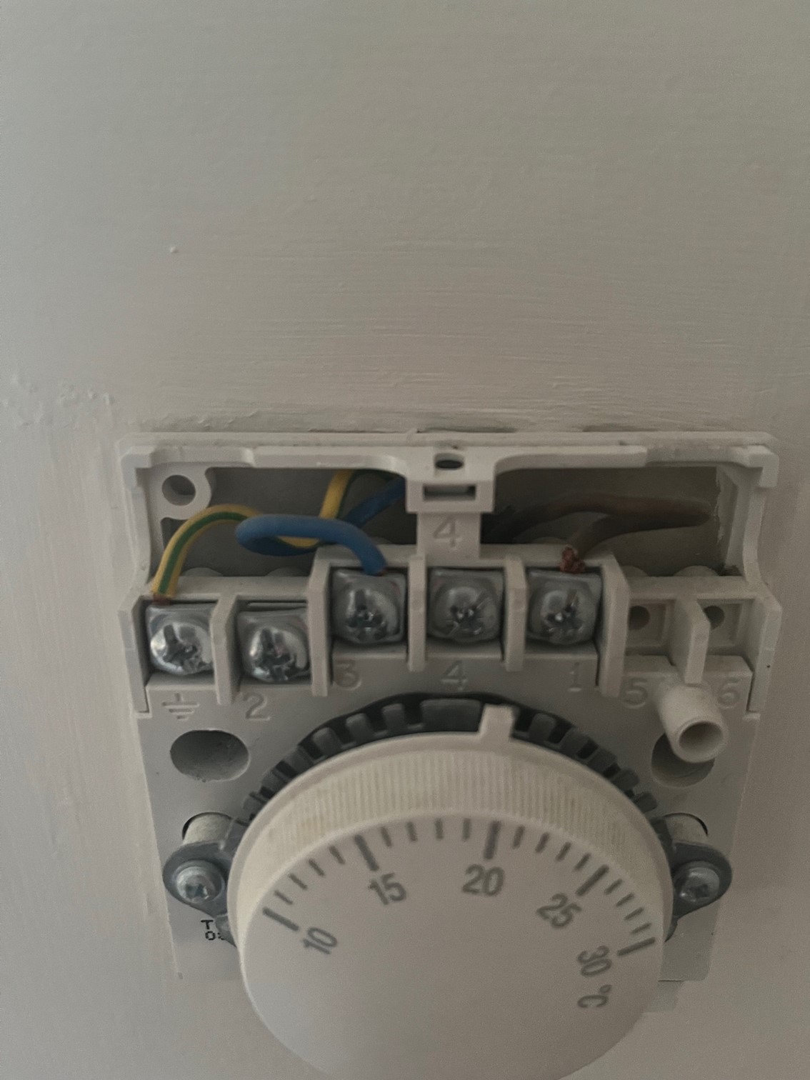

Turns out, I already had a photo of the current Honeywell thermostat already:
Looks like, live, neutral and earth?
I found this smart thermostat which looks to have good reviews on Amazon.
I read talk of bridging COM & live, how would I know if I need to do this?
Cheers
Afraid not, its a Live, a switched Live (in blue) and an earth connection.

Yes, a wired Tado is battery powered and would be a straightforward swap for your two wired stat.
Although providing a Neutral connection to a mains powered stat, may still be a simple option, depending on what's behind the ST9100c.

So easy to do, Switched Live and Live into NO & COM ports respectively, docked the Earth cable into Parking port.
Honeywell programmer stays on and everything is now controlled either on the thermostat itself or via Tado app, or even Alexa. Perfect for what I wanted.
I did find that the boiler, thermostat and bridge needed to be cycled to get everything working as expected, as I found even though the thermostat called for heat fine, it did not stop the boiler initially, even though the thermostat clicked when turning temperature down, even the light on boiler went out, but it kept running.
Rebooted everything and now perfect. Technology huh........
