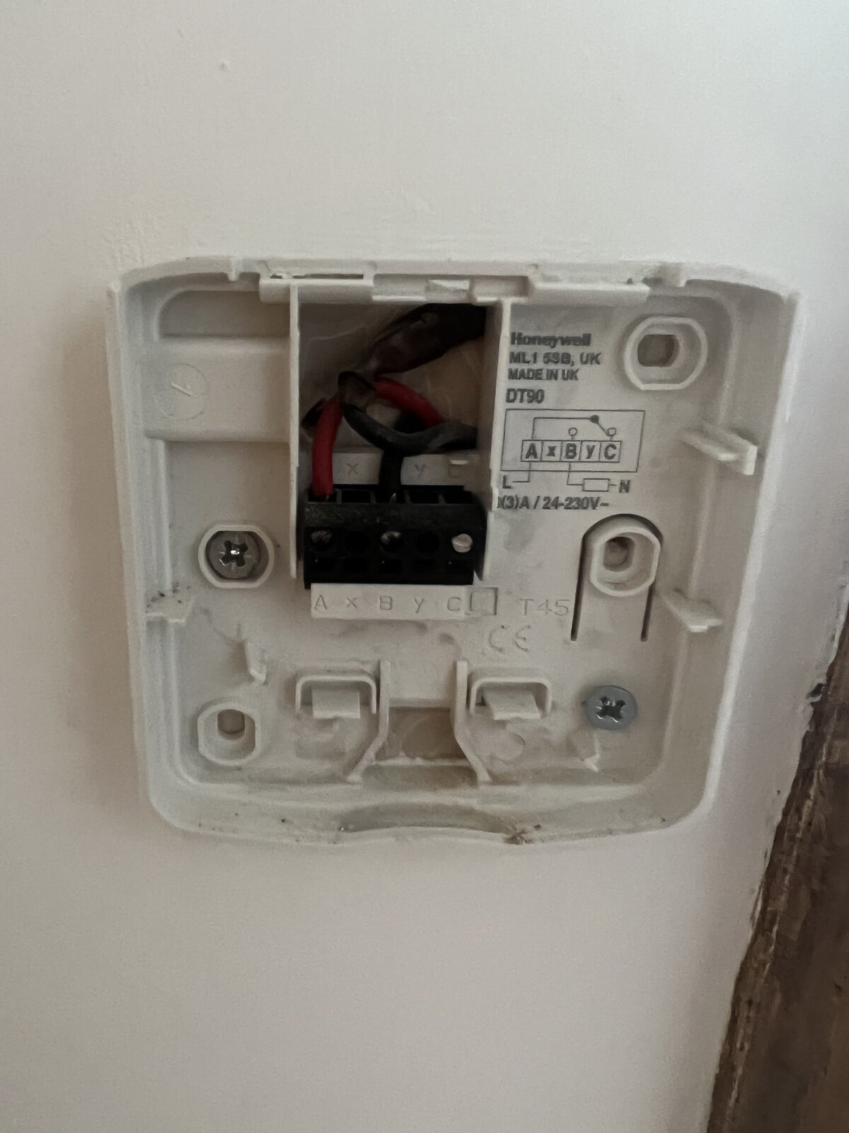

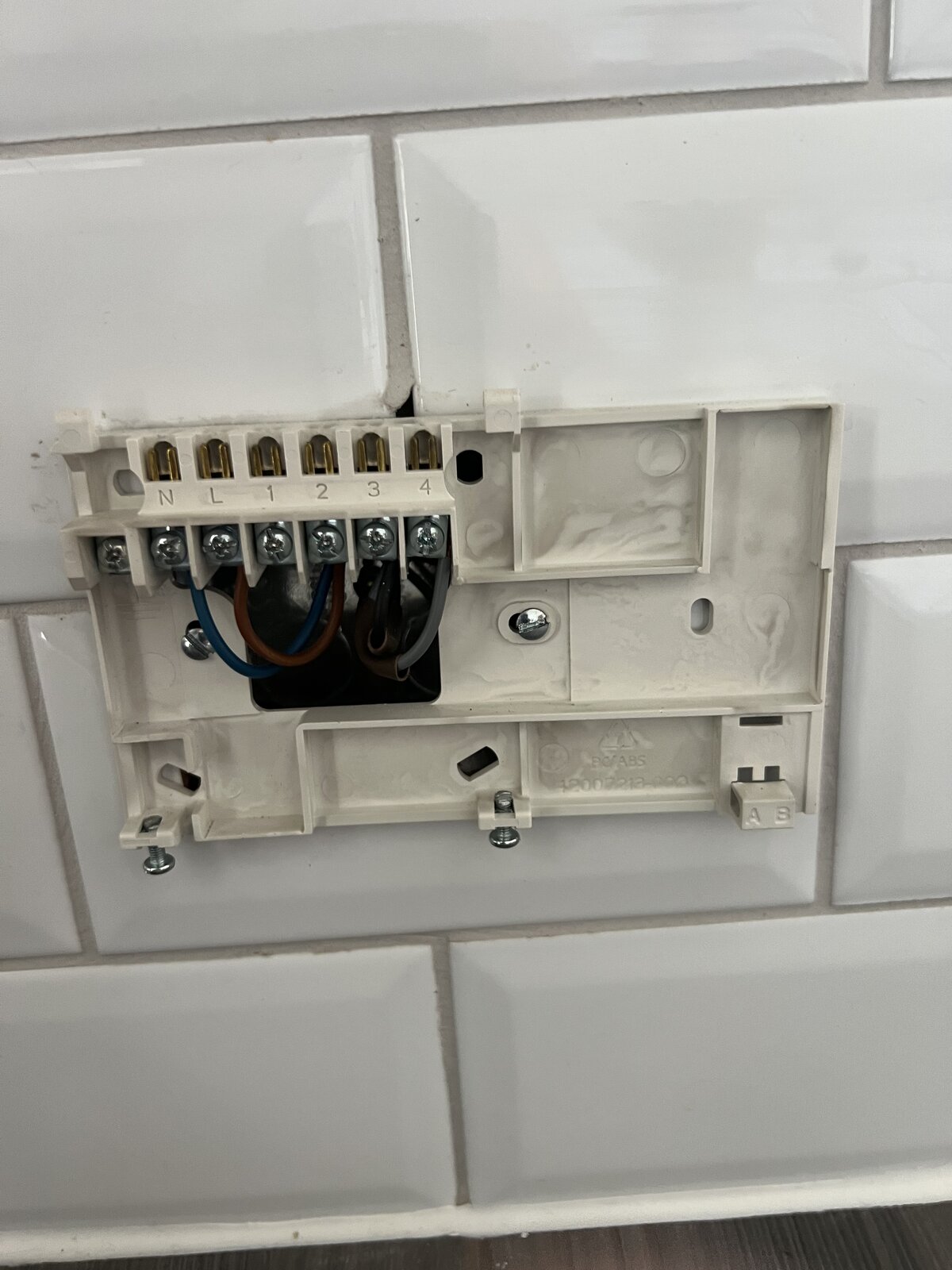

This is the current wiring set up. I guess if I chose to replace with either a hive or evohome (which seems a further step up in ‘smartness’) - it’s a relatively simple change for an electrician?

Should be easy enough to do, doesn’t have to be an electrician, a decent heating engineer can do it.

Can anybody tell if this thermostat is low or high voltage from the picture alone?
