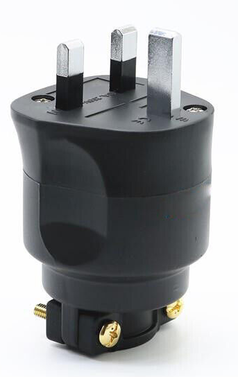

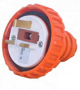

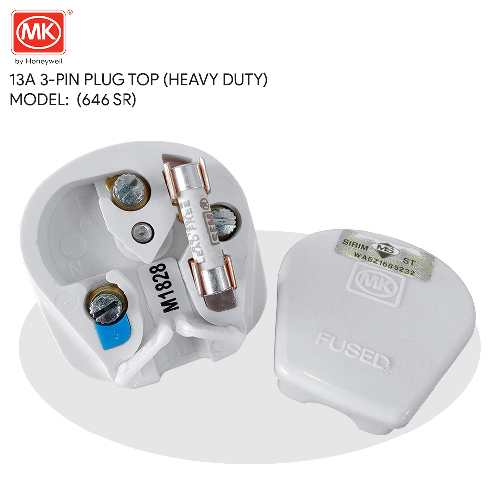

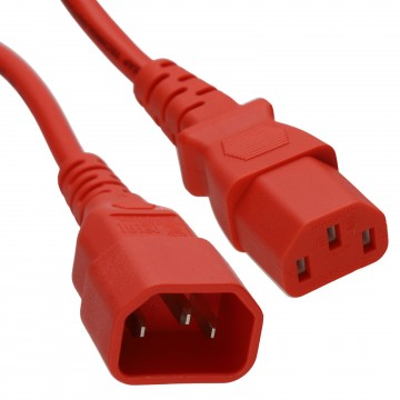

If the cable is trimmed to length, then if it did pull out, the machine would stop. So clearly not made off correctly in the first place. I do prefer a grommet to increase the curve under strain 1682769950873.pngbut be it a air volatility cleaner or a lawn mower having a pair of these 1682770143243.pngmeans any tug on the cable and it auto disconnects safely, as long as the outer is not screwed in these 1682770367756.pngdo the same, or these 1682770754420.pngthere was a rubber version for use outside, but I think technically not permitted to have cable out in this way! But the worry is if the cable can't pull out, what happens to the socket?

MK plugs have plastic slide-in cord grips...
But the cable really shouldn't be able to come out of the screw down clip in your plug, as long as it is undamaged and properly tightened.
