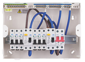

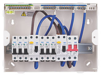

Can I familiarise myself with one of these by using a flex from a socket to mimic the incoming power?
https://www.screwfix.com/p/british-...d-high-integrity-dual-rcd-consumer-unit/216px
I would then want to have a basic ring main and lighting circuit to understand how it all hangs together.
Once I have it working with MCB + RCD, I’d want to install some RCBO.
Wanted to check whether that plan racks up before I purchase the CU. Thanks in advance.
Are you intending on eventually fitting this as the main consumer unit for the house, or is this simply a 'test rig' for your own use only?
Although it's described as high integrity, there are no unprotected ways where you could add RCBOs.
You wouldn't fit RCBOs on the sections already protected by the RCDs.
You could adapt the board accordingly, with bits of bus bar and tri-rated cable - since it's only a test rig.

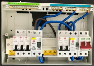

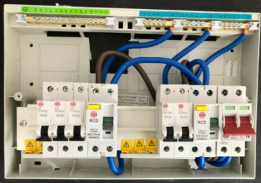

As its only a test rig, there is no real need for it to be a metal consumer unit, and there are lots of cheap (and secondhand) consumer units on Ebay. A Wylex one going for around £16.50, for example.
I do some times wonder who buys the CU you linked to?
2 x Type A 63A 30mA RCDs
6 x Type B MCBs (2 x 6A, 1 x 16A, 2 x 32A & 1 x 40A)
Why only 63A RCD's, and no SPD, a RCBO costs £16.32 each, a MCB £3.86, a RCD £12.25 so with 6 circuits RCBO = extra £50.26 only have to loose one freezer full of food and you have spent well over that.
We are told we should fit a SPD as standard, and only if the client says they don't want one should it be omitted.

Will the CU I linked to allow me to upgrade to RCBO’s, use a SPD and importantly, feed from a flex plugged into a socket?
Want to use this as a test rig.
That BG dual RCD cpnsumer unit is NOT what I would consider 'high integrity'.
My definition of high integrity should be 3 neutral bars and 3 busbars, allowing
1) a row of non-protected ways (in which RCBOs can be fitted, allowing individual RCD protection.
2) a row of protected ways, protected by RCD 1.
3) another row of protected ways, protected by RCD 2.
This is the ideal cu to get, as everything bar the RCBOs will be provided.
It will be a good test rig with RCBOs AND 2 RCDs (RCCBs) as you will be able to see exactly what happens if you get a mixed up neutral (or even two mixed up lives on a 2 gang light switch on a lighting circuit fed by two different RCDs).
The cu you are looking at is over-priced for your needs, and doesn't offer you genuine 'high integrity' options to play around with. You would be forever dismantling it to be able to simulate real-life faults.
Have a look on E-bay for something cheaper and better.

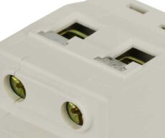

On the bench it is easy to fit RCBO's and MCB's to a consumer unit, the terminals
either have a section which lifts up to clamp the wire, or a plate when goes down to clamp the wire these will naturally fall open when the consumer unit is flat on the bench, however on the wall with some makes and model these can flop to closed position, clamping the wire a simply tug will confirm the wire is actually clamped, but onto the bus bar the DIN rail holds the device firm, so there is no way to test if right side of clamping bit, other than either sight, or having the terminal forced open when unscrewing it.
I think the fires in plastic consumer units were likely caused by loose connections, either bus bar wrong side of clamp, or not tightened up. We should test the terminal is not binding on threads, with experience we do tend to feel when a thread has not been formed correct, and thread is tight rather than bus bar, but if it over heats then the expansion and contracting of the treads will likely stop thread from binding, so always blamed on some one not torquing the terminal up fully, although I have seen it where all bus bar terminals were loose, seems whole sale outlet had popped the MCB's in place so the electrician had one item to carry into van, but nothing tightened up, and electrician thinking it was pre-populated did not bother checking, his fault, but easy done, it does say test all screws for tightness. Lucky it caused the cordless phones to play up, and fault found before any damage done.
It has three neutral bars.
The busbar(s) can be arranged however is wanted (albeit there are only six ways).
and so has the ebay one.

On the bench it is easy to fit RCBO's and MCB's to a consumer unit, the terminals View attachment 267854 either have a section which lifts up to clamp the wire, or a plate when goes down to clamp the wire these will naturally fall open when the consumer unit is flat on the bench, however on the wall with some makes and model these can flop to closed position, clamping the wire a simply tug will confirm the wire is actually clamped, but onto the bus bar the DIN rail holds the device firm, so there is no way to test if right side of clamping bit, other than either sight, or having the terminal forced open when unscrewing it.
