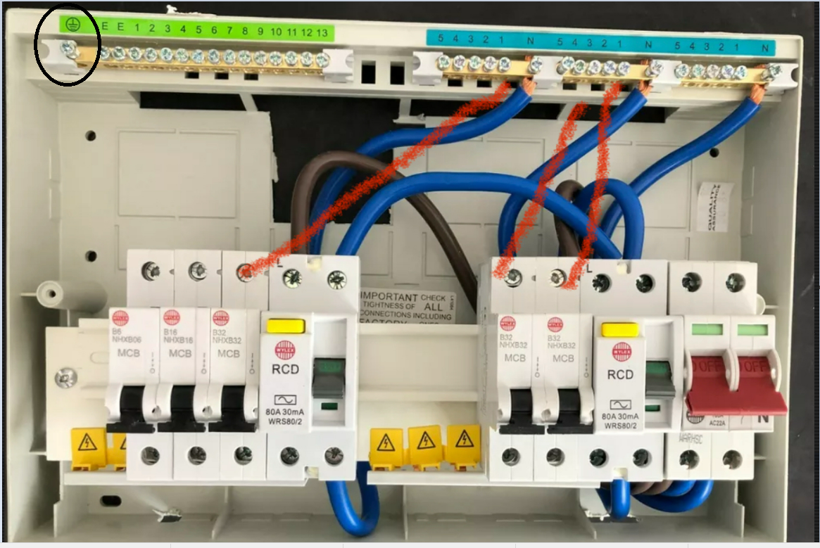

Practicing a Consumer Unit install
Them boards have been around years, even when it was NOT compulsory to rcd virtually everything, so non protected MCBs were often used, maybe freezer sockets or critical circuits possibly Alarms, lighting anything really that you would have preferred not going off.
Nowadays the End Neutral bar would likely more get used for Rcbos, again for things that you want to reduce likelyhood of going off due to non related faults on other circuits.
True high integrity boards now come prepared to fit Rcbos as far as I know, i am not sure how you intend connecting rcbos into that Dual rcb board you have.
Just slide the RCD's across to suit.
What about the Live supply, does the bus bar just bodge in with the two tri rated browns ?, will it fit ? if so not sure he has spare busbar without reducing the Rcd protected ways.
Then again if hes not using the board he may well intend cutting one short
full
Some surgery to (or changes of) busbars would probably then be required, wouldn't it?

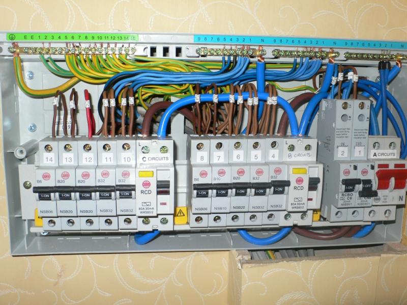

It all looks messy to me, Two 16mm ? browns plus a bus bar into 1 terminal just dont seem right.
These boards look more of a fire risk now than they have ever been
They seem quite typical of many makes to me and it's only one cable and one bussbar.
Is that not the same as the pic of your CU?

Having another look at the pic of you CU the only real difference I see is the flexes into the neutral bars may not be professionally terminated and it makes me wonder if thay are like that all the way through.

For the incoming meter tails (flex cable plugged into a socket in my case), I can see that the L and N go into the main isolator. Does the corresponding CPC go to the terminal circled in black?
Yes earth where black circle.
Note they are type AC RCD's which are not really suitable for supplying multiple circuits, as a fault with one circuit allowing DC could stop the RCD tripping, with a second fault on another circuit.
The use a high integrity CU with RCBO's needs some careful thought, the main items you don't want to trip are lights and refrigeration, for a RCBO only to supply the fridge/freezer great, if it trips clearly a fault with fridge/freezer so you will loose food even if you are fully aware it has tripped, but where it feeds more, as with a kitchen ring final, then you want to know if some thing else causes it to trip.
I have a rechargeable torch plugged in so if the RCBO trips it lights which is likely to alert me rather fast to fact it has tripped, but simply loosing the light on a fridge/freezer you are likely to miss it, son had the house alarm on same circuit and it would beep with loss of power.
The more there is on a RCD the more likely to trip, theory is great, we should test the installation and if the leakage exceeds 9 mA on any RCD (Including RCBO's) we should split the circuit further, however I for one don't have a clamp-on ammeter that will measure 0.001 amp, so only way for me is to use the RCD tester with all MCB's on when doing the ½ test so if an extra 15 mA does not trip it likely less than 9 mA to earth.
