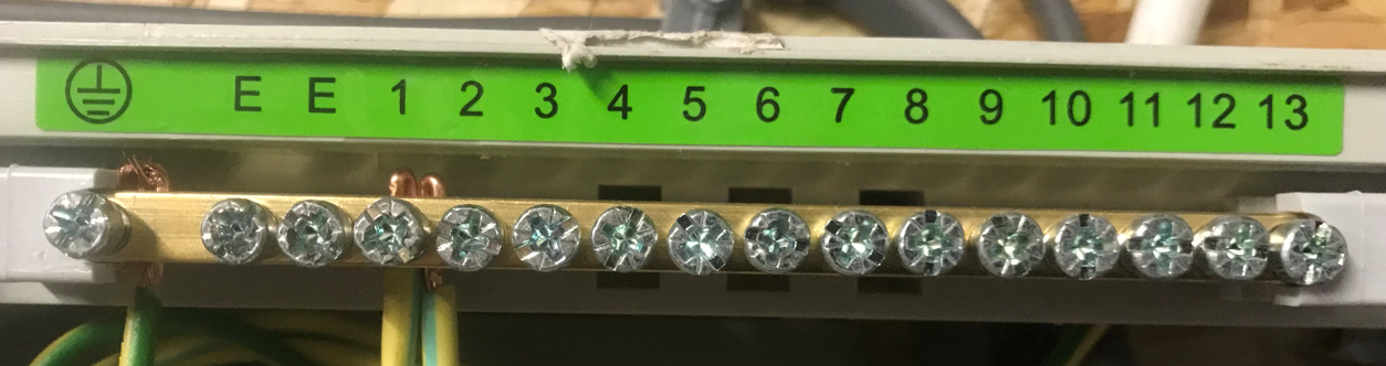

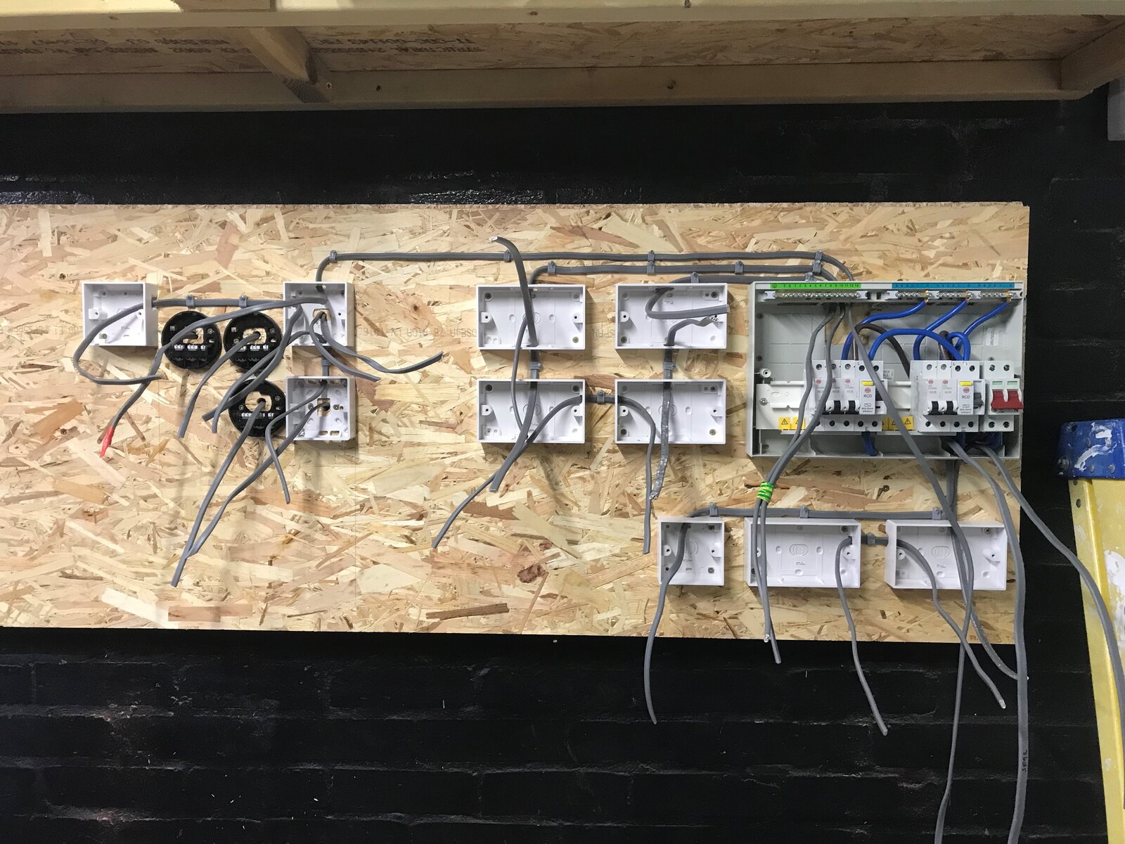

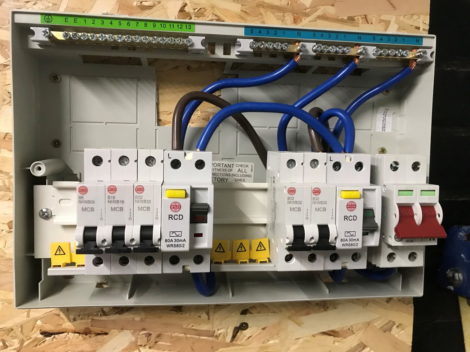

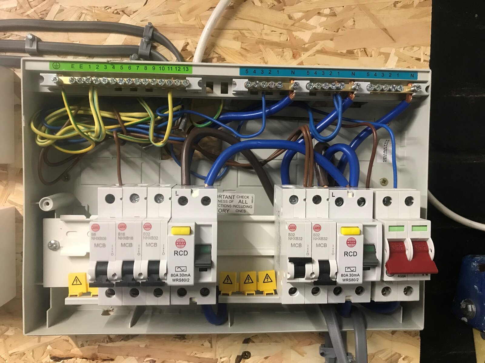

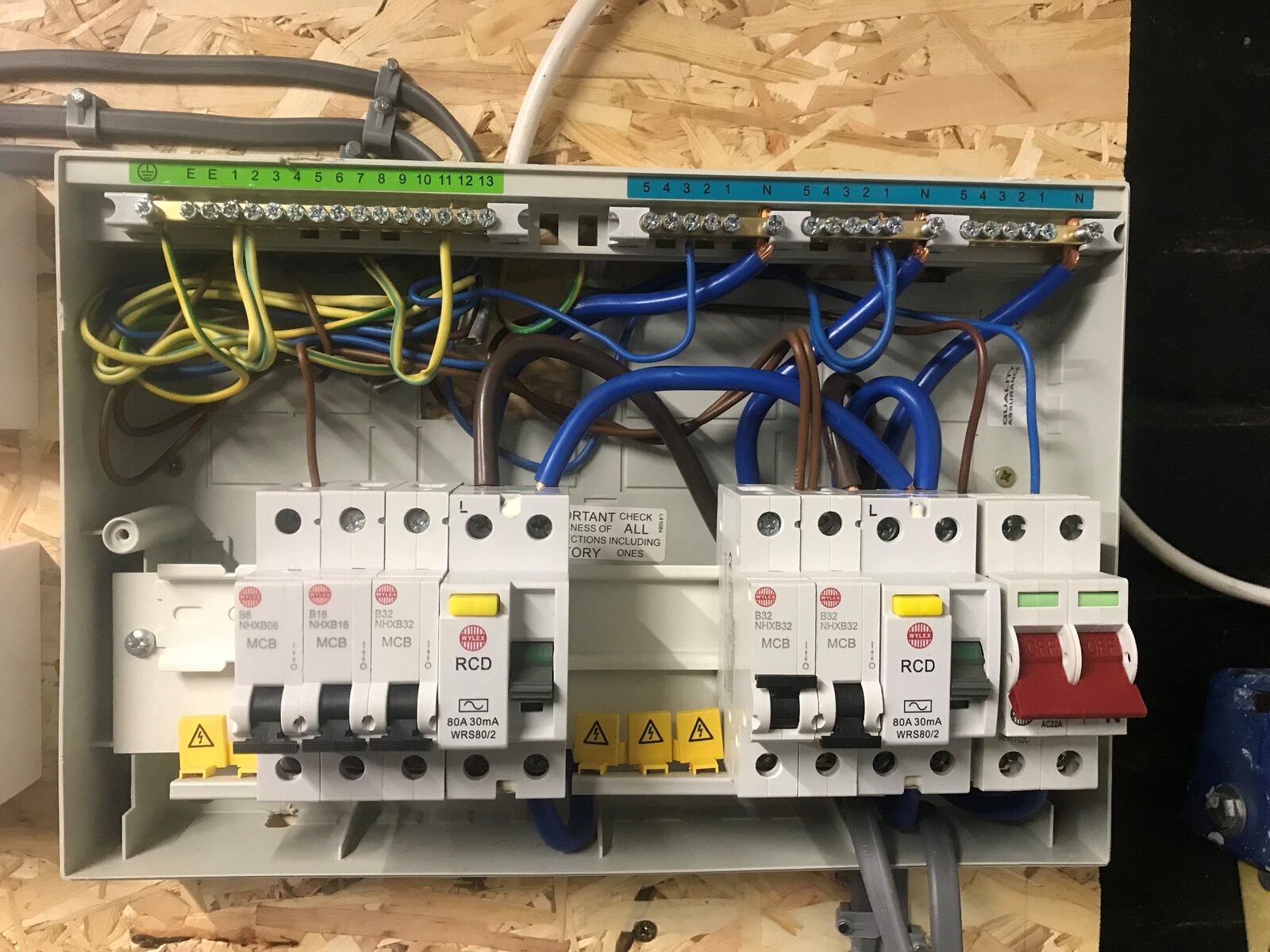

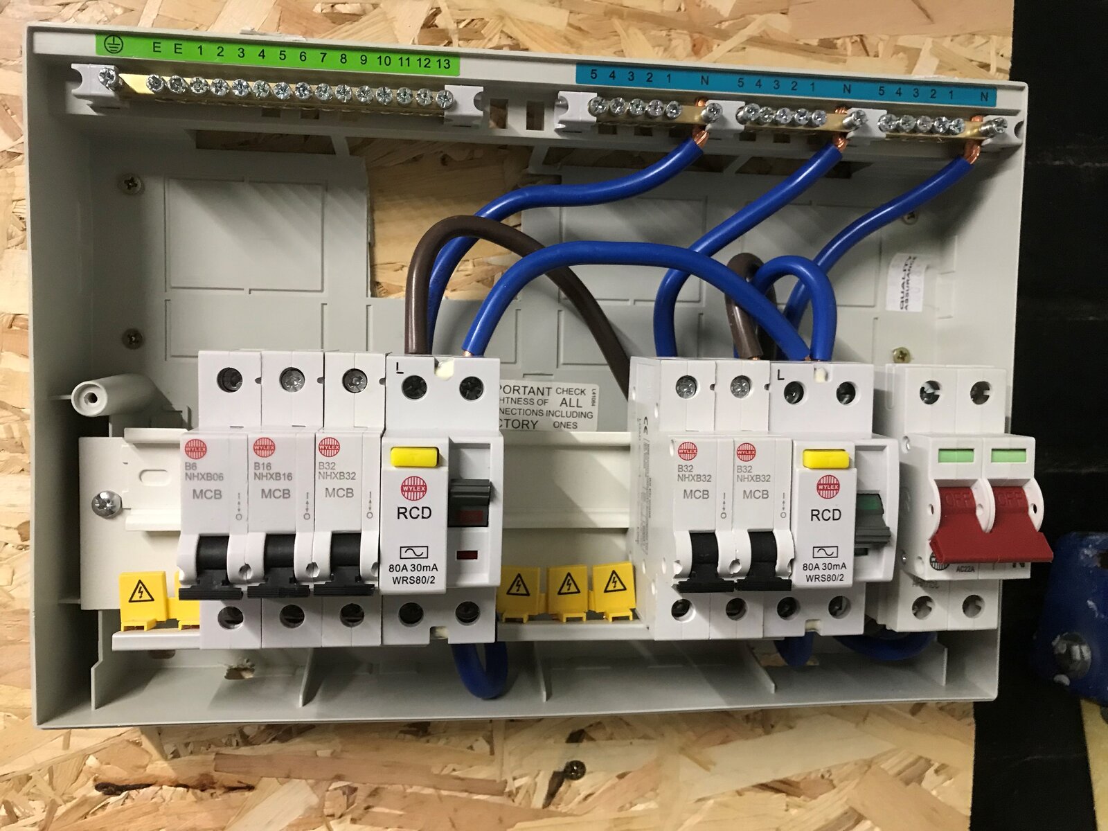

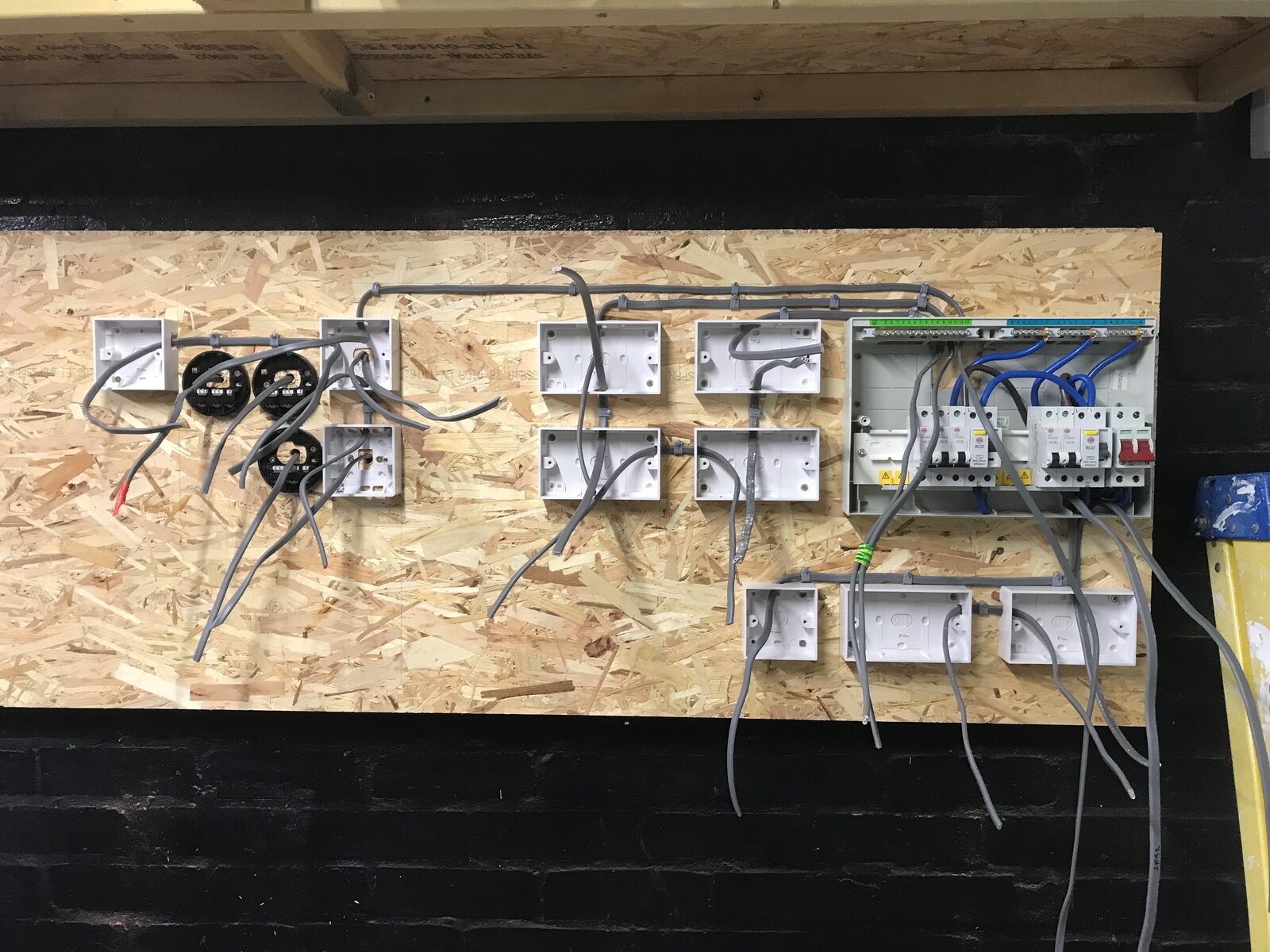

UPDATE: I wanted to share my progress with this first Consumer Unit install (Photos attached). I've got a few more breakers to wire up. Thanks for all the advice and I would welcome your constructive feedback.
I have a few specific questions please:
  • The Neutral terminals are numbered from 1-5 and I can clearly see that there is room for 5 Breakers next to each RCD. Hence, it's clear which cable goes where.
    The Earth terminals don't follow the same numbering scheme and this is causing me some confusion. They range from 1-13 and it's unclear on which breaker goes where
  • I was struggling with the length of cables and how much I should retain. I tucked the excess cable in the corner of the CU but was unsure on whether this is the right thing to do.
  • Finally, should the wire for N and E poke out of the top of the terminal as shown in the above image?
Thanks again.

Can I get your view on the above questions please. I’ve not wired in the remaining MCB’s until I have this clarification.
Thanks for your support.
The Neutral terminals are numbered from 1-5 and I can clearly see that there is room for 5 Breakers next to each RCD. Hence, it's clear which cable goes where.The Earth terminals don't follow the same numbering scheme and this is causing me some confusion. They range from 1-13 and it's unclear on which breaker goes where
You can buy new stickers or just make your own and number them however you want.
Well, there is no 'right' - just tidiness by cutting the wires to appropriate lengths. You get used to it.
I think it turns out better (like junction boxes and ceiling rose) if you connect all the CPS first, tuck out of the way, then the neutrals then the lines.
Not sure it matters as long as there isn't miles of bare cable beneath.
Can I get your view on the above questions please. I’ve not wired in the remaining MCB’s until I have this clarification. Thanks for your support.
Since you're anxious for responses, for starters, and for what it's worth, these asre the thoughts of a non-electrician ...
The Neutral terminals are numbered from 1-5 and I can clearly see that there is room for 5 Breakers next to each RCD. Hence, it's clear which cable goes where. ... The Earth terminals don't follow the same numbering scheme and this is causing me some confusion. They range from 1-13 and it's unclear on which breaker goes where ...
I would just (probably just 'mentally') count/number all of the devices which supply circuits (i.e. MCBs/RCBOs, not RCDs or Main Switch) from left to right, and then use the corresponding earth bar terminals with the corresponding numbers.
... I was struggling with the length of cables and how much I should retain. I tucked the excess cable in the corner of the CU but was unsure on whether this is the right thing to do.
The neatest solution is to use the minimum length possible, and some professionals take pride in the neatness that results in, but that can become a nuisance if/when one subsequently wants to change anything. I personally therefore tend to be very generous in how much 'slack' I leave, which means that my CUs end up looking anything but neat. Somewhere there is probably a sensible middle-ground compromise, and I don't think there is any 'right or wrong'.
... Finally, should the wire for N and E poke out of the top of the terminal as shown in the above image?
Others will probably disagree, but I personally like the 'reassurance' of seeing a little of the conductor 'poking through'. I can't see any downside of doing that for the earth bar in any sort of CU, but I'd be a bit more hesitant to do it with the neutrals in a metal CU. I suspect views about this will vary.
Hope that may give a little help.
Kind Regards, John

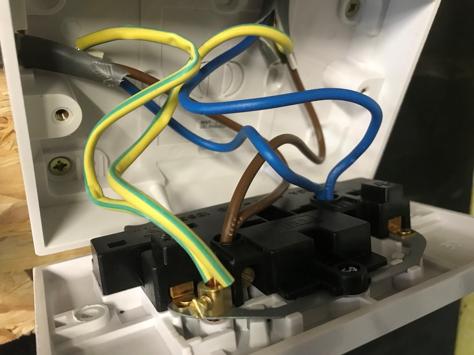

The brown in Mcb 1 looks like it has a tight loop in it, that should be avoided and your technique for stripping the sheath in the sockets needs slight improvement.
The cables will protrude through the earth terminals, that is good as you can see there in, its likely plastic above and not an issue and better than exposed copper on show beneath in my opinion
