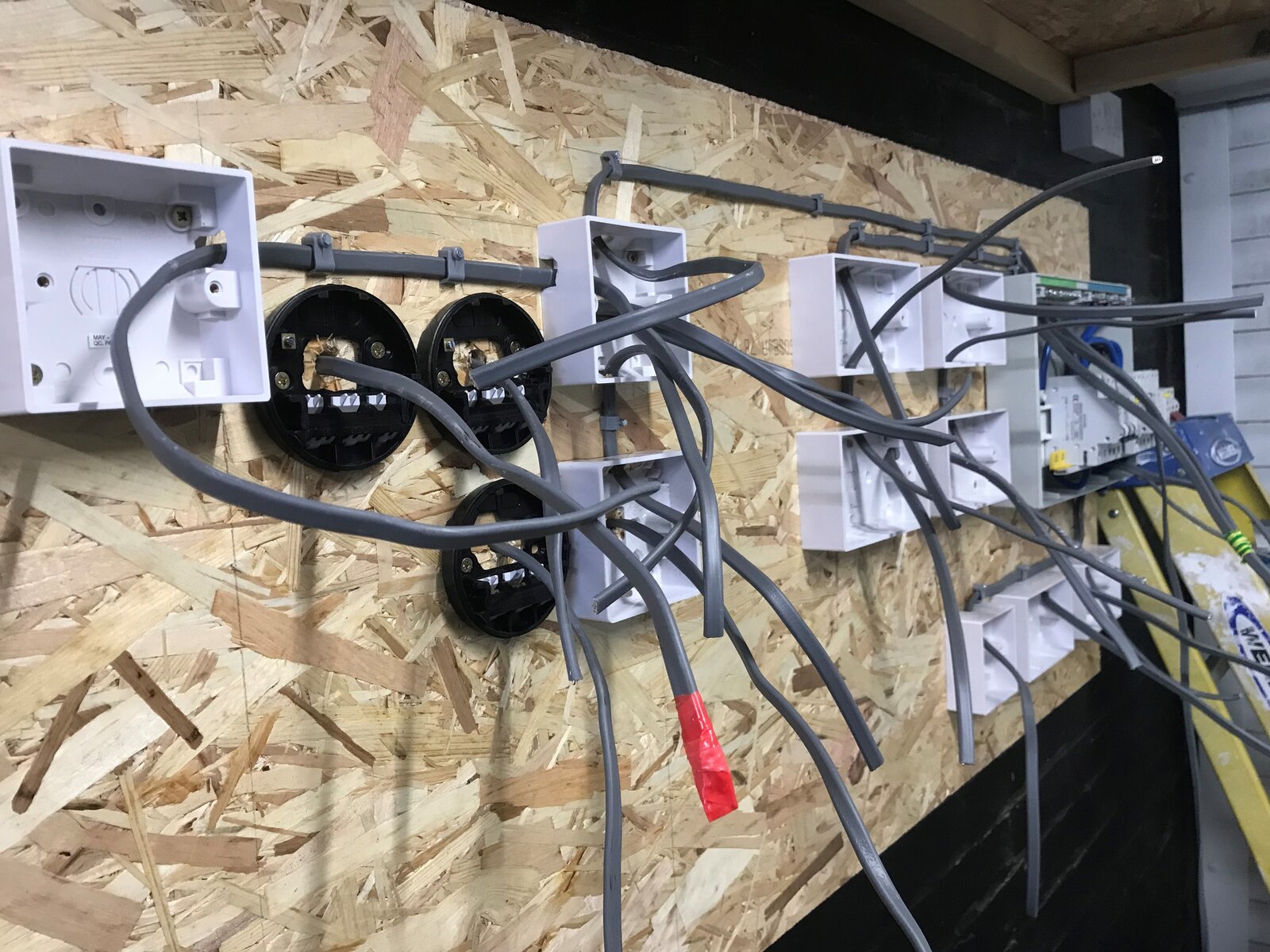

No. Happy to get if it will make sense to a DIY'er...
I am definitely not a professional electrician.
As per earlier posts (includes pics), I have set up a consumer unit with: ring, lighting, radial, cooker switch. Trying to simulate house electrics. It is fed from a 13amp plug.
I own a number of electricians tools: 2 pole tester, VDE pliers and screwdrivers, voltage stick (!), etc.
back in the day Ban All Sheds used to post a library of publications and advise the poster to read them before undertaking electrical work. Before he left us, he posted this to just about everybody. In your case, he would have been right to advise you to read up. I did see JohnW2 advise you read up in RCDs. That is the top of what you need to read up on. I don't understand people telling you how to reconfigure your CU when you are so far from ready to work in a CU. I was stunned to see your photo of your shiny new CU, live with the front panel off and nobody picked you up on this. Asking random questions in this and possibly other forums is not a way to learn. You should invest in a text book (look at Basic Electrical Work by Trevor Linsley). You need to understand basic theory, focus on live proving and testing as this will at least teach you about safety.

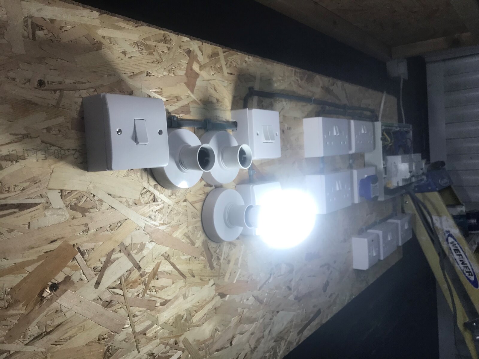

Where did you see the photo, the Op stated the cu is a mock up on a sheet of board and the only supply is via a 13amp plugtop which we all assume is unplugged at the time
20220429_120407742_ios-2-jpg.268515
On page 5 in post #69. The last photo seems to show a lamp and LAP socket tester illuminated while the cover is off the CU. I am on a tablet, so not the largest image and I'm happy to stand corrected.
I totally agree with you SS and similar has been said, however if you have been following J1's posts itcan be seen this is one of those situations where 'it's going to happen anyway' so our best thing is to help rather than say 'don't'.
I have not said don't (as BAS used to say) just get to understand the basics to stay safe. After all, we all know what happens when you don't respect the dangers when facing electricity.
Hi @scousespark, let me firstly state that I am grateful for the advice that you and others have provided over the years. I wanted to dispel this impression that I may be some bumbling bafoon that has no regard for safety. Quite the opposite. I am diligent in my safe isolation and ensuring that I have the correct equipment. I have now done a substantial amount with electrics over the years and have felt increasingly confident - but not complacent - as I have progressed. Again, thanks to a huge amount that I have picked up on here.
I am also one to research extensively. Often what I post or receive on here will be triangulated with other research and I will then subject it to my only experimentation - with safety at the forefront of course. The Consumer Unit is one such example. I didn't want to delve into my own consumer unit and hence set up this test rig which has really cemented my understanding. The open CU picture you referred to, allowed me to see where we have live parts in the CU, which is something I set out to understand.

This is the photo I was referring to. The socket tester may not be lit up. It certainly seems to be a live installation from this photo.
