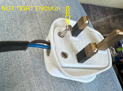

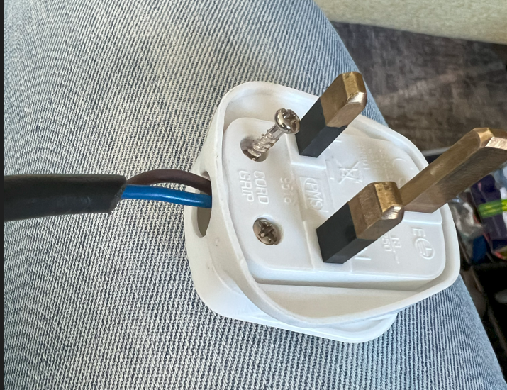

When using the hoover, often the cable is fully unwound and when we then drag the hoover beyond this point, it pulls the cable at the plug. Over time, this results in the outer sheathing slipping through the plastic retainer inside the plug and the single insulated copper becoming visible. Eventually, it leads to the L/N disconnecting within the terminals.
I've now had this happen twice, despite tightening the plastic restraining clamp in the plug as best as I can.
Evidently, it doesn't take much for us to end up in this situation. Is there a type of plug or technique I can use to avoid this?
Thanks in advance.
I would buy a new plug , if the screw is not holding any longer - its only screwed into plastic cover
also the outer insulation should be inside the plug itself , i'm surprised the cable comes out of the screw terminals - must be tugged really hard
the single cables should be shortened - so they cannot come out of the plug and still be connected to the pins, thats not correctly wired in my opinion

If you can't get a good grip on the flex with the cord grip because it's too small, "shim" the flex with something so that it fits tighter, eg a few turns of PVC tape. Self-amalgamating tape is handy for this sort of thing as it is very thick.
Or maybe the cord grip is the wrong way up.
Which part of the cable are you using the cable clamp on?
Are you clamping onto the black outer sheath, or onto the blue and brown cables?

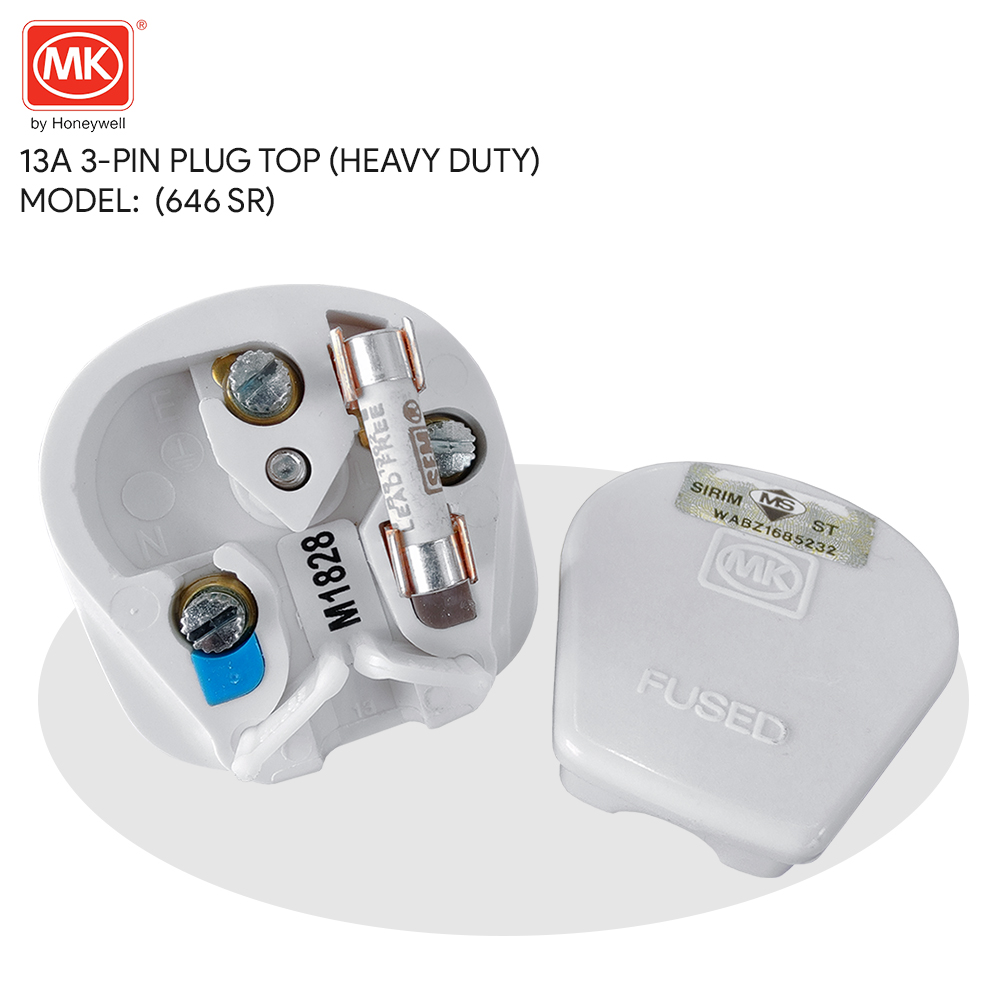

MK plugs have plastic slide-in cord grips...
But the cable really shouldn't be able to come out of the screw down clip in your plug, as long as it is undamaged and properly tightened.
Can you show us a pic of how it is wired inside?

That's a very good point with 2 core flex. Flat 2 core can be pulled through the MK type cord grip, if the plug has been used previously with thicker cable.
a screw down cord grip can also bite through the outer sheath of thin cables, if overtightened.
in this case though, vacuum cleaners usually have a heavy duty, round two core cable, there really shouldn't be any need to shim the flex - the cord grip should grip it! :)
I'd second the recommendation of @RandomGrinch to use an MK plug with a V type push-in cable grip on that particular vacuum cleaner cable and to trim the brown/blue cables to a minimum needed.
Throw that old plug away it's likely tightening has stripped the thread in the nylon 'strain relief'?
Those MK plugs are particularly good in that respect, but it's good practice to ensure the live wire inside the plug is always the shortest, so it disconnects the live first, then the slightly longer neutral, finally the longest the earth wire (if there is one).
