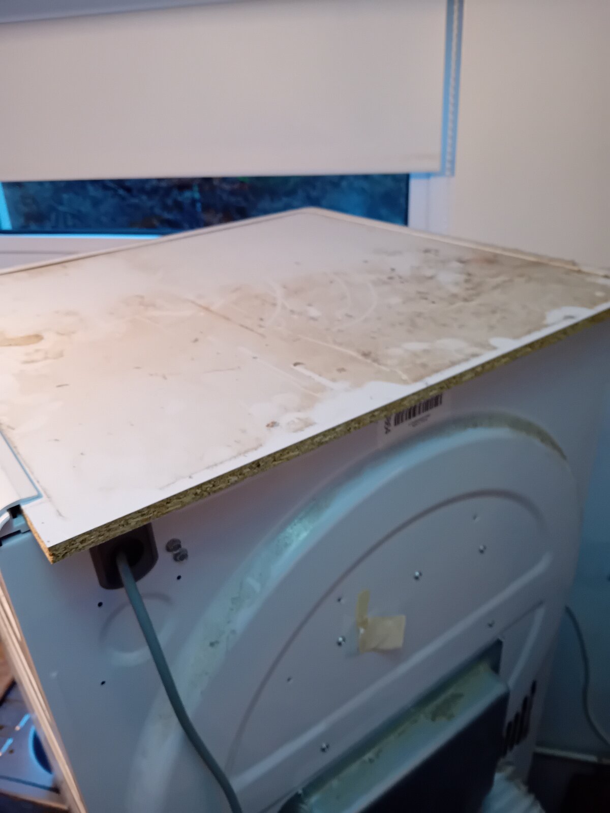

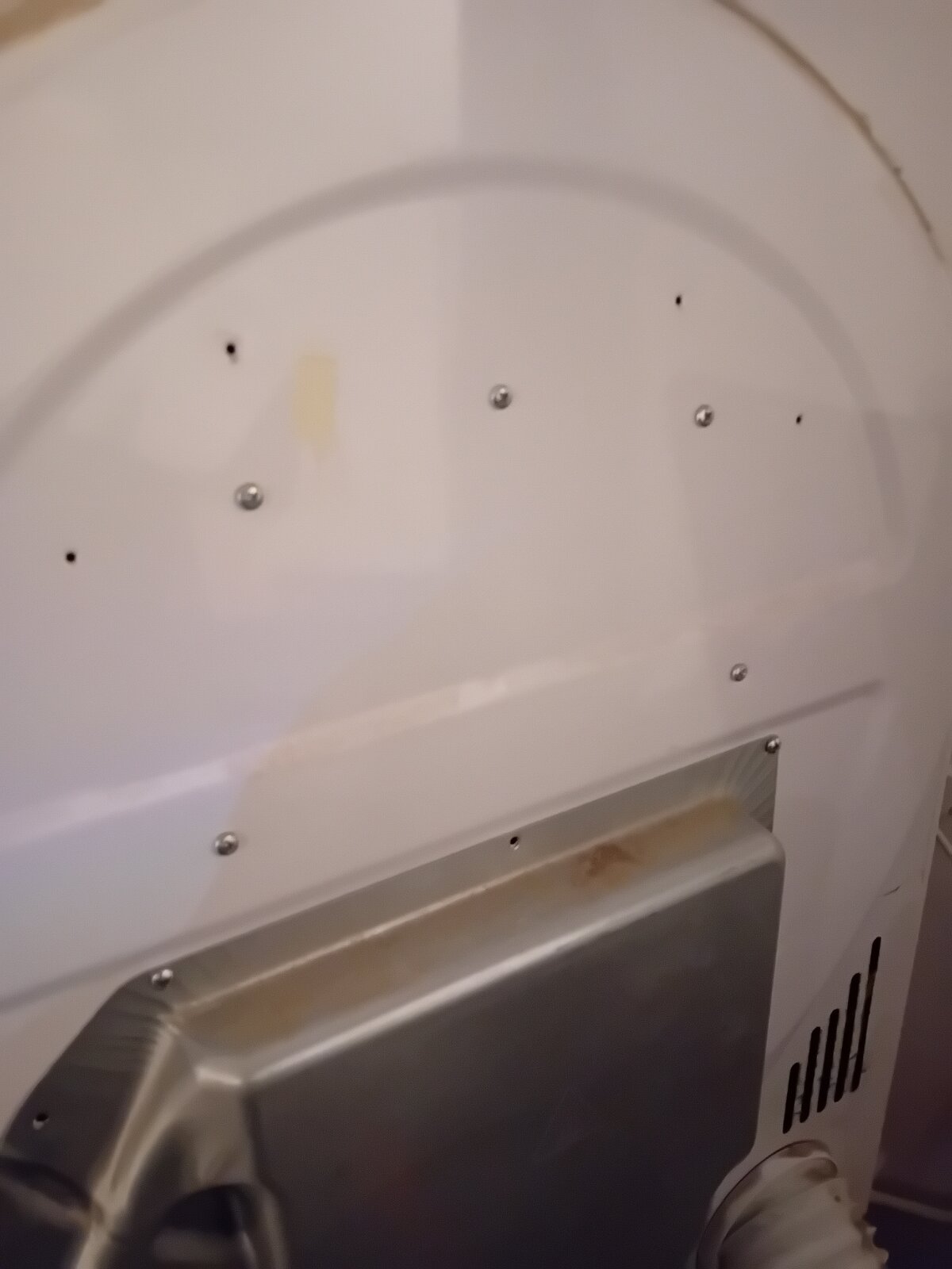

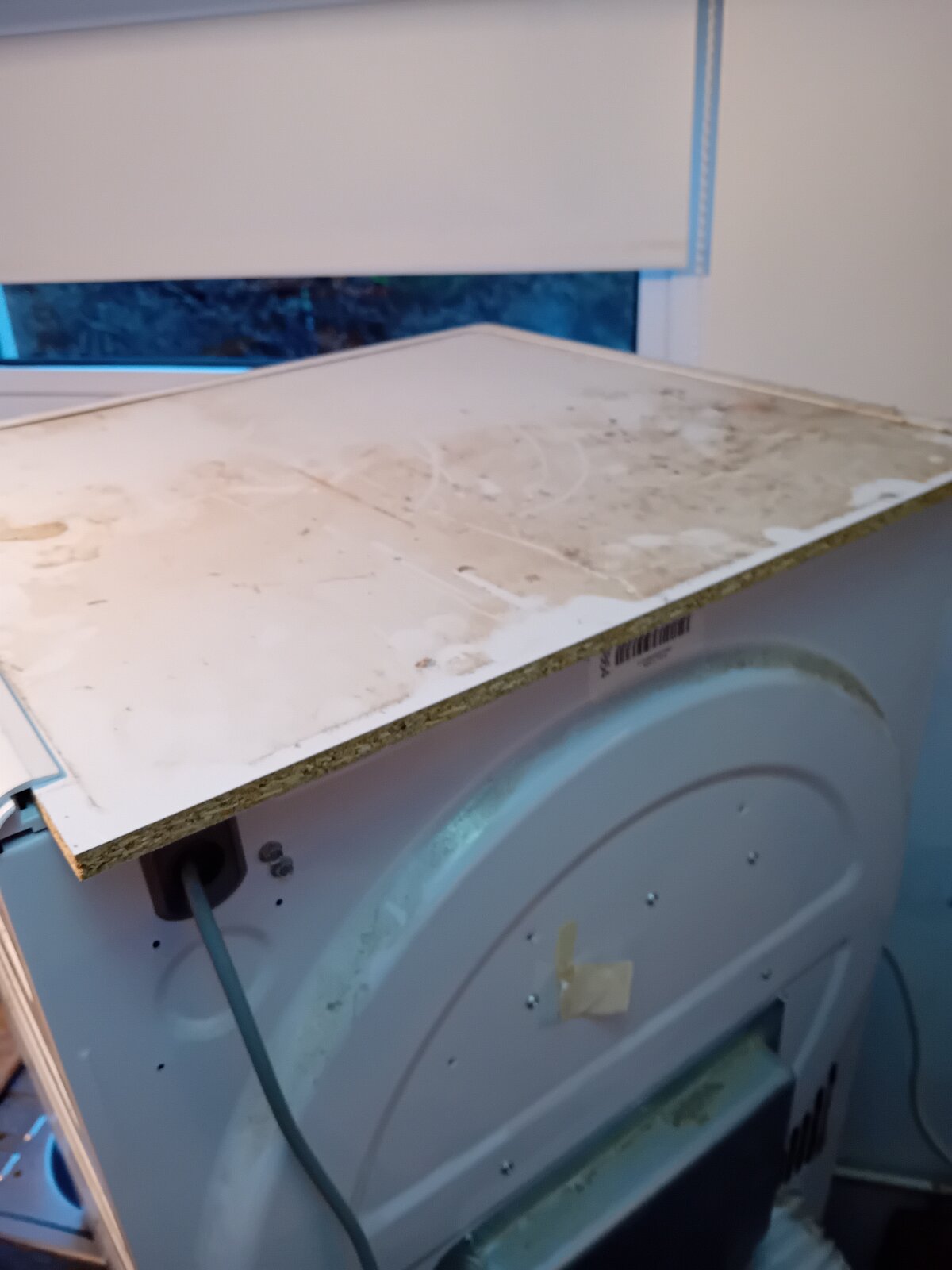

I have had the front plate off, cant see any issues, on closer inspection i think something has indeed fell throught the holes at the back and is wedged between th back drum and back housing panel, cant see anything but noise defo emanatingfrom there, is ther anyway to access that part, tried to get the top off and stupidly used my hand on a sharp edge instead of a hammer to loosen, ive just finished clearing up the blood ffs
Thats the top as it stands

Any movement in rear of drum ?

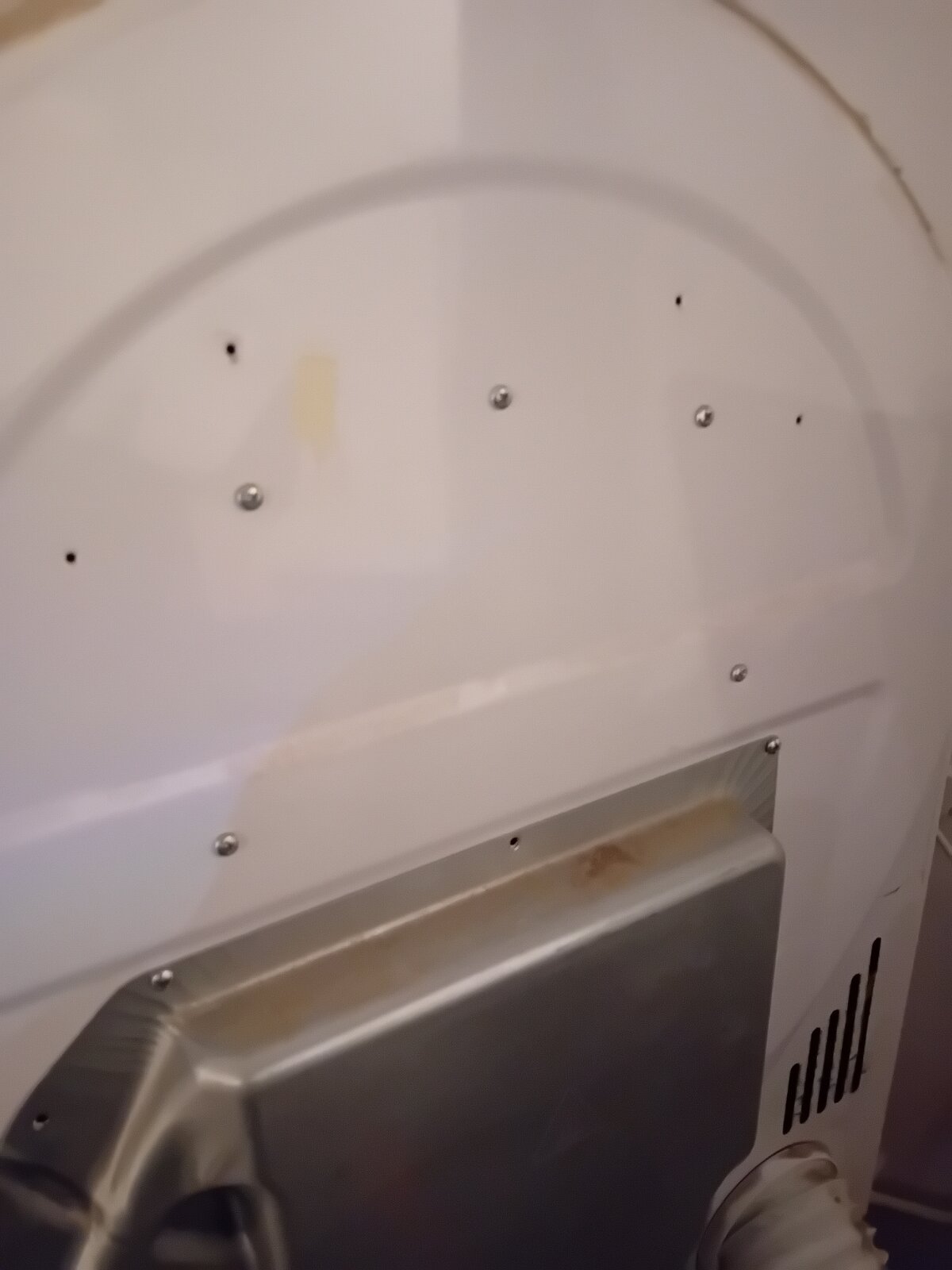

None whatsover, took the back cover and element off, but cant really feel anything much, not that i can reach in too far, i take it i cant access the back of the outside of the drum entirely, does undoin the 5 screws above the element help or is that a no no!

Not sure what i did, but i went inside the hole where the element sits again and used a long thin piece of threaded rod, got in anywhere i could and i mustve dislodged it, a victory even if it cost me blood, thanks for all the repies folks
