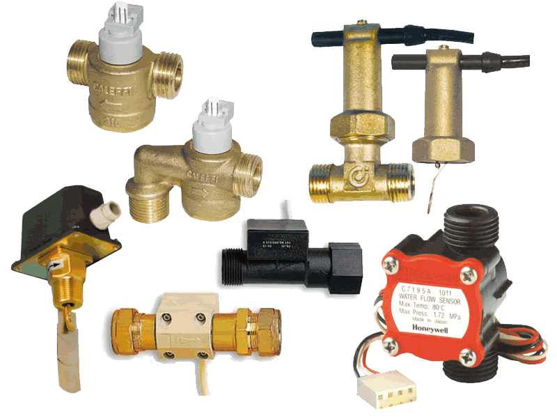

I'm looking for a flow sensor switch to operate when water flows.
I'm kinda thinking a combi boiler spare part will do the job, only which boiler's spare?
Ideally.... fitting 22mm, horizontal operation or downflow [sprung?], 240v on/off as opposed to flow rate feeding a circuit board...
The application is to start an extractor fan when water is supplied to a shower.

There are many flow sensors from general electronics equipment sort of companies like rswww, Farnell, and others. And every shower pump has one... What flow rate do you want it to switch at?
Here's a few...

Yes, Chris but all those are 15 mm!

I think I have seen Chris's pictured Honeywell one inside a dreaded Glow-worm boiler!

Not exactly. The one bottom left can be used with pipes up to 8 inch, the one to its right is 22mm, etc.
