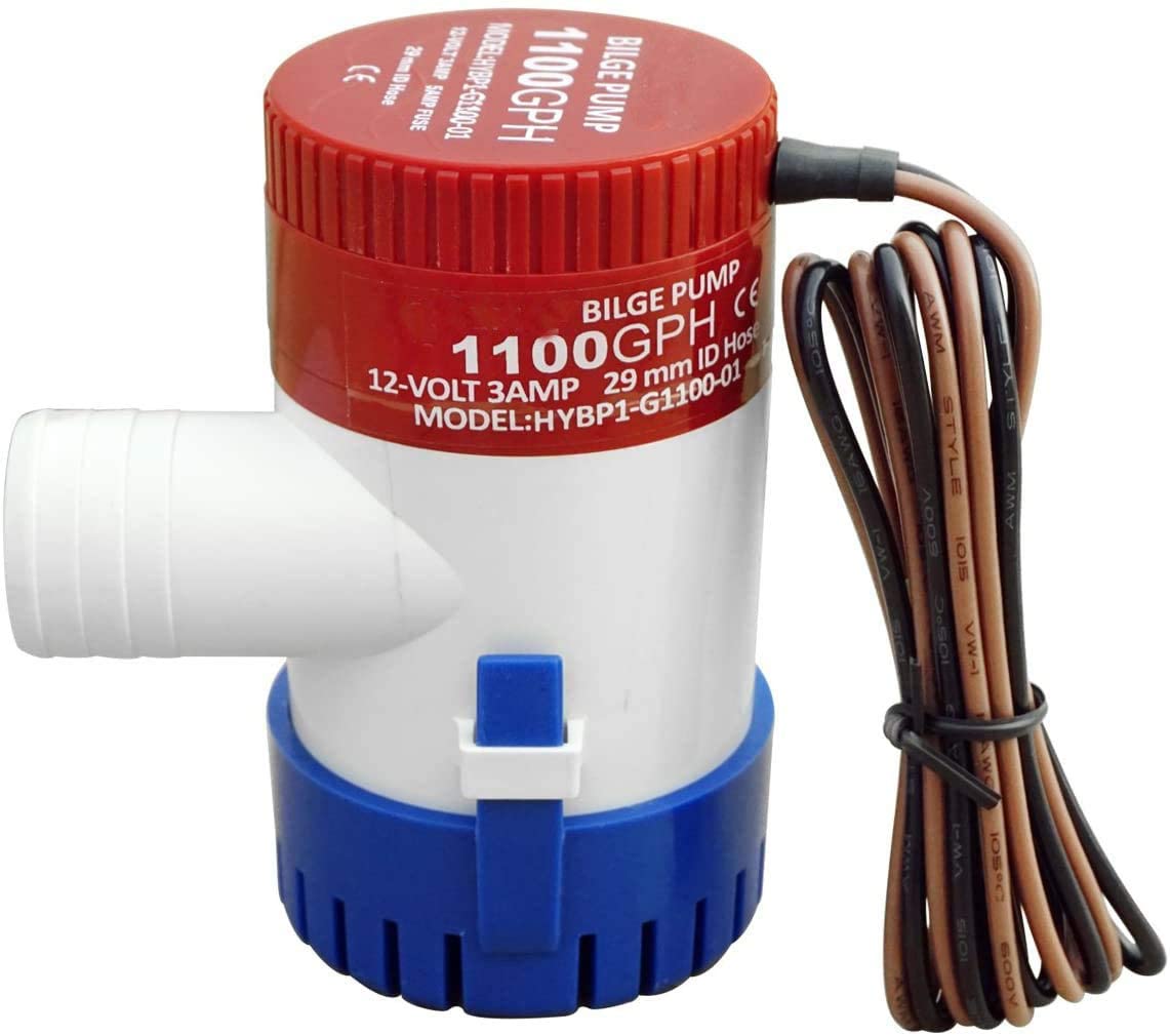

Theoretically you could do it, and have a concealed lid operated by a gas strut. But you still have the problem of how to empty it. You would need some form of drainage system to empty it and this would need to be below the tub. I suppose you could pump it out but this would still need a lot of planning to get the right type of pump.
Thanks, I was thinking of running a conventional waste to a sump made of a 110 soil pipe, capped and deeper than the tub, then lower a submersible pump to pump it out to the foul drain.
Just wondering if anyone else has done this before.
My hot tub uses the main pump to empty it. For corners that don't drain completely and kids paddling pools I use a tiny boat sump pump to shift water.[would fit in you tea mug] pu.jpg
