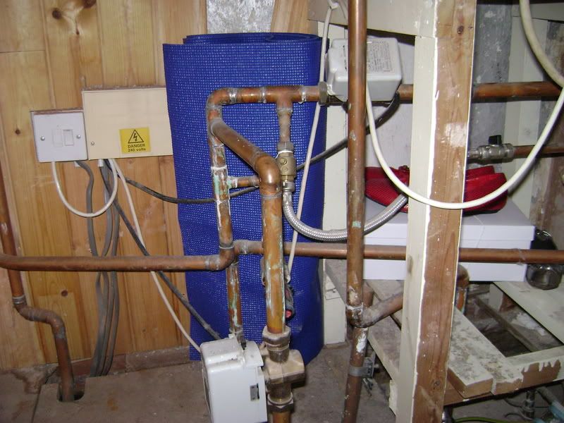

Gut feeling says this one radiator has been plumbed as a bypass, and that the system is wired wrongly so instead of being interlocked with the two-port valves it's cycling on the boiler stat.
As someone else mentioned, the heat must be coming from somewhere, this will be either the boiler or the hot water cylinder, barring something really bizarre like a towel rail element in the bottom of the radiator.
I'd suggest finding a way of making sure that the boiler cannot fire - isolating the electric supply or putting pilot light out etc (I don't know this model of boiler). Leave it a couple of hours without power and if the rad is still hot then the heat is definitely coming from the hot water cylinder.

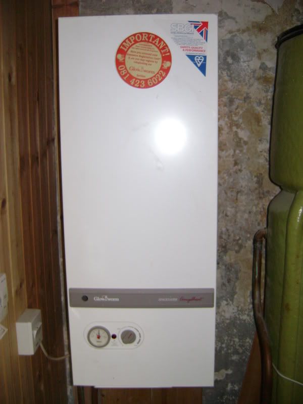

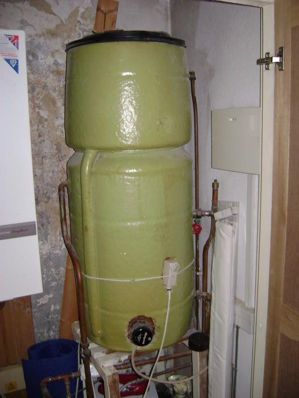

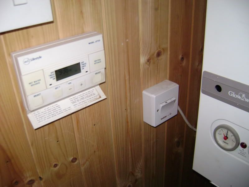

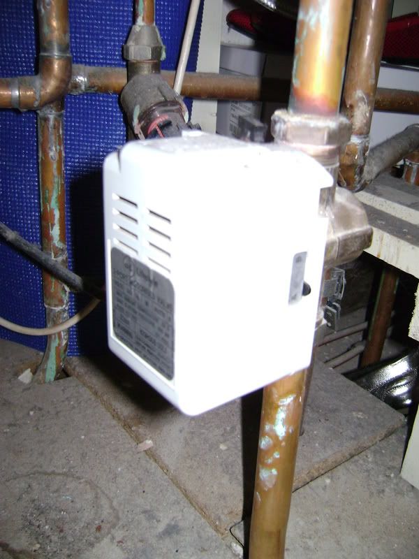

ok, got some pics. 'scuse the mess...
first the boiler -
then the hot water cylinder -
the timer and isolator switch -
pipes and gubbins -
first motorised valve -
second motorised valve -

we turned the isolator off last night and the radiator is off. so presumably that means that the boiler must be firing itself up generally, doesn't it?
Could you be specific about which isolator?
Also, it's best to assume and presume absolutely nothing.

Is your boiler within the living space, or outside?
If outside, do you know whether or not there is a frost stat?
If there is no frost stat, and if your boiler is firing without any demand for heat via programmer and thermostat(s), then there is a wiring error or fault.
Has the system always behaved like this, or just started doing it?
respectfully softus, if i don't assume the boiler's firing up the how else is water getting hot?
isolator which shuts down the heating/water system.
boiler is inside the living space.

Would suspect dhw zone valve sticking and c/h zone valve partially letting bye heating nearest rad imho
