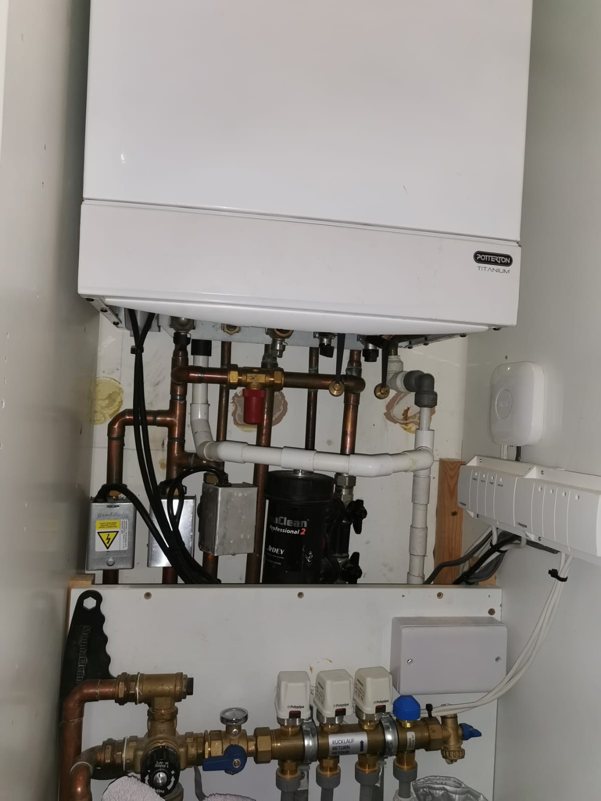

We have a Potterton Titanium Combi Gas Boiler which was setup with the wireless Nest Thermostat last year to provide heat to our radiators, heat up our unvented indirect cylinder to provide us hot water and to heat up our under floor heating in our kitchen.
There is also one tap in the house that is used to provide hot water directly from the gas boiler instead of the cylinder - Something to do with making sure the 'diverter valve' does not fail and has regular use.

Attaching a pic of the boiler in hope it explains the setup better

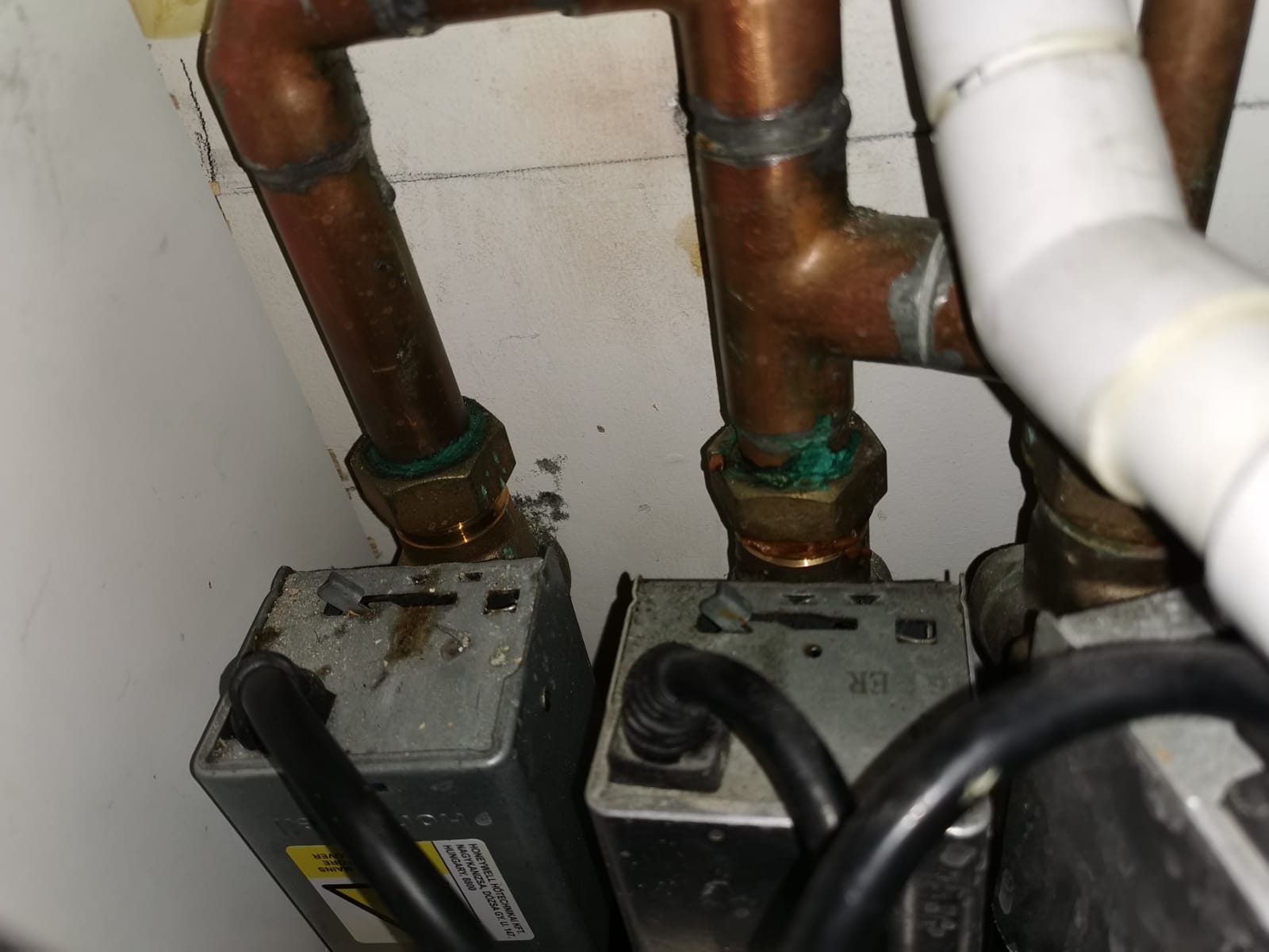

I have attempted to manual turn on the diverter valves as advised on some other threads with no joy (pics attached).

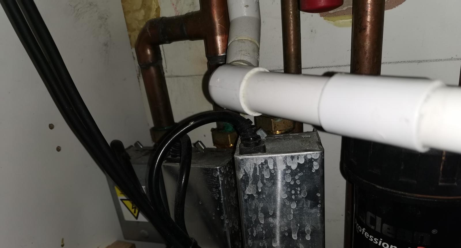

The Nest will open up the motorised valves below as required.
...but it is the motorised valves that are actually responsible for starting the boiler [they have a switch inside that operates when the valve is open] When the Nest switches the heating on it will open the heating valve. Is it doing this? Normally, to check; when the heating is set to be 'on' slide the lever on the side of the valve towards manual. If it's loose and floppy the valve is open, if you feel resistance it's closed.

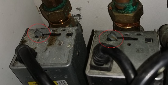

However, looking at yours they seem to have been fixed manually open, so their operation will be overridden. Do you know why? Have you just done this?

Also there are 3. But you only have one Nest Heat link, which can control two motorised valves (one heating zone and hot water) is something else controlling the third?
When they are in auto (and not locked manually open) If the valve isn't opening, then either the valve has failed or the Nest isn't turning it on. Have you tried operating the Heat link manually by pressing the centre button? The green waves should light up and the heating come on after a few seconds when you do.

when you manually open the zone valves that you have, they will not bring the boiler on, the manually open setting is for filling the system , it will not bring the end switch on

Condensate dripping on the motorised valves won't have done them any good either, that white plastic is a disgrace (not to mention running uphill)
Using the manual latches on the valves might help you depending on how the system is set up. Do you know which valve does what- a guess would be downstairs heat, upstairs heat and hot water cylinder but it is just a guess. If you can get the boiler to fire up in heat mode (by turning the cylinder thermostat up) you will get circulation through the latched open valves which will tide you over til Monday.There are other options but all require a multimeter and some electrical knowledge

Yes, Heat Team will have a good laugh when they see this setup and are told boiler is faulty. Mind, nothing wrong with the setup, poor quality workmanship is what I see.
That bypass reminds me of drivers with Chelsea tractors parking in supermarket carparks as close to the store entrance as possible.

It turned out to be a faulty zone valve (far right).
The two on the left (underfloor and cylinder) I put back to auto and far right zone valve I put on manual override.
When getting the underfloor heating to come on or/and heating up the cylinder, the rads now heat up as well.

That condensate pipe needs redoing as a matter of urgency, you don't want a repeat never mind damaging anything else below the boiler.

Do note however that yours looks to have had a leak from above dripping into it which is a suspect in its failure, replacement could go same route if water ingress persists.

Take it the installation is quite old then (or you don't want them back in the house). That condensate pipe needs sorting.....
