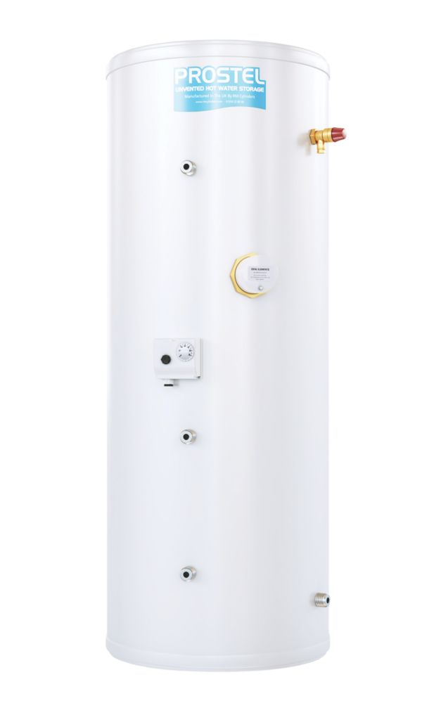

I expect you have a hot water cylinder.
It stores water, which the boiler heats up during the "HW on" period.
You can then use it from the hot taps until it is all used up.
The size of the cylinder determines how much there is, and your usage determines when it runs out.
40082_P
30112_P

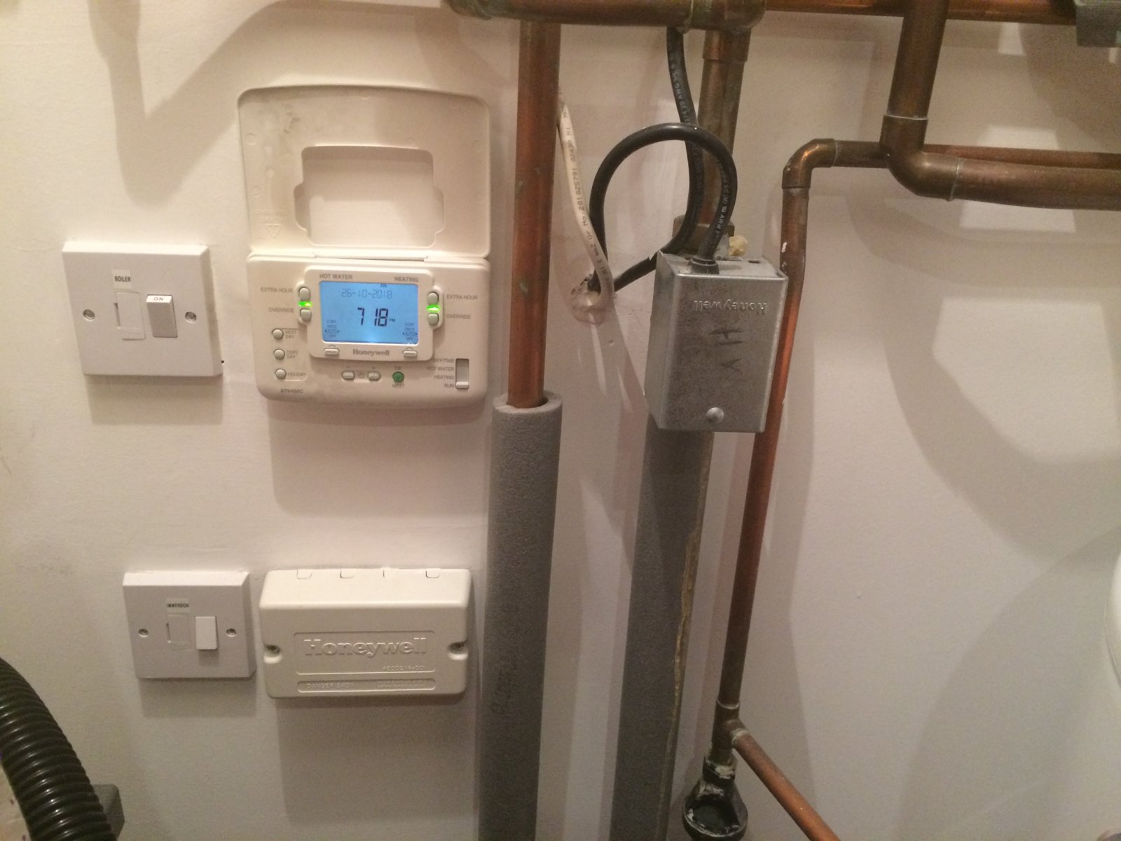

please post a photo of yours, including the pipes, cables and devicesaround it. And of the timer and the immersion switch.
Looking at your Actual gas and electricity meter readings (not estimates) what were they when you moved in, and what were they when you checked them?
Thanks for replying JohnD

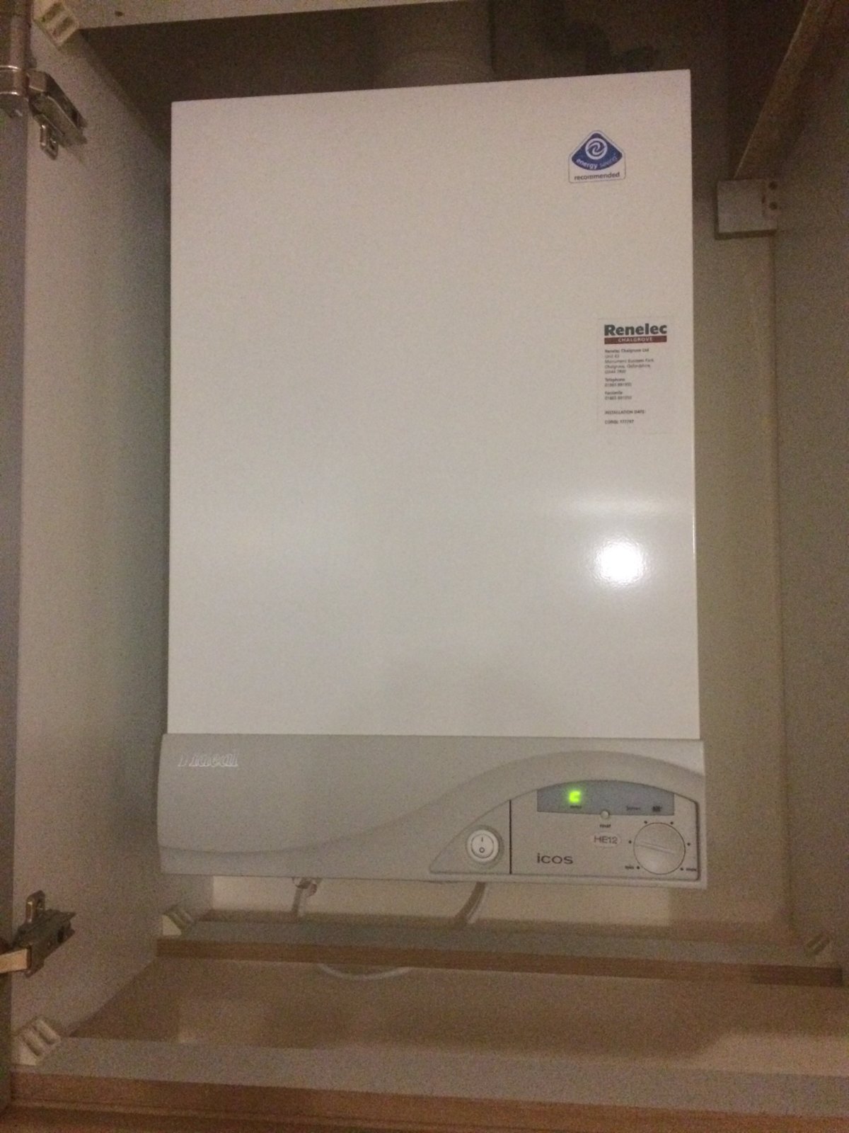

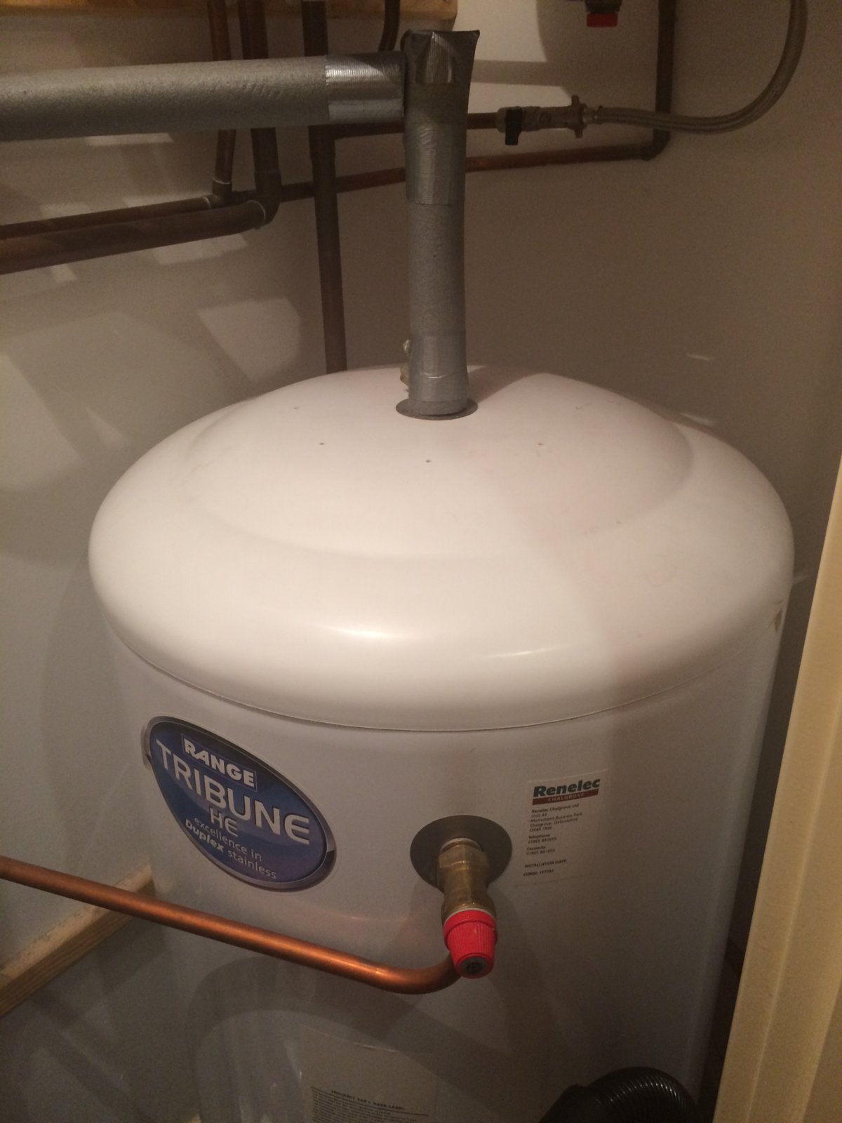

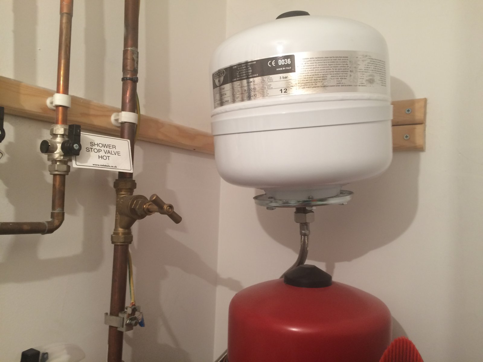

There's no timer on the boiler. The immersion switch is to the left and below the controller. (first pic)
The boiler is in the kitchen (last pic) while the rest of the system is in the utility room.

your usage of 30 cubic metres of gas in a month would be plenty to heat a HW cylinder in summer (at that time of year you would not have been using the central heating)
You were using 8kWh of electricity per day, which is not much so I don't believe the immersion heater will have been running.
So I expect your boiler has been heating the cylinder.
Did you never hear it start up?
The Honeywell ST9400C is a timer (programmer) that controls the boiler "on" periods.
Yes I have noticed the a louder hum from the boiler after the hot water taps have run, so I assume it has been starting up . What I don't understand is what's triggering it. The hot water and heating on the programmer were turned off till today, so wouldn't that mean that the boiler should not have come on ? Or does the boiler keep the water at a certain temperature, in which case, does the hot water program on the controller serve any purpose ?
Either the timer was "HW on", or is faulty, or there is some other control. It might have been incorrectly wired if it was done by an unskilled person. The Honeywell control is a good one and unlikely to go wrong.
