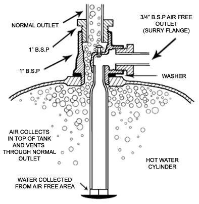

no good when the shower is running it will allow air released from the cylinder to be pulled in to the shower pipe and get trapped.
so restricting flow or stopping it.
