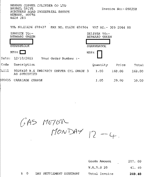

And how much was this contraption?
I've just had a cylinder made to order and even an extra immersion tapping and side tapping for a shower added significantly to the cost.
The cylinder delivered was under £200.

It's not a fact until you produce the invoice
Ooops it was more than £200. £207.
I've shown you mine, how much was yours ?
But that is a tiny cylinder too.
With hindsight and three people having showers a larger cylinder would have been better, Also I did overlook the amount of copper inside the tank did mean there was less volume of hot water to store the heat. It could be replaced. There is 2 foot of free space above it and the floor will take the extra weight.
